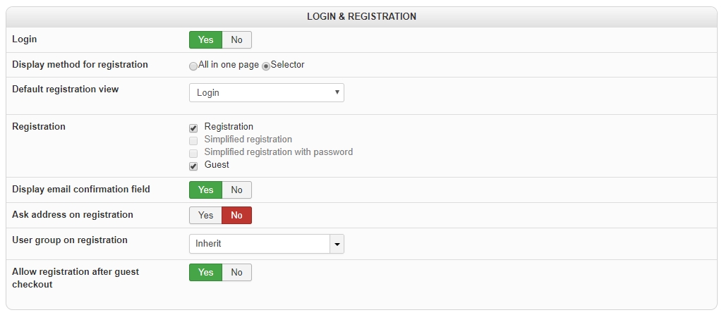

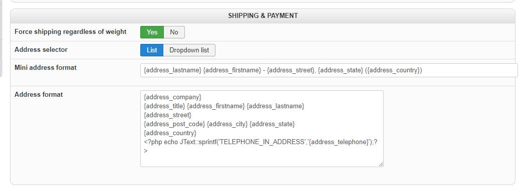

2. I no longer see the option to select same billing and shipping address. I've re-checked my configuration settings and don't think I've changed anything yet cannot see the checkbox option to enable customers to select same billing and shipping address. Please advise how I turn this option back on.
I attach a screenshot below showing my config settings.
