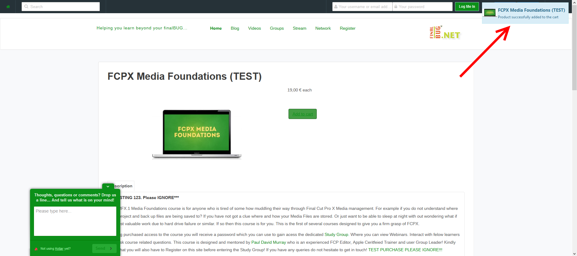

8 years 10 months ago #275438
I had a quick look and all seems to be working fine, even in IE, see attached screenshots.

  • Posts: 26355
  • Thank you received: 4068
8 years 10 months ago #275423
You got the "cartnotify" plugin which is displaying a tooltip on the top-right corner.
So the customer is not redirected to the checkout.
You need to configure the plugin or just unpublish it.
See : www.hikashop.com/home/blog/367-hikashop-3-0-out.html#cart

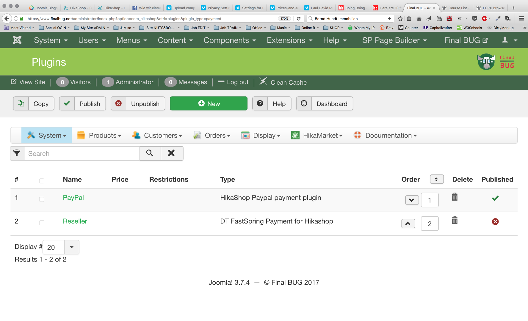

  • Posts: 139
  • Thank you received: 10
8 years 10 months ago #275512
Hi Jerome
Under System>Payment Metohds I have the following active: HikaShop Paypal payment plugin
And also have this but it is not active: DT FastSpring Payment for Hikashop

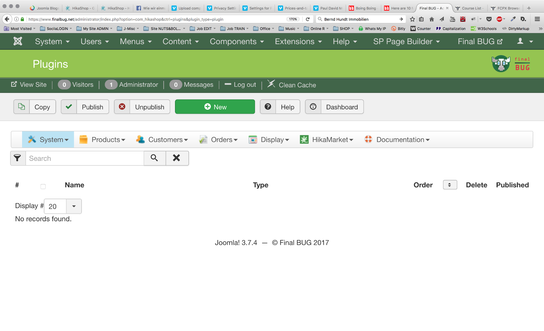

Under System>Plugins I have nothing active!
I have no idea where the ""cartnotify" plugin is installed and have no idea why the Pay Pal Plugin is not working!?!
I am pretty sure that at some point I had both the: HikaShop Paypal plugin & DT FastSpring Payment for Hikashop working...
kindly advise
Paul

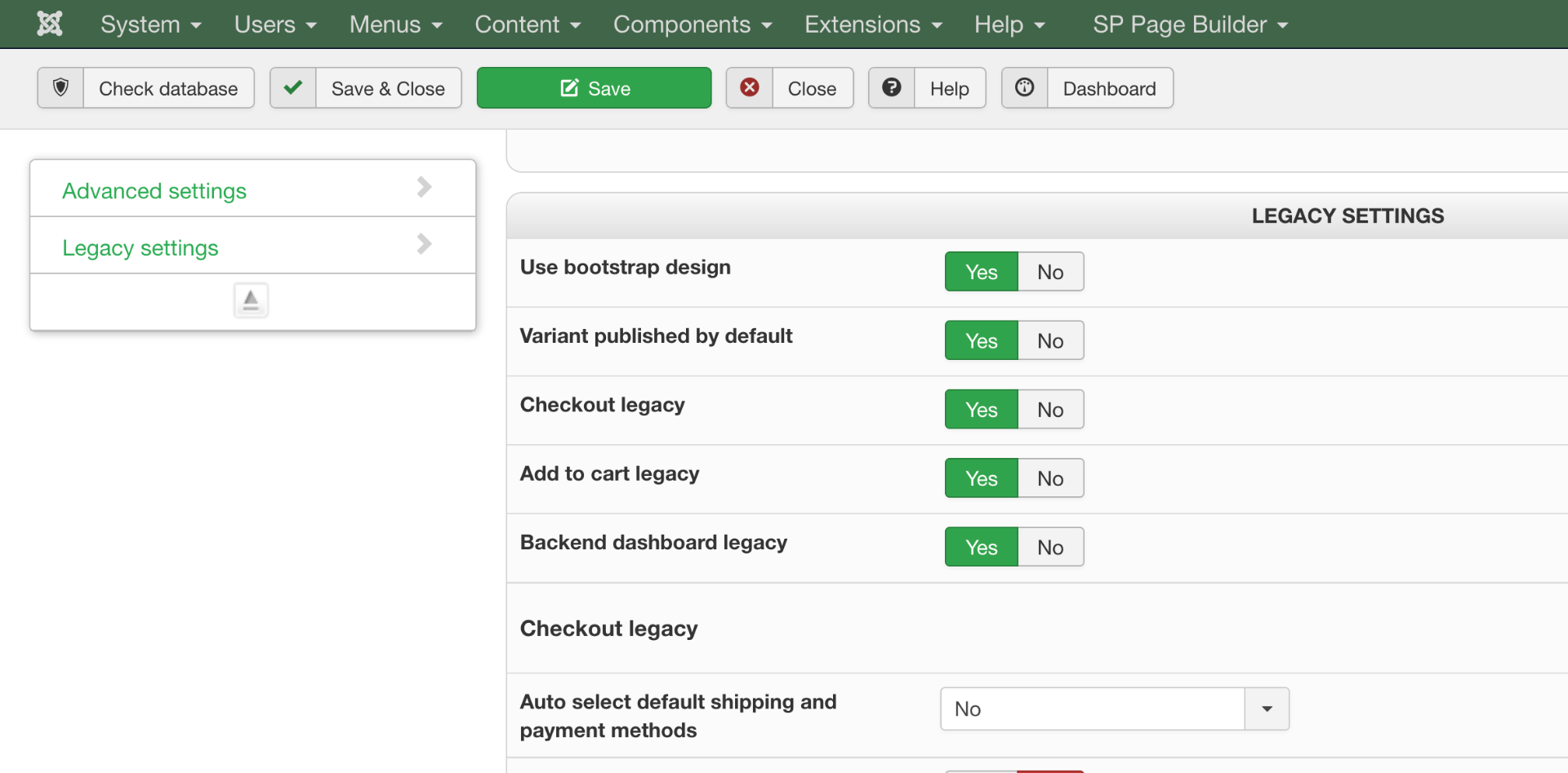

Hi Jerome
I changed the setting in screen shot 1 & 2 and now things work again!?!
kindly advise
Paul
  • Posts: 26355
8 years 10 months ago #275514
You switch to the legacy mode ; it's not "working again", it's using the old HikaShop features which are now deprecated.
Please follow the instructions I gave you.
I didn't talk about any payment or shipping plugin ; I told you that it was a plugin, which mean a regular Joomla plugin !
www.hikashop.com/home/blog/357-hikashop-3-0-beta.html

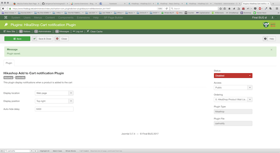

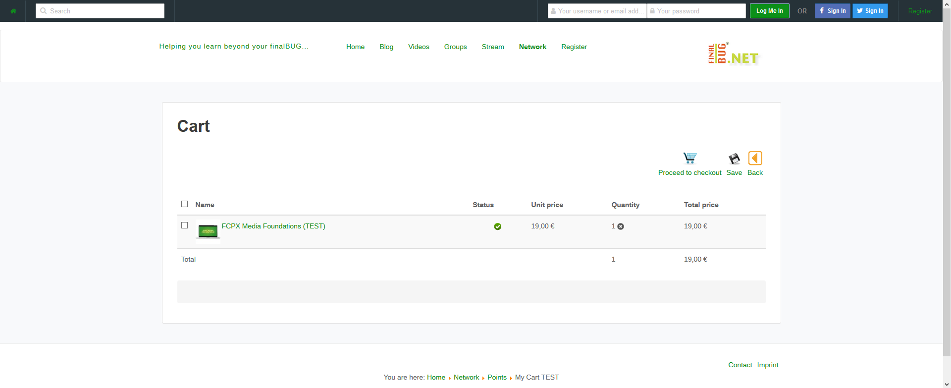

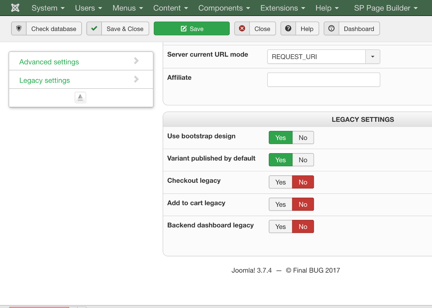

8 years 10 months ago #275571
Hi Jerome
So I have now gone to the Joomla plugins and found
1) Hikashop Add to Cart notification Plugin "cartnotify" and disabled it!
2) I went back to
System>Advanced>Legacy settings and switched them off again and…
As you suspected the cart now works as expected…
What I still do not understand is this and please correct me if I am wrong…
a) I now on Hika Shop 3+
b) Using a Hika Shop 3 + feature = “cartnotify”
Is there a way to get both working?
You talk about configuring the plugin...
...but in the plugin itself there is not a lot to configure!?!
Kindly advise
Paul
  • Posts: 85721
  • Thank you received: 14051
8 years 10 months ago #275572
I don't understand what you mean by "Is there a way to get both working?" Which both are you talking about ?
In the design of HikaShop 3, it is normal that you need to disable the cart notify plugin if you don't want the notification and want instead to be redirected to the checkout.
The settings in the plugin allow you to configure how you want the notification to be displayed to the customer. There are not many settings because not more are necessary for now.
