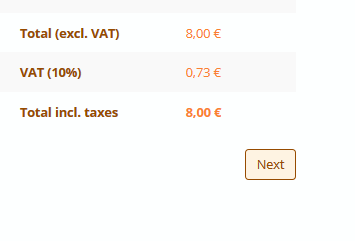

Prices with and without tax are the same in cart during checkout, which should not be. While in the email confirmation order the two prices are well computed. How can I fix the problem during the checkout?
  • Posts: 86027
  • Thank you received: 14172
8 years 11 months ago #277561
This indicates that you have the "show taxed prices" setting activated in your HikaShop configuration.
So the prices of the products and the sub total prices include the tax.
And thus, the tax row on your screenshot is only there as an information and not to be summed to the sub total.
The following user(s) said Thank You: idimarco

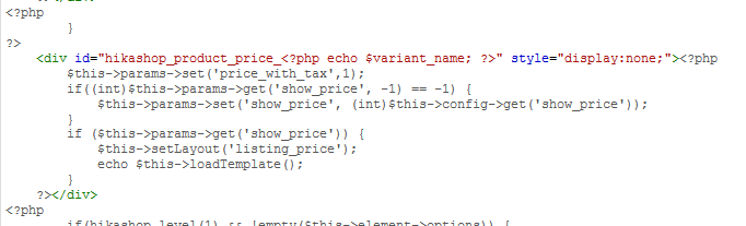

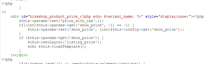

  • Posts: 80
8 years 10 months ago #278304
Hi Philippe
Thanks for your reply but still the prices in product page are shown without tax. Attached is the printscreen of product/show.php I changes in accordance to your comment. I am a bit frustrating since it should be now easy but it doesn't. What is wrong in the code?
thanks
  • Posts: 26380
8 years 10 months ago #278347
You put the code in the view "show" and not at the beginning.
Before that, there is some code which perform the display of the product page ; since the place that you are is the display of variant prices (which also mean that it will just override how the variant prices are displayed, so you need to have products with characteristics).
Just as reminder :
In that case, rather than changing that option, you can add at the top of the file step (or show)
