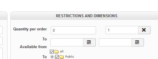

Setup a shop were the "Course" products require information for a student. I then limited each product to a "Quantity per order" to 1. I did this so they would be forced to give information for each student. This however means they need a separate order for each student.
The owner requires information for each student and that was the only way I could see to make sure he got it. If I remove the "quantity per order" limit then a user could order 10 classes but not provide information for all of the students.
Is there a better way to do it so someone could add more students per order for the same course?

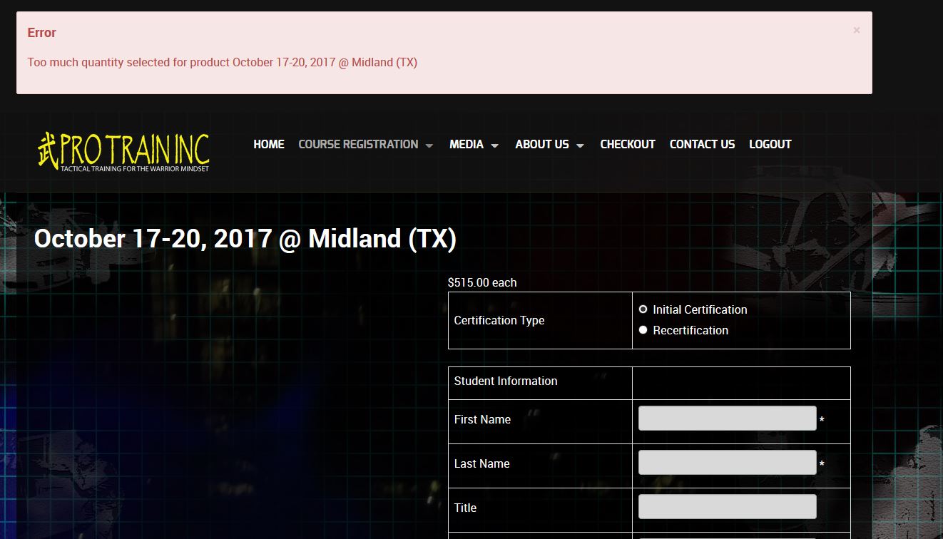

i have a similar problem. i use some extension that send my course to hikashop as a product. is it possible disable quantity field in hikashop?
i want each my user can buy only 1 time each product. (because some users maybe make a mistake and buy 2 time of one course and it is not mean)
i set quantity per order to 0 / 1 . but some time my user follow steps to half of full pah of buy a product and then error to him "Too much quantity selected for product"
notre: i disable show any cart or buy basket. i want simply buy a product without any basket and qauntity

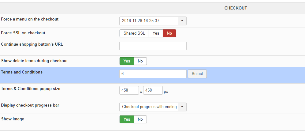

7 years 6 months ago #302918
Looking at your screenshot, it seems that you're using the old checkout of HikaShop. Turn off the "checkout legacy" setting of the HikaShop configuration, save the configuration, and you'll see what I was talking about.
I also don't see what you mean by "is there anyway when user click on the product (course in my case) , he get the error that you need to continue previous check out then he redirect to cart". Could you illustrate your needs with some screenshots ?

7 years 6 months ago #302982
your advise about disable legacy and enable read only, resolve my problem .thank you.

thank you Nikolas and it seems i have that problem again.please hear my problem and give me a solution:
i have some product that they don't need to buy more than one time.means when you want a video you not need to buy 2 time. also i want remove basket or cart system. means i want implement simple buying workflow without basket or cart, simply i want my user can click on product and paying that. for prevent buy more than one time for each product, i limited product set quantity per order 0/1 as you say.
i have an other problem. some of my user inter in the workflow and continue to half of way, then go out of my site or want to start again from begin of workflow for any reason. but when they want start again they get "too much quantity" error. this is not hikashop bug, i need to better UX for this method of selling. are you any suggest or advise?
i want do something for this problem: if user left workflow of his buying in the midway, and come back to buy, he don't get too mush quantity and can simply buy that product.

If you access the checkout after leaving it through a menu item of the type "HikaShop checkout", or the cart module's "proceed to checkout" button, you won't get that error. You'll only get it if you click on the "add to cart" button a second time after you already added the product to the cart.
What you can do is turn off the "add to cart legacy" setting if that's not already done. Then, you can configure the "HikaShop cart notification" plugin via the Joomla plugins manager to configure how Hikashop will display the add to cart success message or error message and redirect to the checkout or not after the add to cart.
What you could do is set it up to display a centered popup notification without the redirect to the checkout.
That way, the customer would get button to access the checkout on the popup, whether it's a success or not.
Another thing you could do is use a translation override to empty that error message:
That way, the error would not be displayed.
