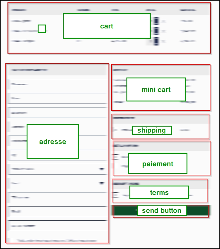

where can I find easy doc to change my checkout layout ?
I need to have somme blocks aside each others
or is there an extension that do that ( dragaand drop blocks to modify layout of checkout) ?
  • Posts: 94
8 years 10 months ago #279738
here is the way i'd like to have my view

ok, but that does not explain what are the files for the checkout ( and how to change it for my need )
checkout layout is modified by javascript and calls in the backend, it is not the same thing as product or list layouts.

It does explain you that if you want to know what are the files involved, you can just turn on the "display view files" setting of the HikaShop configuration.
Also, I don't even think that you need to edit the code of the views. You should be able to do that with only CSS by having each block's main div floated left or right, and its width limited to 50% of the page.
And the top of the page of the link Mohamed gave you explains how to edit the CSS in HikaShop.
So if you know CSS, you should be able to pull this off.
