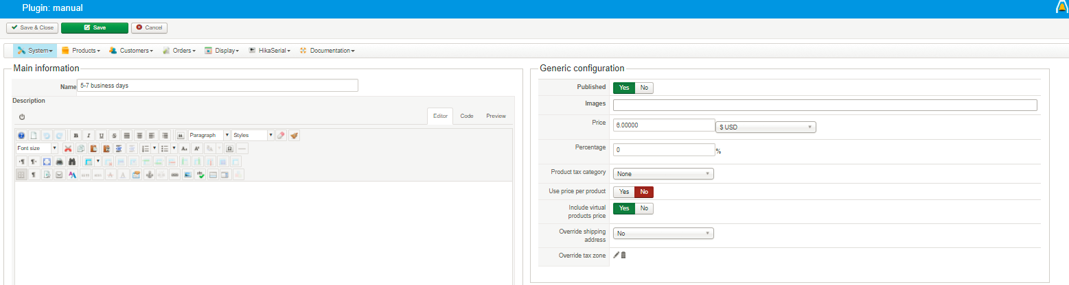

Hi, I am using the manual shipping method in the cart and adding this product to the cart

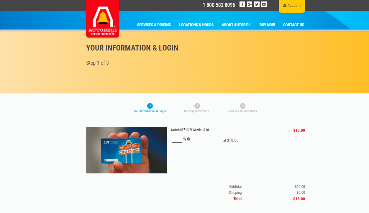

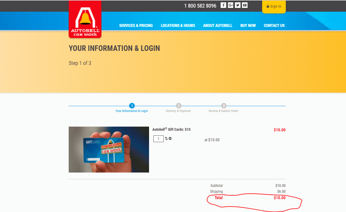

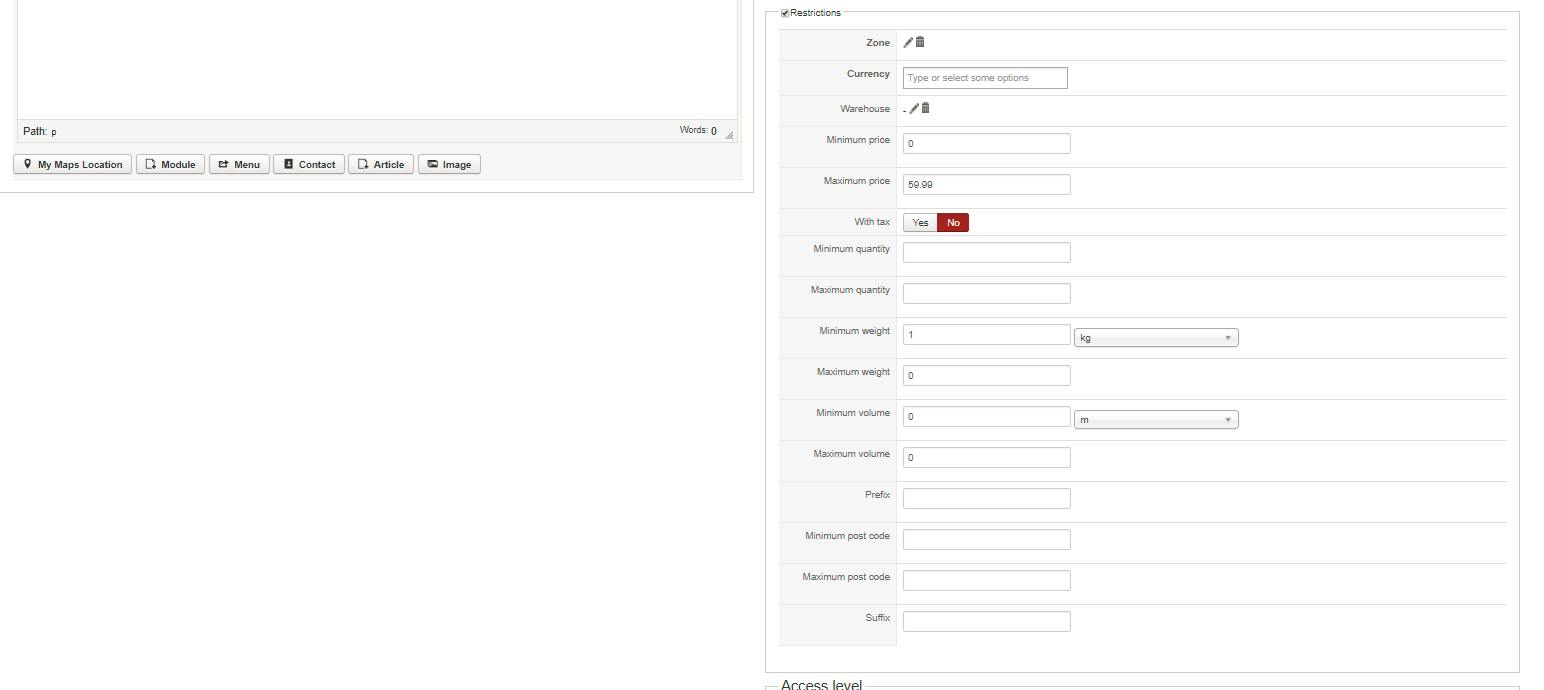

However, I believe I have discovered a bug in the cart. If you are not logged into the cart and you place an product in the cart the shipping is not added to the cart total. If you are logged into the cart however, the cart total is correct and includes the shipping in the total. I removed all layout overrides from the cart and installed the latest version of the cart from today. However, whether all customization's or not are removed this still happens. Attached are my manual shipping coupon settings as well as a screenshot of the correct total that shows when logged into the cart and one from when I am not logged into the cart and the incorrect total shows.

I've had a look thanks to your acceses.
Well, as I was expecting it comes from a 3rd party plugin you have on your website.
If you deactivate the AvaTax plugin in your Joomla plugins manager, it works properly.
So I would recommend contacting AvaTax (or PolishedGeek ?) as there must be an issue in it.
Maybe you have an old version of the plugin ?
