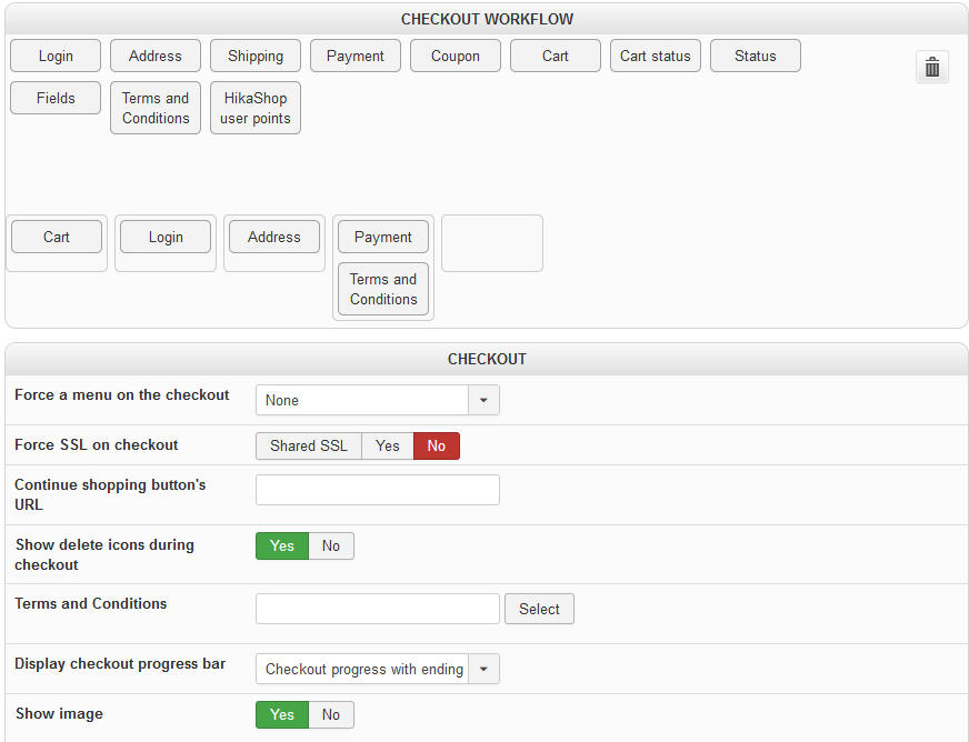

8 years 9 months ago #281049
Please see attached. In your video you have a checkout progress bar, at least I think that's what is I do not get this showing the steps to check out. It's most likely something simple figure out

  • Posts: 86027
  • Thank you received: 14172
8 years 9 months ago #281052
I don't see why you would miss the progress bar if the setting is activated, unless you have an issue with your Joomla template.
