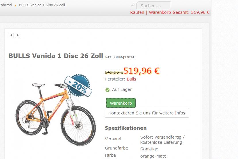

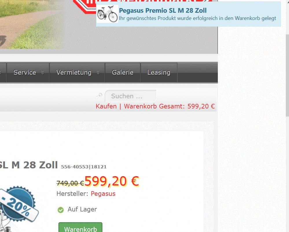

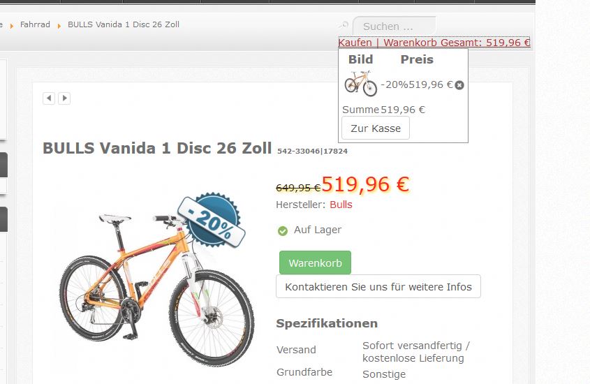

I'm using the mini cart. With 3.1 after buying a product the small pop up appears and I can immeadtly klick on the text and the mini cart appears and I can start the check out proceses (see attachment 4).
After the migration already the pop up will not be shown (it looks like that there is only a 1 pixel line) but the text appears. But after clicking nothing happens.The link looks correct
www.2-rad-schwede.de/index.php/fahrrad-shop/checkout
After F5 or the changing to another page everything works fine and clicking the text shows the mini cart I can start the Checkout
any idea?
thanks
Markus

I tested a little bit. From my perspective the notification box is the problem. as long as the box is on the screen the link is not working (or the dropdown will not be created).
any chance to modify reduce the notification time?
best regards
Markus
