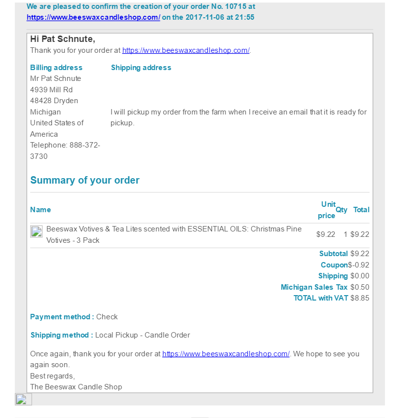

Where do I edit the text at the bottom of this test email sent to a customer-- Thank you for the order etc. I cannot seem to find it

All the text of the emails is available as translations and thus can be overridden:

Hello - Thank you for the article:
I copied this line to the override section on the bottom
ORDER_VALID_AFTER_PAYMENT="Your order will be processed as soon as your payment is received."
and changed it to:
ORDER_VALID_AFTER_PAYMENT="<p><span style="color: #800000; font-size: 14pt;"><strong>Attention! This invoice is your ticket. </strong></span></p>
<p><span style="color: #800000; font-size: 14pt;"><strong>Just print it and bring it the day of the Concert.</strong></span></p>."
I tried an order and the original text was still on the customer invoice. Was I supposed to delete it from the top area? I did not clear cashe in my browser - could that cause it.??

You can use double quotes in your translation content.
Since the translation content must be between two double quotes, if you add some into, it can't be read by the Joomla language core system afterwards.
And please note that carriage return are not well appreciate by the Joomla language system either.
