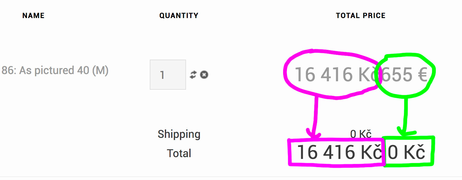

I am trying to make own currency switcher module that will work with cache.
What I need is to display both prices everywhere, listing, product view, checkout and then I will show or hide one of them.
Only place where I still can't get both prices is cart total, as pictured bellow:
I need to have price in EURO (it is original currency) in total too.
I know where I should put the code, but I do not know the code, I tried this without success, it is always zero:
echo $this->currencyHelper->format($price->price_orig_value_without_discount_with_tax,$price->price_orig_currency_id);
echo $this->currencyHelper->format($this->full_total->prices[1]->price_value_with_tax,$this->full_total->prices[1]->price_currency_id);

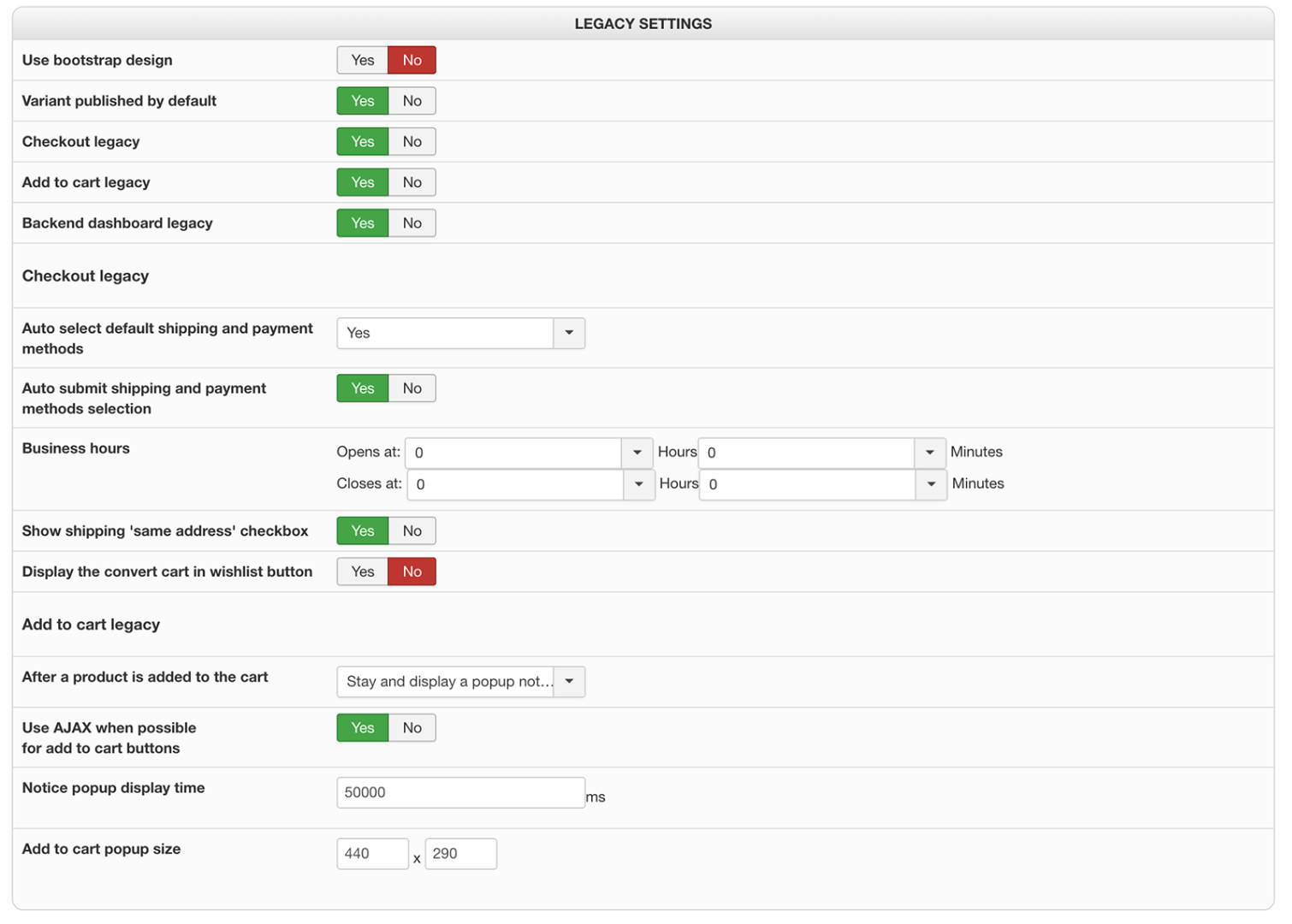

8 years 7 months ago #285243
Let's check something, can you provide a screenshot of your Legacy settings, like on this image :
Awaiting news from you to better understand what's going on.

8 years 7 months ago #285256
Hello Nicolas,
thank you, here it is.
BR,
F.

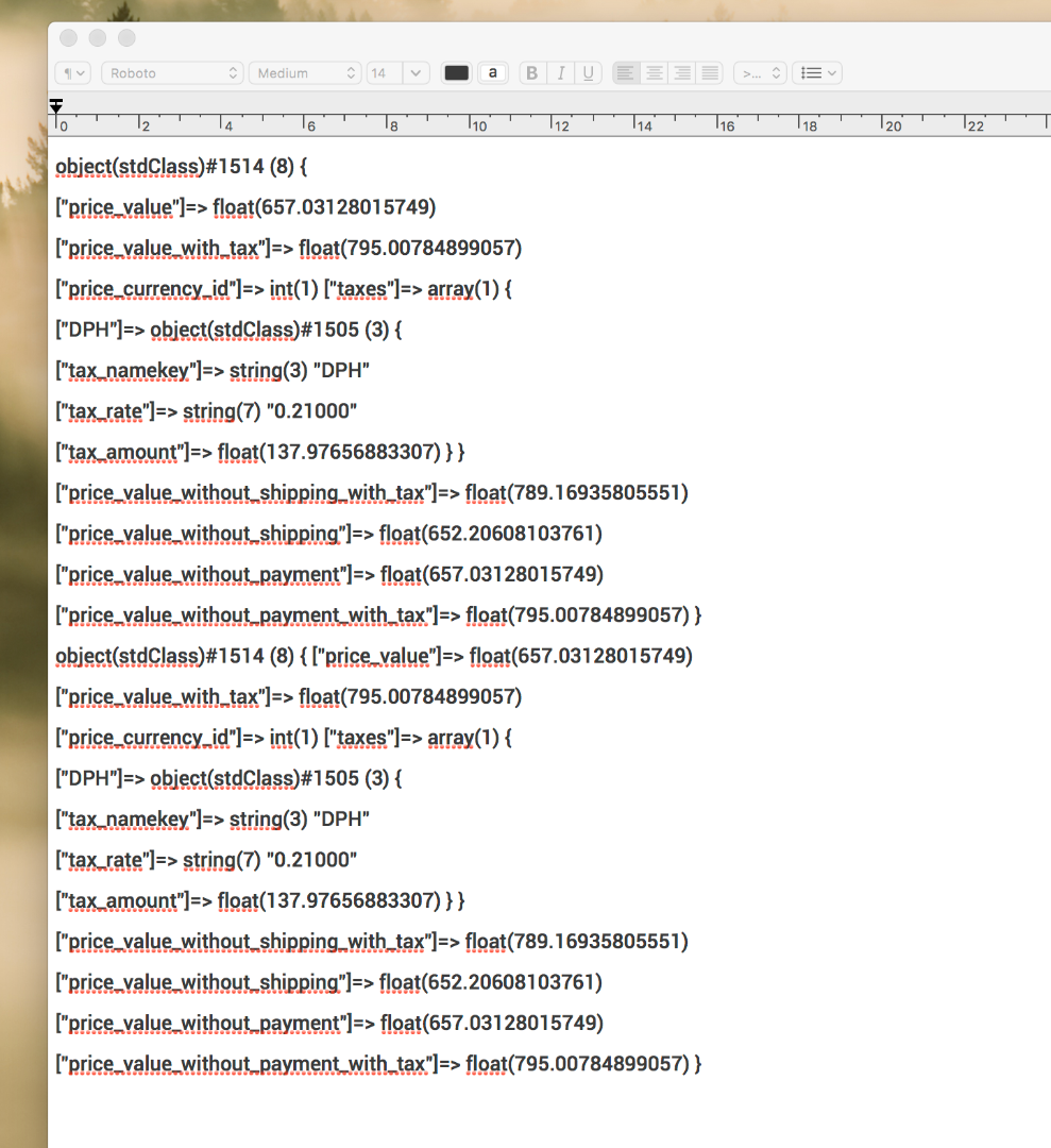

8 years 7 months ago #285258
Add that code:
var_dump($this->full_total->prices[0]);
and you'll see all the attributes that you can use instead of price_orig_value_with_tax which apparently doesn't exist there.
  • Posts: 217
  • Thank you received: 4
8 years 7 months ago #285282
Hi!
Briliant idea! It seems there is no variable with original currency, here is output.
Any other ideas how to get that variable, please?
Thank you,
Filip
