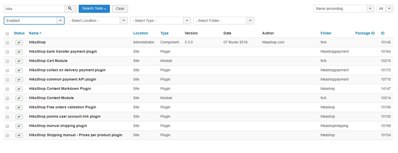

  • Posts: 53
  • Hikaauction Standard Hikamarket Multivendor Hikaserial Subscription Hikashop Business
8 years 3 months ago #287935
I have disabled all not necessary plugins for hikashop.
Here you can see the only plugins enabled.
I have too disabled Admintools plugin too and removed .htcaccess file and i always have an error 500...:(
Last edit: 8 years 3 months ago by extonjaez.

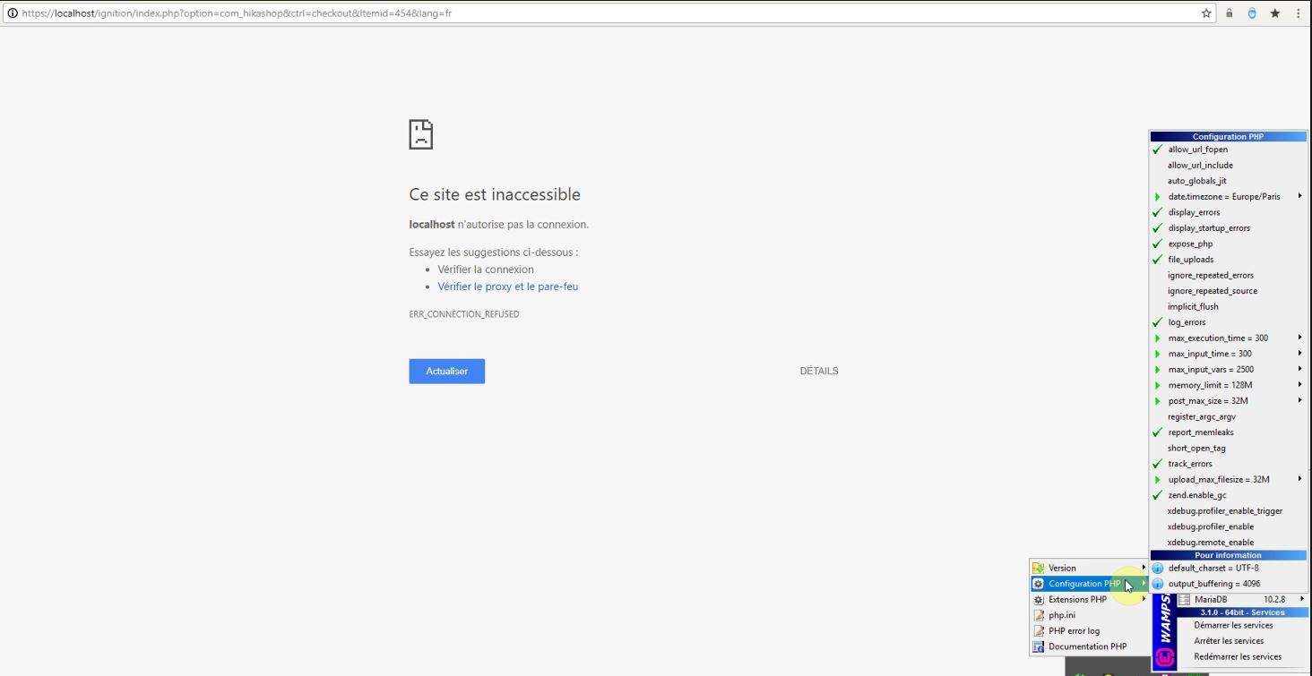

And i have installed the ghost of my site in WAMP server (to remove the limitations of my provider 1and1)
but i have always the same error

8 years 3 months ago #287952
If you have the same problem in local, then activate the PHP error log of the server, reproduct the issue and then check the PHP error log of your local server. You should find there the fatal error message.
stackoverflow.com/questions/9230984/erro...h-wamp-server-in-php
Also, the extension creating the problem is not necessarily a plugin. It could be another component, a module or even the template.
In fact, it's highly possible that it is related to the template so you can try switching to the default template of Joomla and see if that helps.
