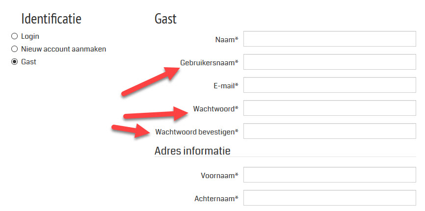

Thanks for the new checkout-system. Looks a lot better.

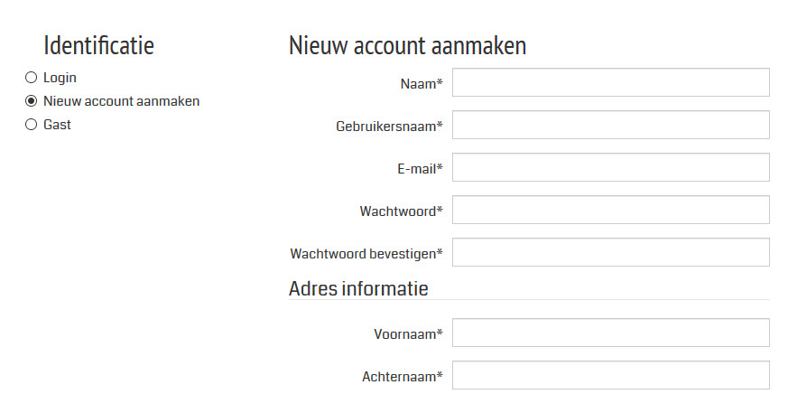

When i turn off the "show submit button" setting of the "login" view of your checkout workflow, i see the guest checkout don't work.
The guest-checkout looks the same as the register-checkout, so you see a username and password field, this is not updated when i choose guest-checkout.
Can you have a look at it?

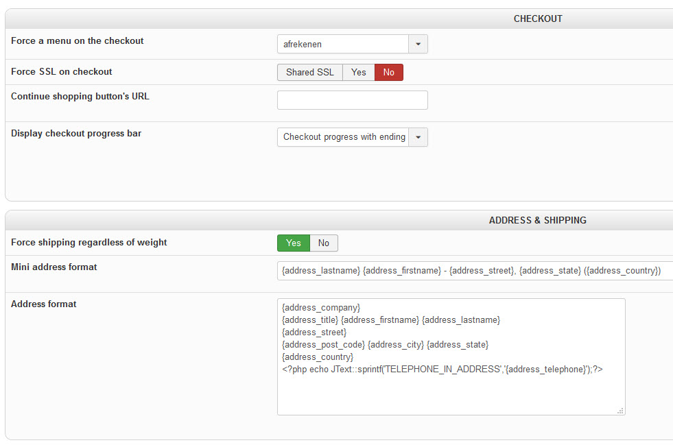

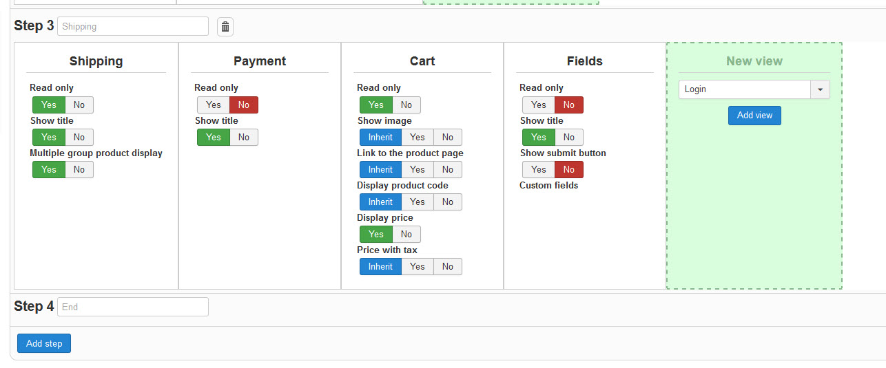

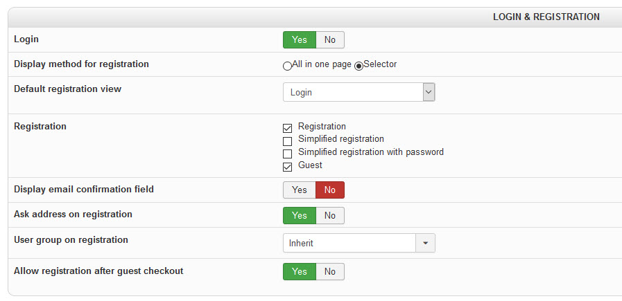

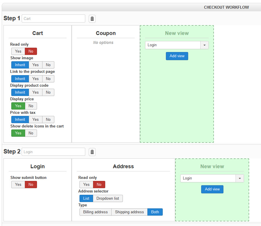

8 years 4 months ago #290461
Here are my settings:
Attachment not found
When i set Show submit button everything works fine again, but it would be nice if i could turn this off.

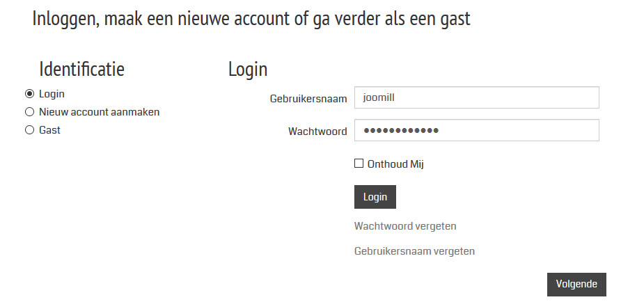

And some frontend screens

Registration fields are no custom fields so there is no way to set ACL for Username and password.

I switched to the protostar template and the results are the same.
I will send you a link and login with the contact-form

Thank you for that. I was able to understand the situation and added a patch on our end.
Download again the install package in the menu My account>My subscriptions and install it on your website and you'll get the patch.

Thanks, but i think something went wrong.
Now also the login-page looks like a registration page.

Indeed, it's a copy/paste error.
Download again the install package in the menu My account>My subscriptions and install it on your website and you'll get the patch for that too.

Thank you, it works fine now!
