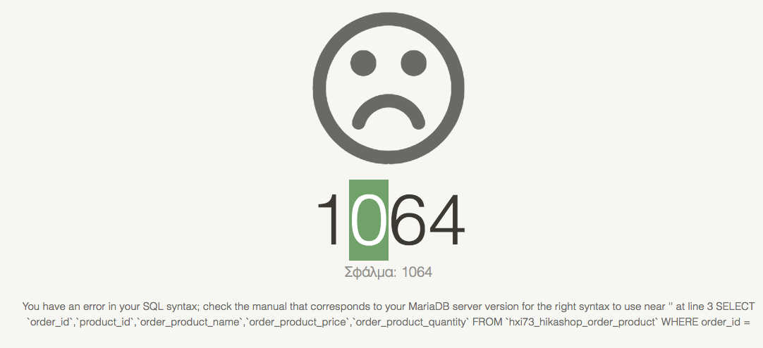

after updating to latest version of hikashop, i sometimes get this error when i click on finish at the chekcout page:

Please do that change in order to get the MySQL query for that error message:
www.hikashop.com/support/forum/2-general...ror-1054.html#287524
That will help us better understand what is going on.

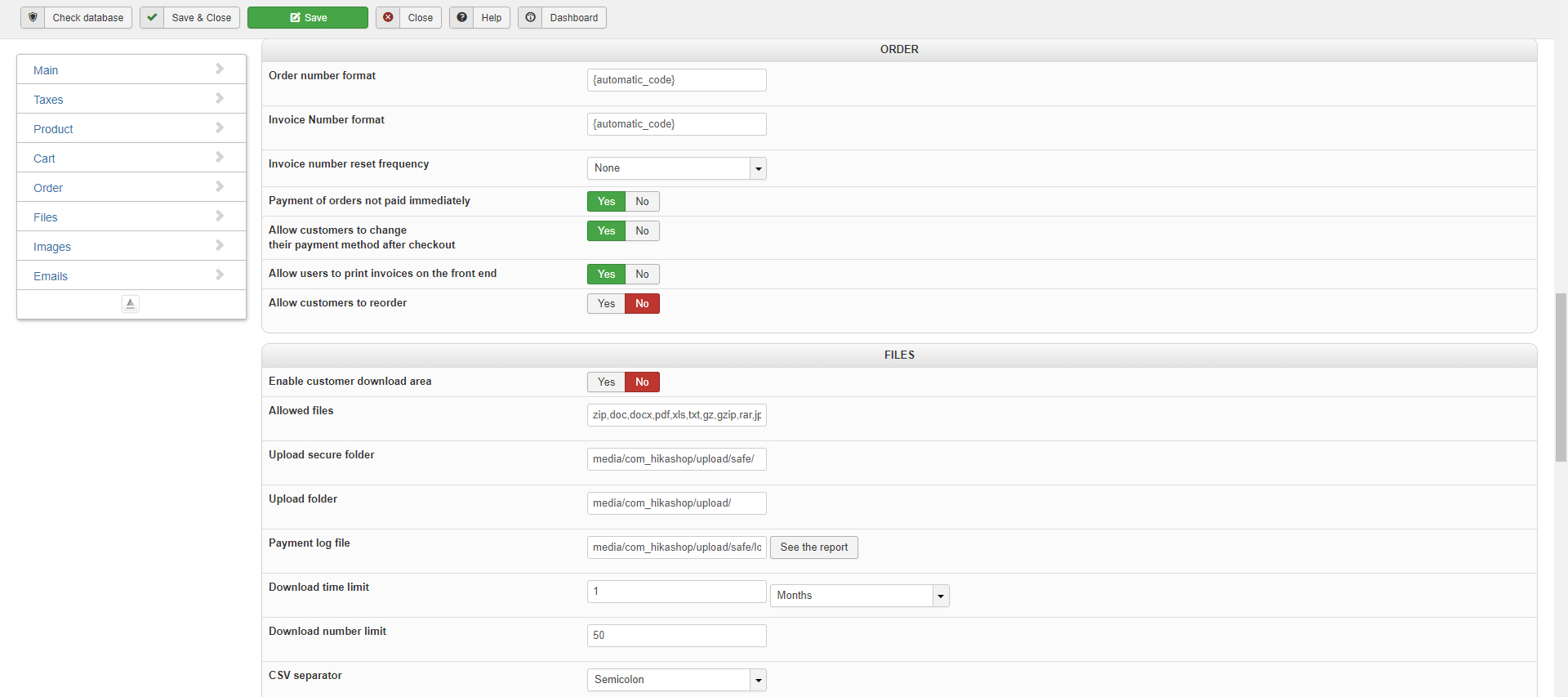

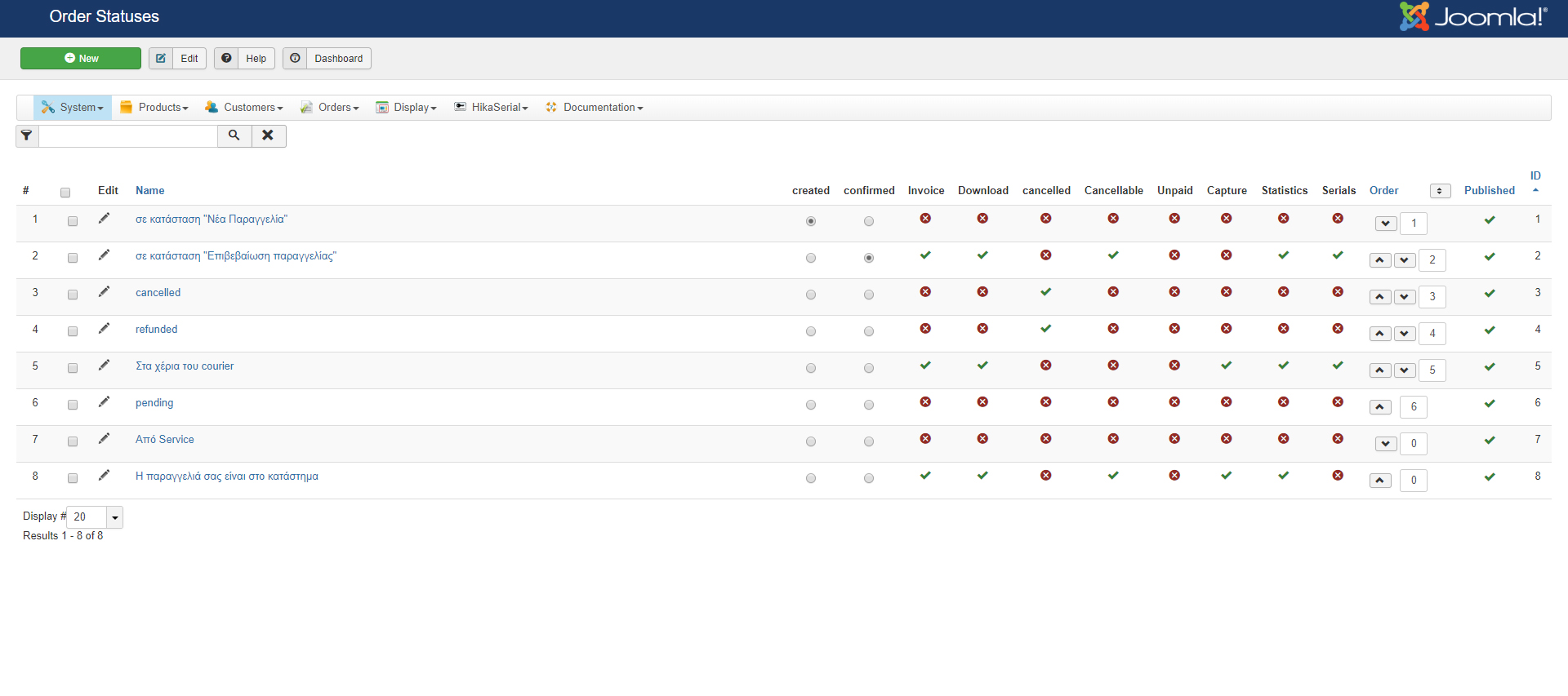

Regarding the quantity issue, could you provide a screenshot of the settings of that product ?
Could you also provide a screenshot of the System>Order statuses menu and of the "order" section of the HikaShop configuration so that we can get a better understanding of the situation ?

8 years 2 months ago #292775
it's not one specific product that has that problem, if it helps i can send you credentials to check.
Here are the screenshots you asked
Thank you

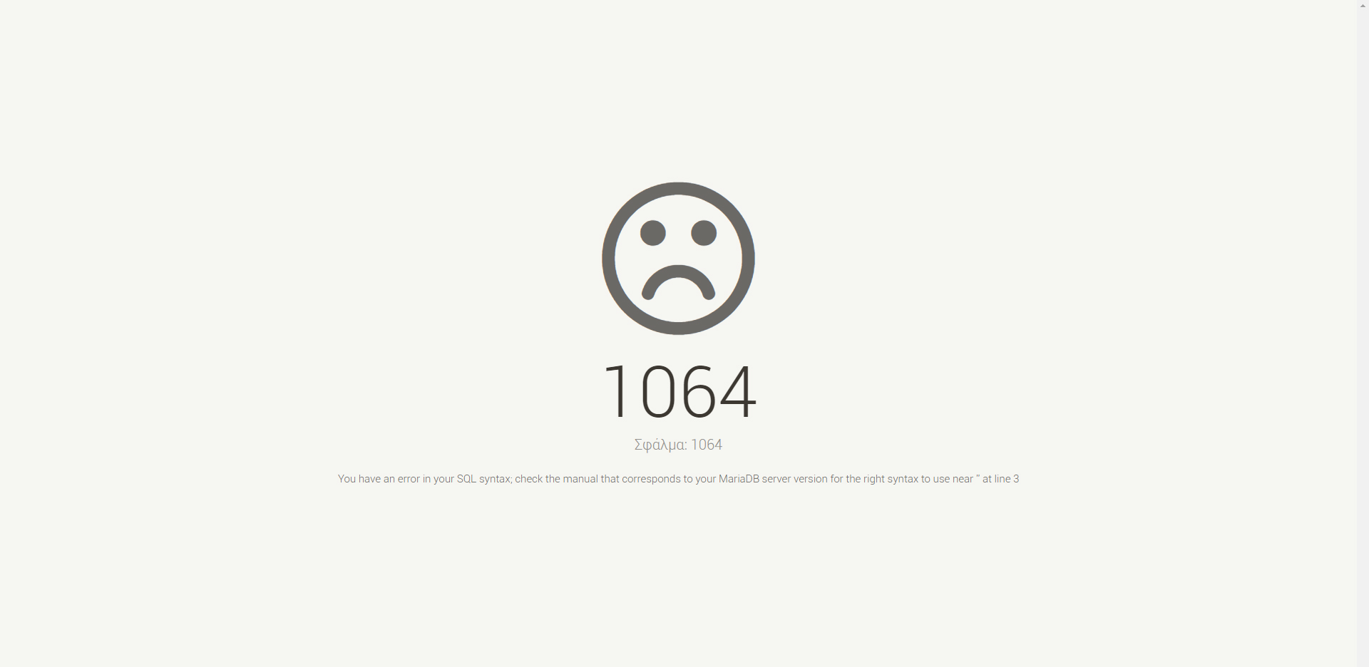

  • Posts: 1184
  • Thank you received: 13
8 years 2 months ago #292953
i enabled debug mode but i got nothing, no details about SQL error.
I'm sending you credentials to access administration if you could please take a look?

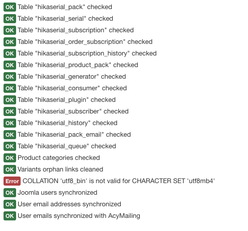

8 years 1 month ago #294206
HI!
ALSO 1 error in db
