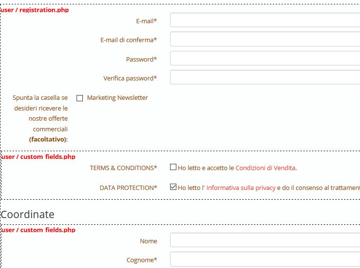

remove the overrides and now fields alignment is fine. However, I still have 2 blocks of user/custom fields in my template which I would like to switch position (the block for First name, Last name* and Telephone* should be displayed before the block dedicated to the consent to terms & conditions and privacy policy). I tried to move the following but it does not work (see attachment).
$this->setLayout('custom_fields');
$this->type = 'user';
echo $this->loadTemplate();
Maybe is that because one block is address/customer fields and the other is user/custom fields?

  • Posts: 86027
  • Thank you received: 14172
8 years 2 months ago #293394
This code is for the display of the address fields:
if($this->config->get('address_on_registration',1)) {
<div class="hikashop_registration_address_info_line">
	<div colspan="2" height="40">
		<h3 class="hikashop_registration_address_info_title"><?php echo JText::_( 'ADDRESS_INFORMATION' ); ?></h3>
	</div>
</div>
<?php
		$this->type = 'address';
if you swap it with the code I gave in my previous message, which displays the custom user fields, it will do what you want.
  • Posts: 80
8 years 2 months ago #293509
Thanks for your reply but when I swap the form is not desplayed. I do not know why.
So I adopted another solution: i changed value for core custom fields to use field that I need.
