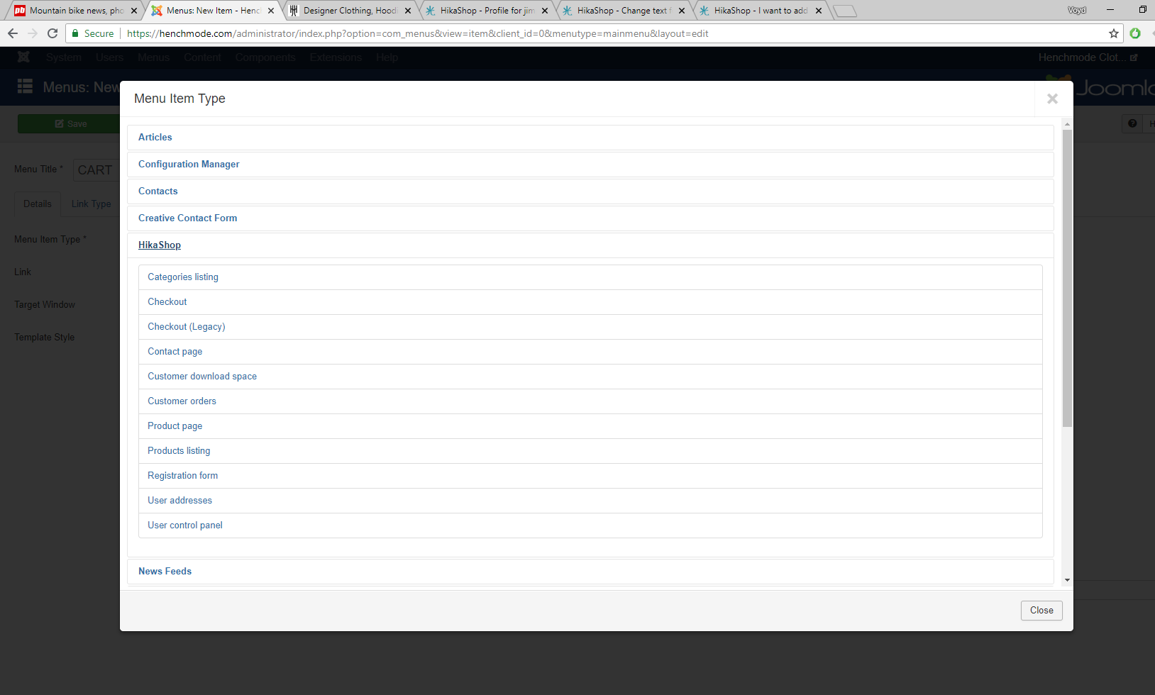

  • Posts: 34
7 years 11 months ago #294145
Thanks for your reply.
I do not appear to have this option. Screenshot attached.
I'm up to date on Joomla and Hikashop versions.
Is it a module/plugin that I have turned off maybe?
  • Posts: 85712
  • Thank you received: 14050
7 years 11 months ago #294153
I had missed the fact that you're using the Starter edition of HikaShop.
The "cart display" menu item is part of the multicart capabilities of the commercial editions of HikaShop, so that explains why you don't see it.
Then, as an alternative, what you could do is use the type "checkout", and in the "checkout workflow" of the HikaShop configuration, you could configure a first step with only the cart view.
