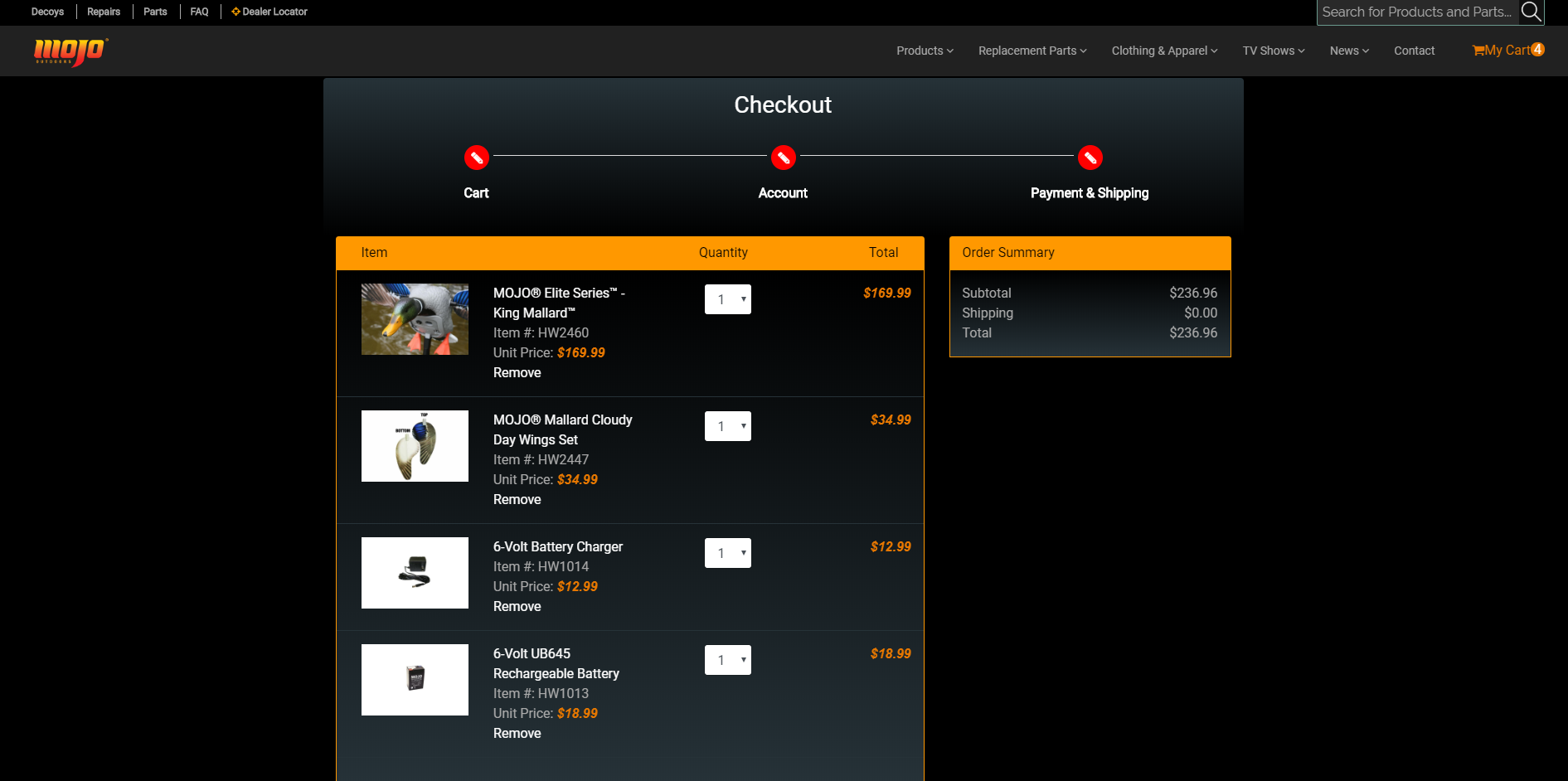

I created this little order summary view in the "checkout / show_block_cart.php" view that you can see in the screenshot below:
However, I am trying to figure out a way to display the order summary only (not the full cart) on every page of the checkout. I would assume I could accomplish this by adding it to the "checkout / show.php" file. I tried this and it displays the block, but not the cart information. How would i display the order information on any arbitrary view file?
Or rather, is there a better way of accomplishing this by maybe adding a new view to the checkout process? Any help or advice would be greatly appreciated!

I'm not sure I follow. It sounds like you are suggesting to remove the "Cart" step from the checkout workflow. However, once I do this, I'm not entirely sure how to display this module on every page of the checkout?
Basically, i want to create another checkout view that is visible on every checkout page. The best option I found is to include it on the "checkout/show.php" view file. However, I do not know how to pull the order info up in that view?

Exactly what I was initially thinking to do. However, I am not sure how to hide certain elements based on the current step. For example, if I wanted to hide a div on step 2 of the checkout, what is the php entry that corresponds to the current checkout step?

After playing around with it, I was able to get it working (at least the hide/unhide) with the read-only trick. I should be able to alter the display now to make it show on every page. Thank you!
