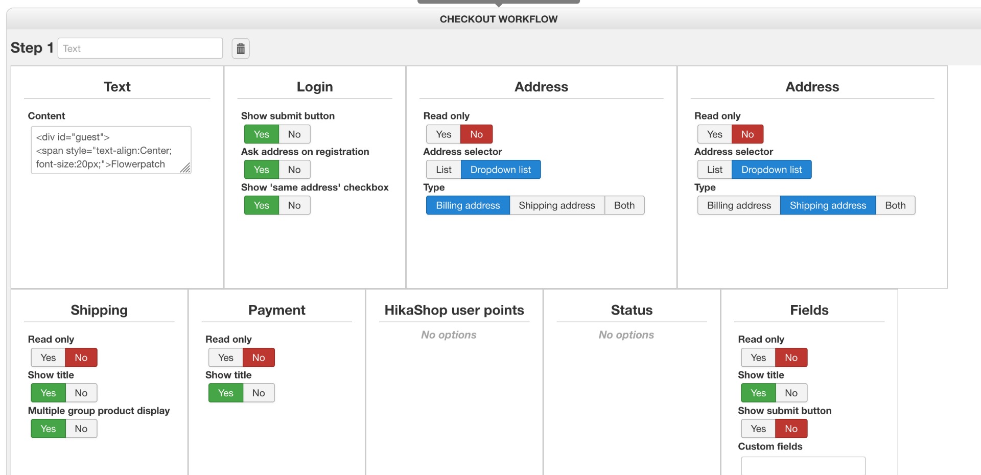

7 years 10 months ago #295921
In your case, the solution will probably be to directly add 2 "Address" action to your checkout workflow step (Hikashop->System->Configuration->Checkout) and set the "Type" option of the first one to "Billing address" and to "Shipping address" for the second one.
Best regards,
Mohamed Thelji.

7 years 10 months ago #296373
hi
its not appearing i tried to add this as seen below
is this correct

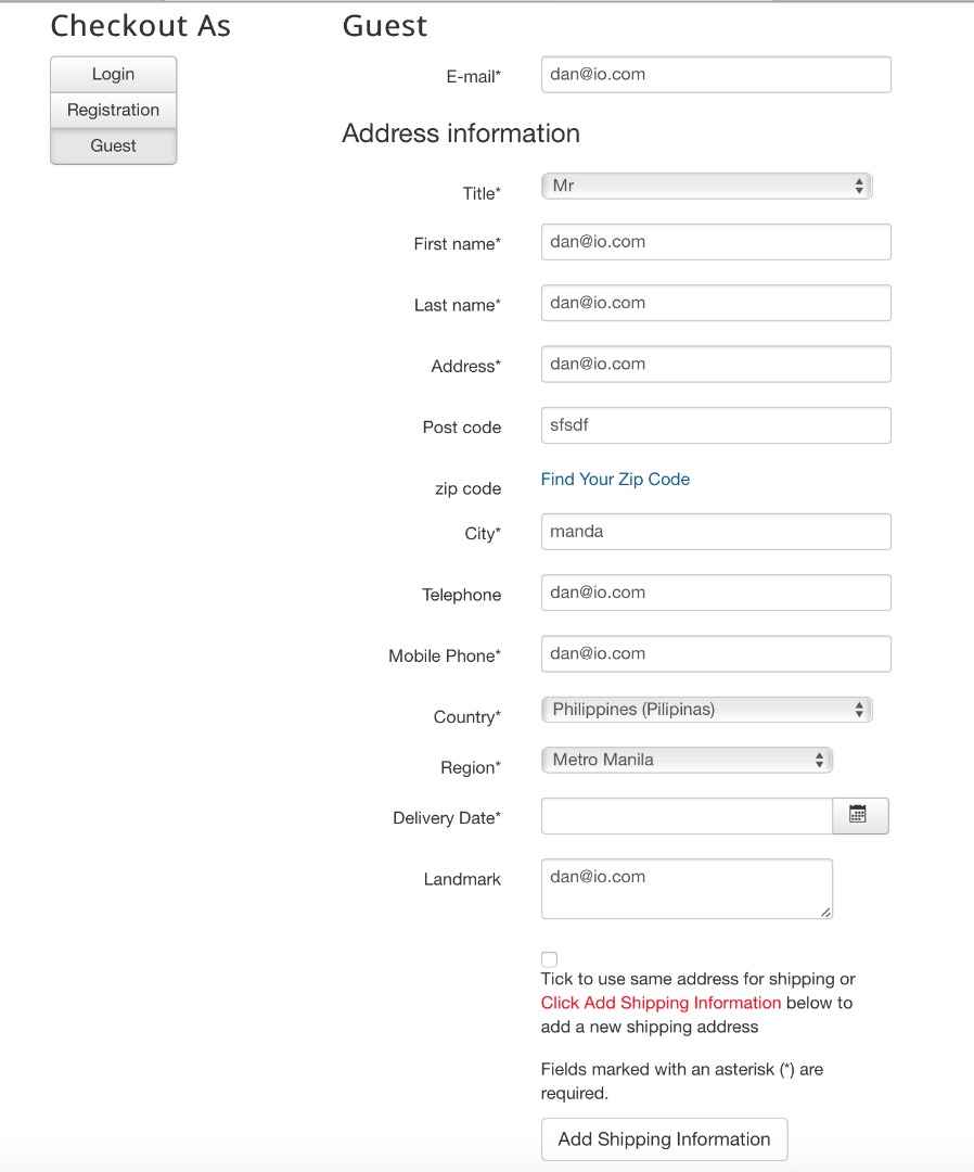

below is what i can see in the front end. its still only one
thanks

7 years 10 months ago #296384
You need to turn off the "ask address on registration" setting of the login view if you want to do what proposes Mohamed.
In that case, there will be no address asked on the login view, but once logged in (or in guest mode), each address block will display the form for its own type of address.

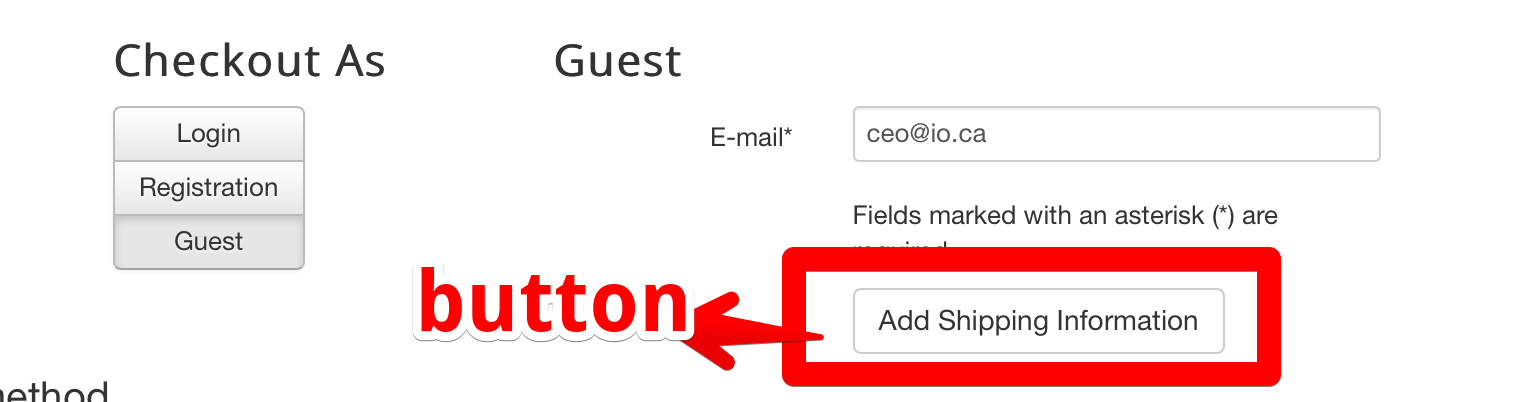

when i followed the instructions both billing and shipping disappeared and a button appeared.
1. When clicking the button that is when both billing and shipping appears. If i remove the button the billing and shipping will appear after clicking finish. My questions is would it be possible to make this a smooth checkout? Upon checkout, billing and shipping address, shipping method and billing method will appear in one page. when buyer is done with his selection simply click finish and his done.
2. if i select the option with show submit button = of
shipping and billing address does not appear, what i can see is the shipping and payment method. after clicking finish the billing and shipping address appears. after filling this up another scenario presents itself. to click save or not. if he clicks save no new page appears but if not he goes straight to finish, a new page will load. So these is a bit confusing and is no longer a one page checkout. if i choose this setting can these be a one page checkout with everything already out?

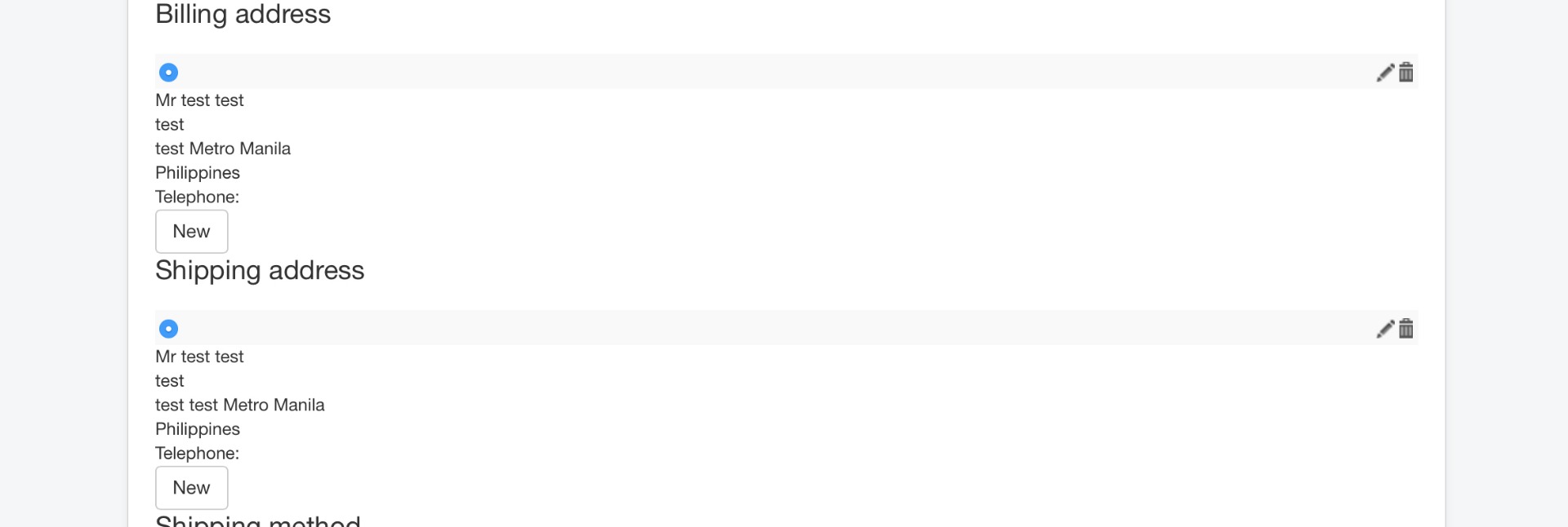

3. if i select the option with show submit button = on
clicking the button will display the shipping and billing address but if buyer does not click ok button he will be presented with a new page as shown below.
so my next question is can we have a smooth checkout without the extra buttons? after filling up the forms and clicking the desired payment method the buyer clicks finish and his done. Maybe i just need to configure it correctly.

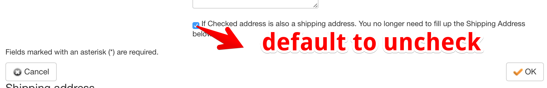

4. BTW when i followed your suggested configuration the radio button informing the buyer that address is same with shipping,Same address for shipping, is no longer working. so uncheck or check doesn't matter and buyer needs to fill up both billing and shipping. how can we fix this? please
5. Also how do i set the check boxes to uncheck. So that the buyer will have to check it if he wants the billing and shipping to be as one.

To uncheck the chekbox of the registration form, you would have to edit the file "sub_block_login_registration" and change the line:
			<input class="hikashop_checkout_same_address_checkbox" id="hikashop_address_<?php echo $this->step . '_' . $this->module_position . '_same_address_input'; ?>" type="checkbox" name="data[same_address]" value="1"/>
to:
			<input class="hikashop_checkout_same_address_checkbox" id="hikashop_address_<?php echo $this->step . '_' . $this->module_position . '_same_address_input'; ?>" type="checkbox" name="data[same_address]" value="0"/>
