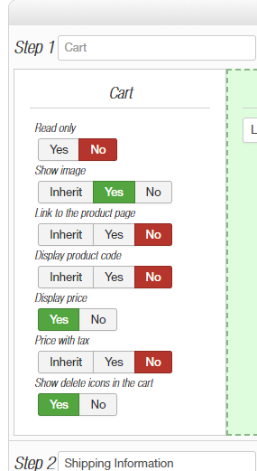

7 years 10 months ago #296204
Is it possible to have the Cart in the checkout page as read only ( not able to change quantities) and have the delete button available.
Sure, you'll just have to set the "Read only" option to YES, through options of the "Cart" tab of your checkout workflow via "Hikashop->System->Configuration->Checkout".
However you can't have both, a Cart on "Read only" mode and a Cart with a "Delete" icon.
Note that to have a "Delete" icon, you'll just have to set the "Show delete icons in the cart" to YES, through options of the "Cart" tab of your checkout workflow via "Hikashop->System->Configuration->Checkout".

Step 1 set delete hikashop-cart-delete.png (delete set to yes)

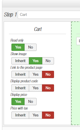

Step 2 set readonly hikashop-cart-readonly.png (readonly set to yes, no delete button available)

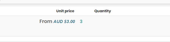

Step 3 The cart in the checkout as readonly and no delete button showing hikashop-checkout.png

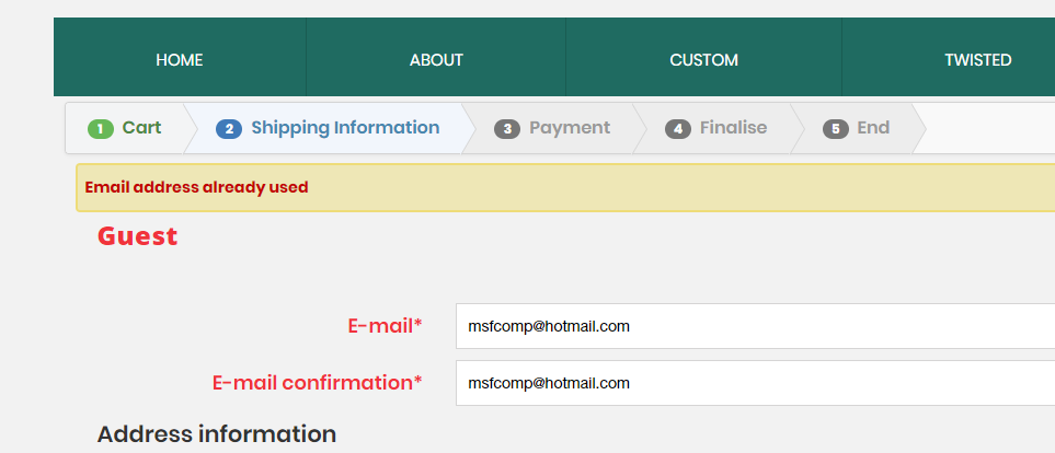

Also, another issue, A guest user returning, cannot user the same email address, the system says "email already used". hikashop-guest.png
Is there a way to get around this issue as well ???

As Mohamed said, you can't have both.
Either you turn off the "read only" and you have the option to display or not the delete button, or you have the read only turned on and you can't display the delete button.
If you want both, you would have to turn off the read only option and then use either CSS or PHP modification in the show_block_cart view to hide the quantity input field.

7 years 9 months ago #297590
@markfell, as @nicolas said, in Hikashop go to: Display > Views , and search for show_block_cart, if you have 2 templates installed in your joomla site you file find 2 of this file, if you have 3 templates you will find 3 files, so you need to edit the file from your current template used in your site.
And replace all from line 270 to 275 with this:
<input id="hikashop_checkout_quantity_<?php echo $product->cart_product_id;?>" type="hidden" name="checkout[cart][item][<?php echo $product->cart_product_id;?>]" class="hikashop_product_quantity_field" data-hk-qty-old="<?php echo $product->cart_product_quantity; ?>" value="<?php echo $product->cart_product_quantity; ?>" onchange="window.hikashop.checkQuantity(this);"/>
In this way you will see the quantity just as a simple text and you will have the delete button working.
The following user(s) said Thank You: markfell
