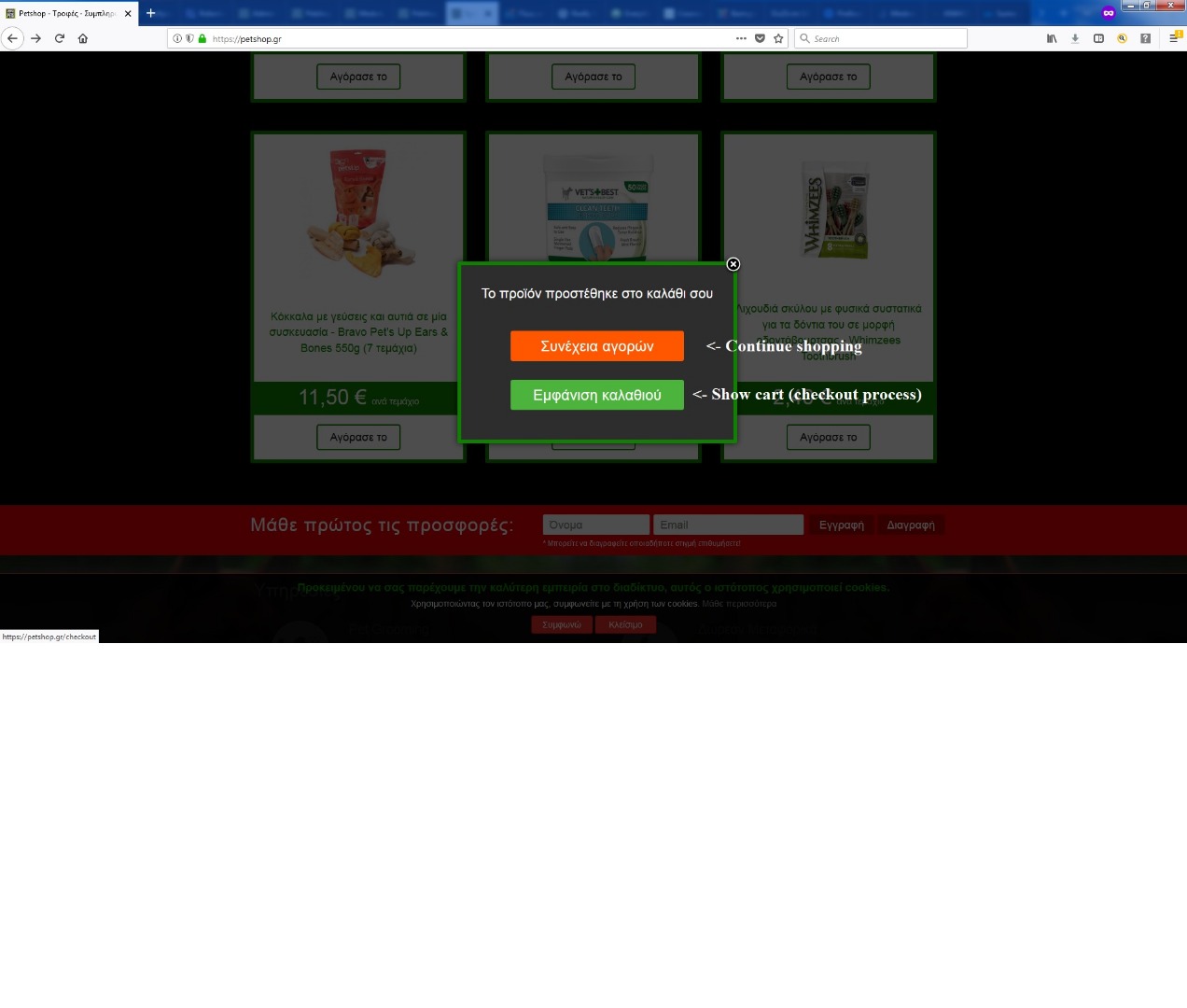

I changed Hikashop's Configuration -> Advanced -> Legacy Settings -> Add to cart legacy from Yes (before) to No and now it seems to work.

If you need to configure the notification on add to cart with the new system, you want to configure the plugin "HikaShop cart notification" via the Joomla plugins manager.
