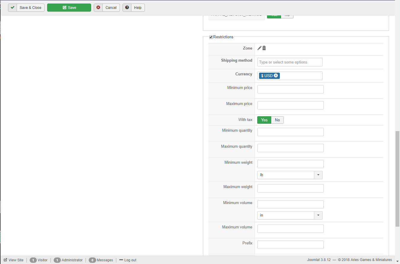

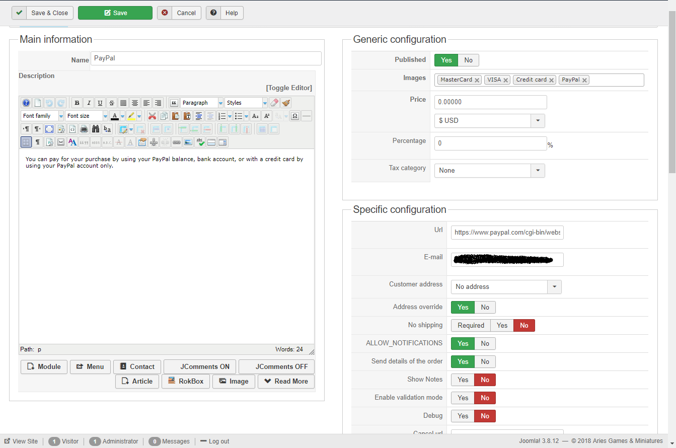

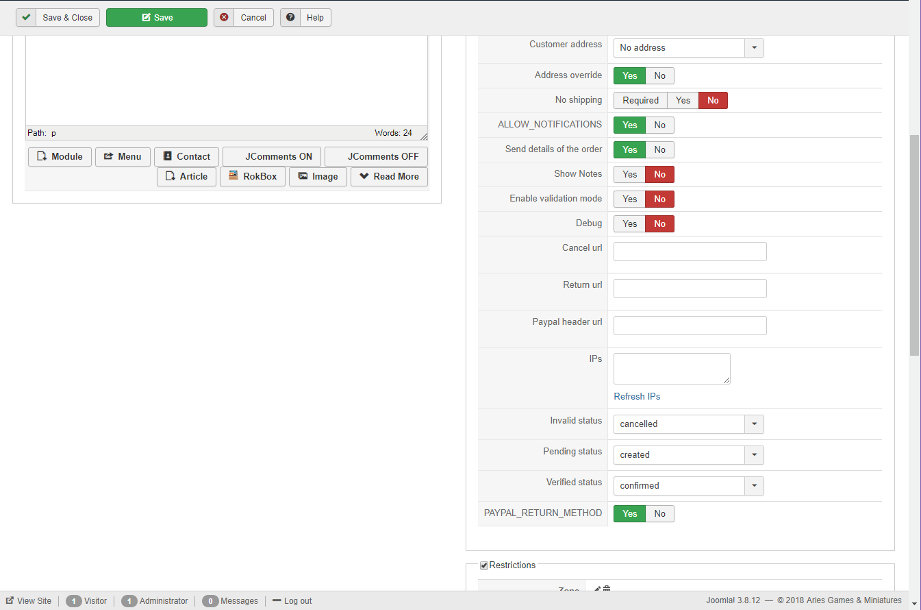

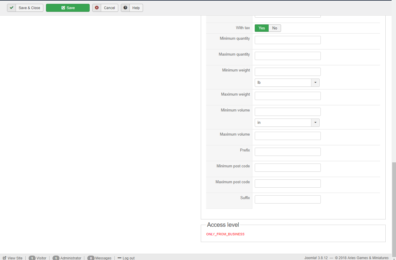

So I don't have time to check right now as I have to go into work, but can you take a quick look at the attached screen shots? I've changed nothing in the past week on my site, so my issue of a customer placing an order, and paying for an order...then not having the order automatically change to confirmed came out of nowhere. It was working fine in the morning, then somewhere in the early afternoon, it just stopped working properly.

The settings are fine.
