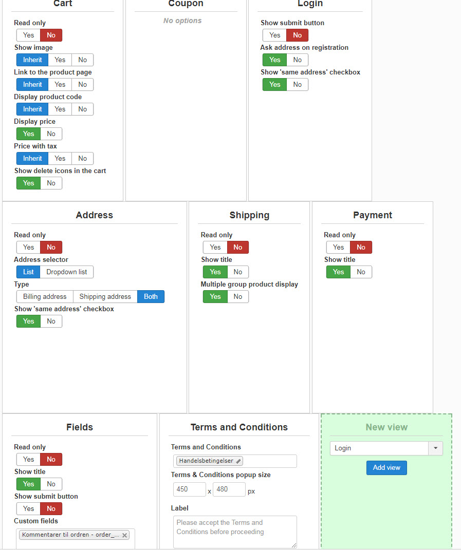

I don't know what error you're talking about so what you're describing indeed look strange. But we would need more precise information (screenshot of the settings under the checkout tab of the HikaShop configuration, precise instructions to reproduce the problem on the website) to be able to provide a more precise answer.

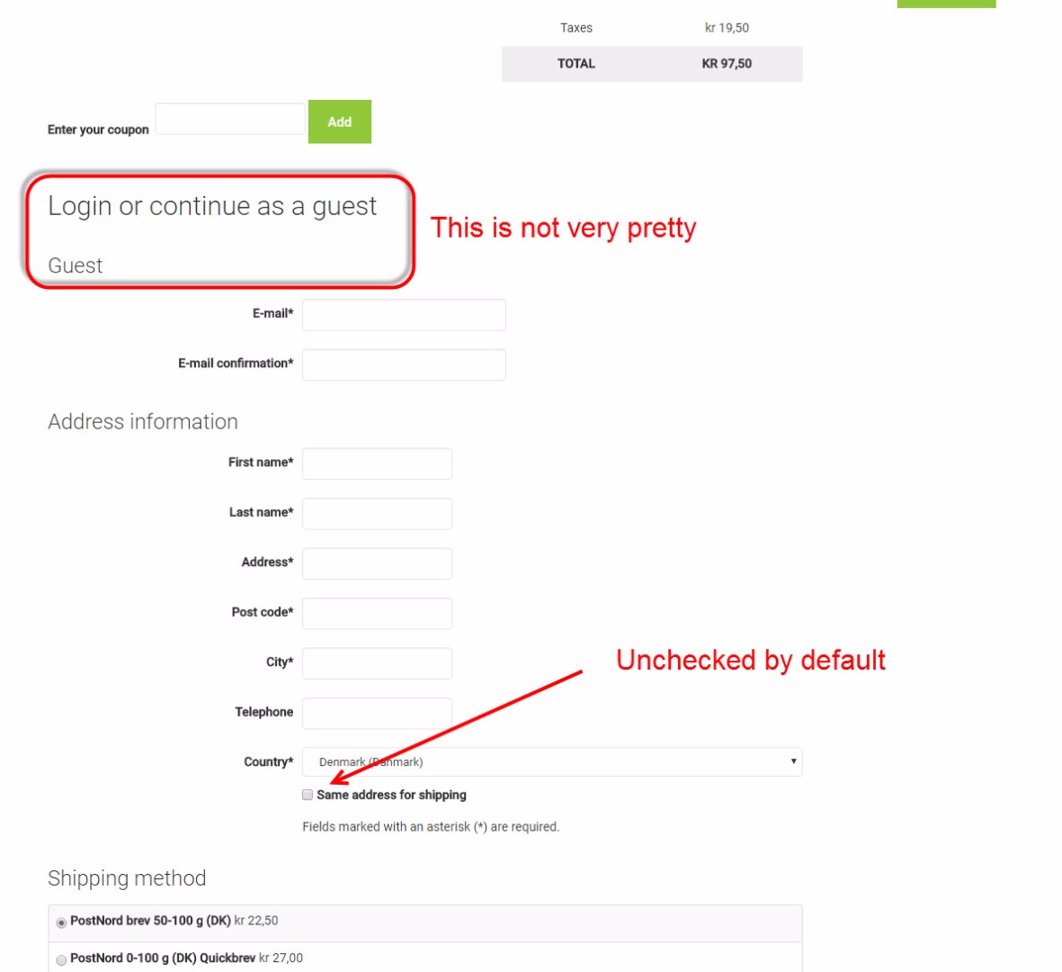

When entering the cart I see this:
If the user wants a separate shipping address, then there are no fields to use for filling this information. The checkbox is not checked, so it should be possible to fill in this extra information.
Only possibility for the user is to continue and press the finish button.

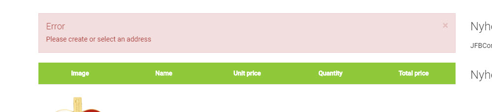

Then this error is shown:
And further down this shows:

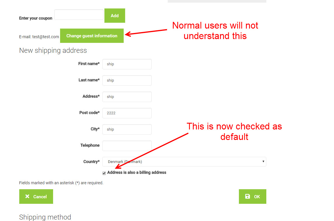

Now the box is checked and this creates now 2 billing and 1 shipping address.
This flow is not very user friendly as it is now.

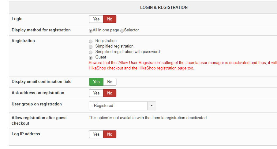

Here are some screenshots of the settings:
