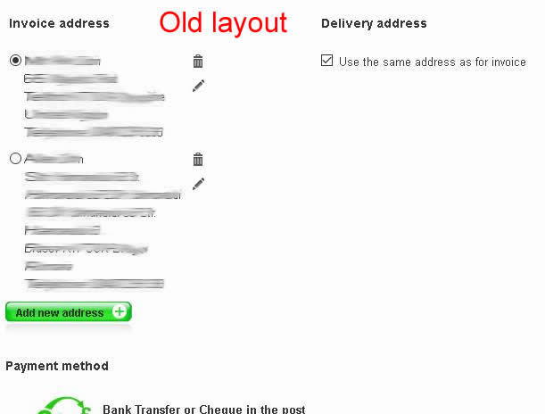

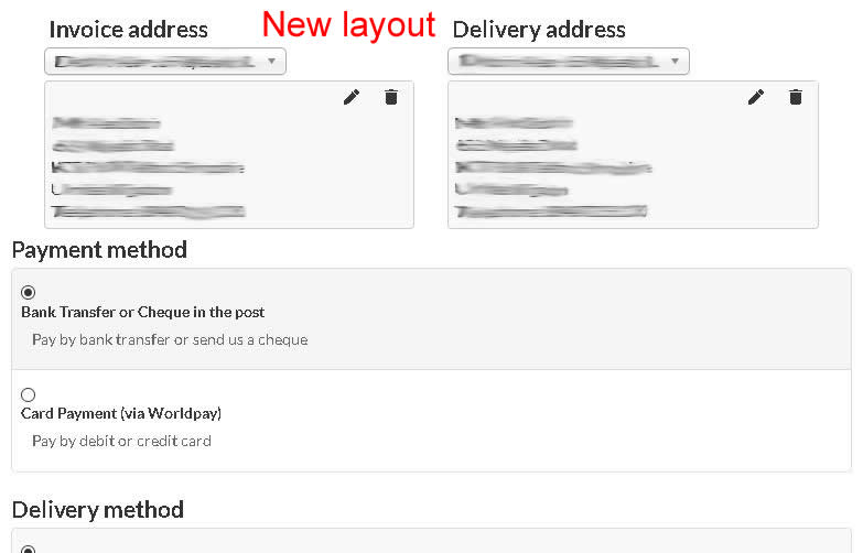

The checkbox "Use the same address as for invoice" disapeared on the new checkout when defining the addresses.
What can I do to put it back?
Thank you!
Old layout:
New layout:

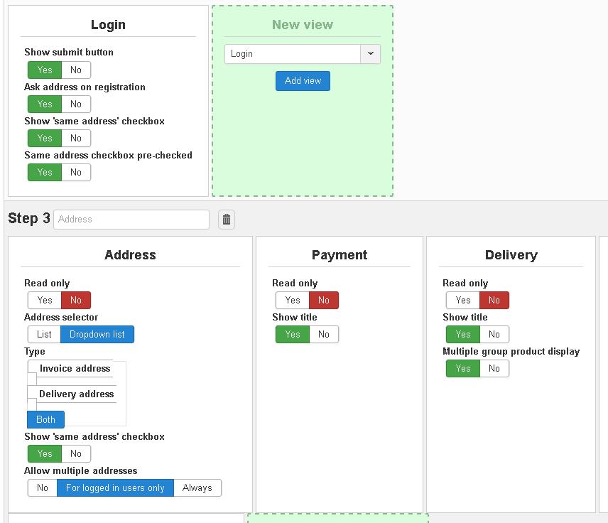

You need to activate the setting within your checkout workflow configuration.
" Show 'save address' checkbox "
  • Posts: 20
7 years 8 months ago #300910
Thank you for your reply.
I'm guessing there is a typo error and you mean :
Show 'same address' checkbox
I had that activated both on "Login" and "Address" sections of the checkout workflow.
Is this a bug or there is something else I need to do?

  • Posts: 26380
7 years 8 months ago #300990
If you really want to get back the old layout ; you need to use the "list" display mode and not the "dropdown" one.
Only in that mode you can have the checkbox (which keep the retro-compability with the previous checkout)

  • Posts: 86027
  • Thank you received: 14172
7 years 8 months ago #301035
You have the "all multiple addresses" setting set to "for logged in users only".
From what I can see on your checkout on your website and what you're describing, you want to set that setting to "always" so that you can actually have a selection between several addresses.
Otherwise, you won't have radios to select between several addresses and only an edit button in order to change the address entered.
Also, you want to have "address selector" to "list" as Jerome said previously, otherwise, you'll have a dropdown instead of radios like you had before.
Now regarding the "same address" checkbox, it's not possible to have it like you had before due to the way the system now works.
The checkbox is now located on the registration form and on the address edition/creation form and when you validate one of these forms, the system will duplicate the billing address as a shipping address but they will be independent of one another as the way it worked before was confusing to many users. The new way it is done is much better based on the feedback we had from many merchants and our internal tests.

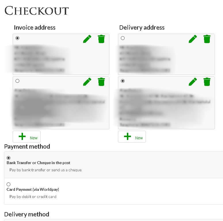

  • Posts: 20
7 years 8 months ago #301133
I thought I was clear when I said I need that checkbox on checkout (not when the user is registering), exactly the way it was in the old hikashop.
I've even added images to show where I need it.
Was this feature removed from this page:
index.php?option=com_hikashop&ctrl=checkout&task=show&cid=3 ?
This is the page I've added screen shoots, but changed the selection of the address from "Dropdown list" to "List" (as suggested).
Isn't is useless to put the checkbox "Same address for shipping" on registration and then on checkout to ask for both addresses again?
What if a user has 5 addresses (or more), all added, and at one order wants to use one address for both billing and shipping and at another wants to use another address for both billing and shipping (and I have this situation)?
Does he has to select the same address twice?
How about on a phone? Do you need the addresses displayed twice and force the user to make the same selection twice? Why?
Anyway, your reply suggest that the feature was indeed removed. I'm surprised I'm the only one that noticed.
