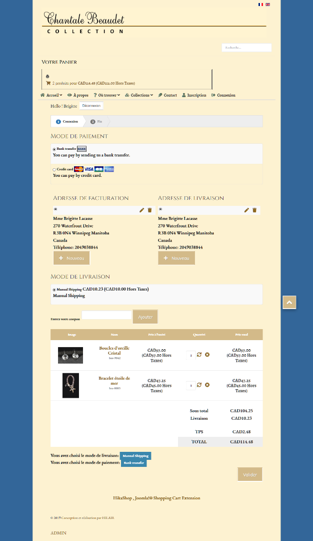

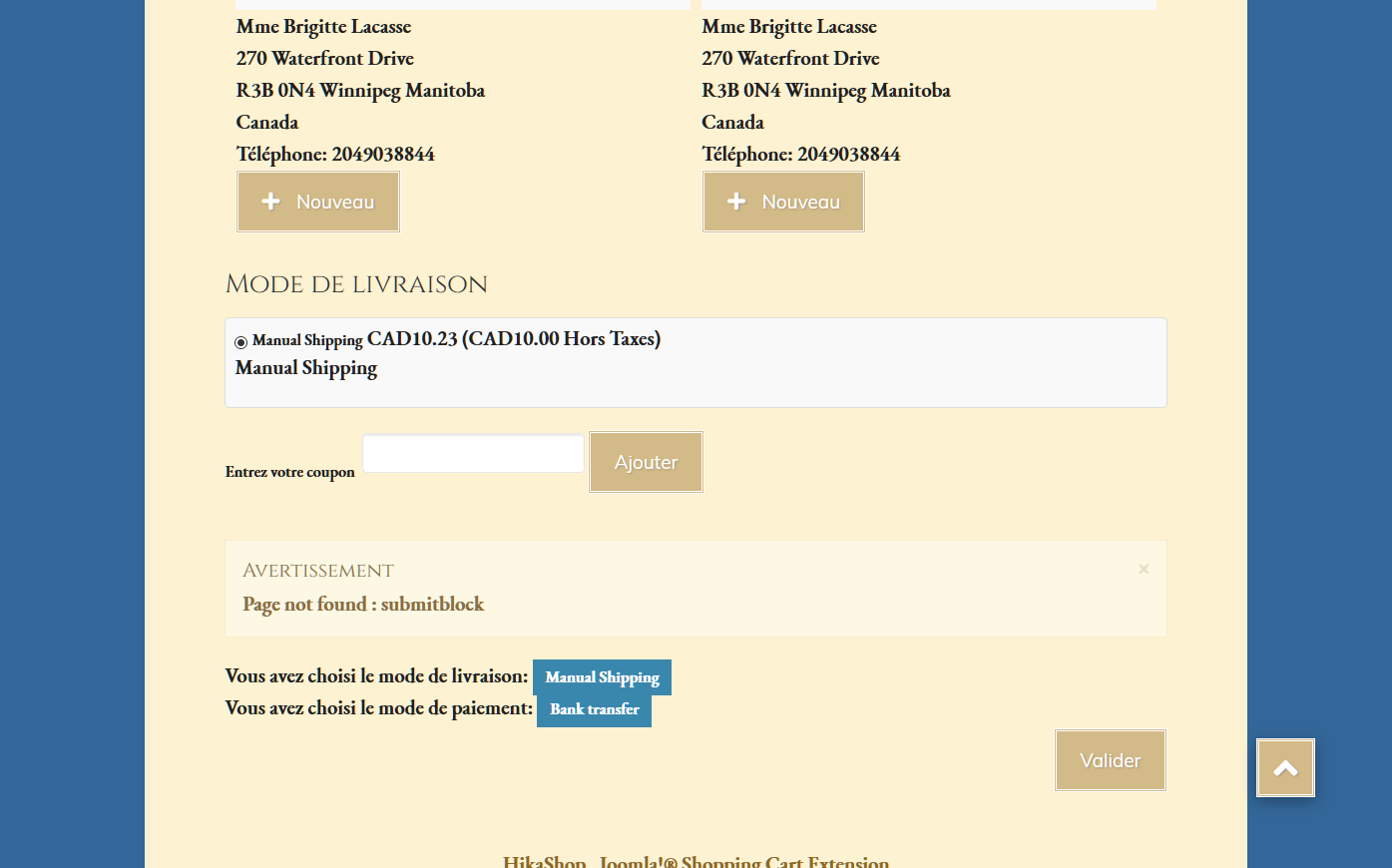

I have upgraded a site I am building for a client to HikaShop Essential.
Only Registered User can order, I have created several users an go through the ordering process.

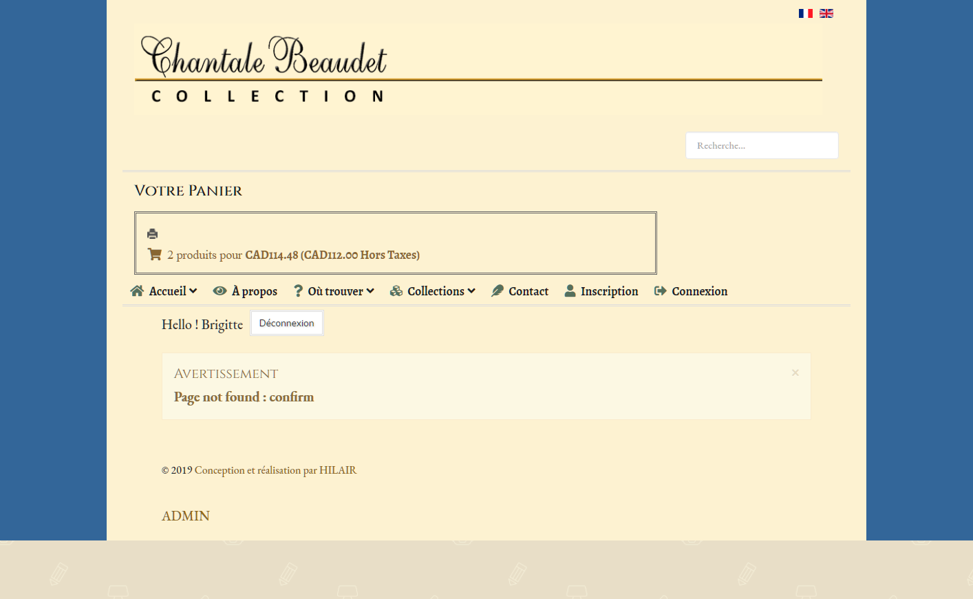

Once I am at the Checkout I cannot submit, I get the message: Page Not Found: Confirm
Also If I try to change the quantity I get the following message:
Page Not found: Submitblock
Please see snapshots.
The site is bilingual, English/French using Falang.
Also I have 2 shipping methods; Manual And CANPAR, the CANPAR does not show as an option when ordering.
I would appreciate some help, I have been trying to change several parameters without success. I know it must have worked before because I can see 2 order placed back in August.
Thank you in advance

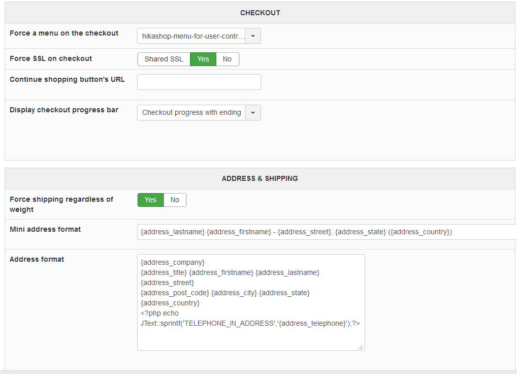

  • Posts: 36
7 years 7 months ago #302138
Solved the first part of my problem by entering NONE to Force menu on checkout in the Checkout configuration.
Still cannot understand why I do not get a choice for CANPAR

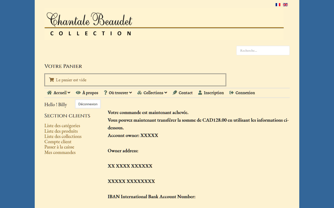

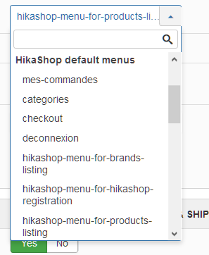

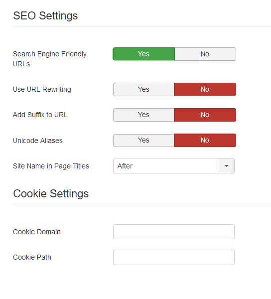

  • Posts: 36
7 years 7 months ago #302155
Thank you for your prompt reply! I have done some testing and here are my findings:
My SEF settings are SEF YES
Use URL rewrite NO (When I tried to to put it yes several pages were not available)
Add Suffix to URL NO
Now for the checkout force menu, I tried several menus, You can see some of my options in the screenshot XX.
The Choice None, Mes Commandes, Deconnexion worked but brought to the page you can see on screenshot YY .
The choice HIKASHOP.... User Control Panel is the best and takes me to the page ZZ.
I hope this is useful, if not tell me what more do you need.

  • Posts: 86027
  • Thank you received: 14172
7 years 7 months ago #302159
So, using "User control panel", does that means that the checkout is working ?
Do you have any kind of redirection system, like in your htaccess, or a SEF/SEO extension ?
Also, you didn't provide precise instructions so that we can reproduce the problem on your website. Could you do that ?

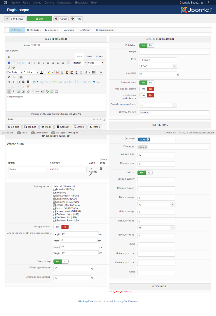

Could you provide a screenshot of the settings of the CANPAR shipping method ?

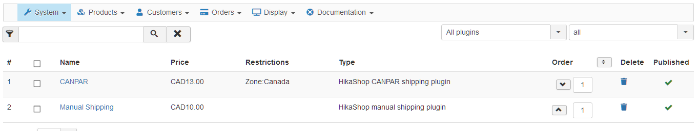

  • Posts: 36
7 years 7 months ago #302180

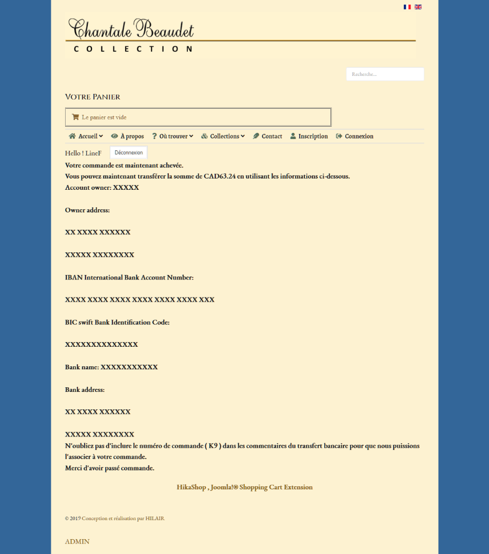

YES, using User Control Panel the checkout works and the user is redirected his/her control panel as is shown in the screenshot : Screenshot_2019-01-04 Compte client-ZZ attached to the previous message.
I do not have any redirection nor a SEF/SEO extension. The site is in a subdomain and the URL points to that subdomain directly.
The instructions are pretty simple since I used all the parameters in the system:
HIKASHOP Configuration
Checkout tab
Checkout workflow: kept the flow as provided by the system
Checkout
  1. Force a menu on the checkout .......This where he problem was, I had categories
  2. [Force SSL on checkout .... YES
  3. Continue shopping button's URL ... Blank
  4. Display checkout progress bar ... Checkout progress with ending
Address and shipping: kept the parameters of the system
Login and Registration: kept the parameters of the system

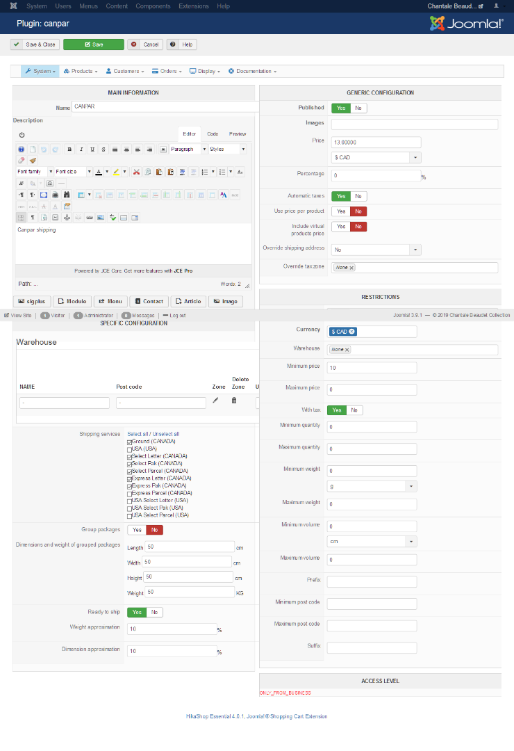

Attached is the CANPAR plugin snapshot

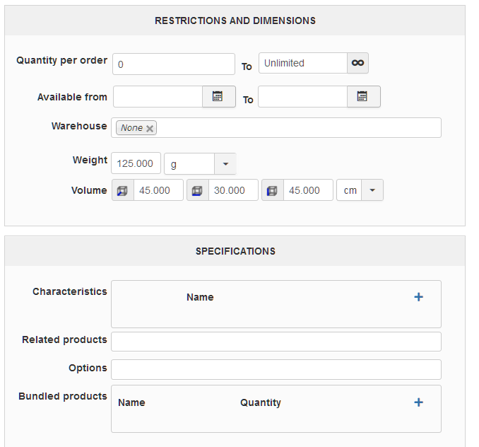

  • Posts: 36

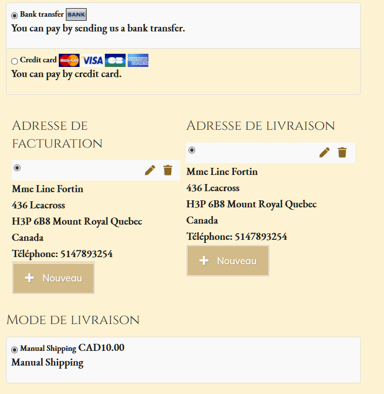

7 years 7 months ago #302242
I have read the Shipping document in the FAQ and I can tell you that the manual shipping method works, it shows on the checkout (see screenshot attached).

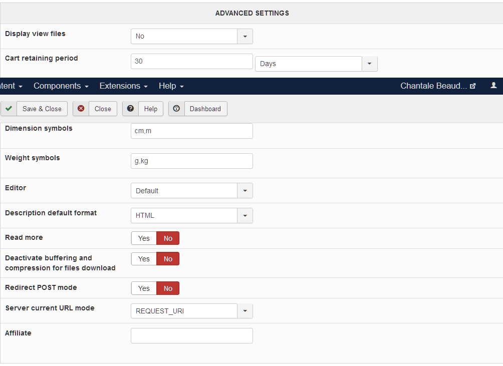

All products have weight (gm or kg) and dimensions (cm or m), These are defined in the display configuration and show in the CANPAR configuration.
I have NO RESTRICTIONS. ( I tried all sort of permutations with or without warehouse, with or without zone
The min and max quantities are set to 0
I am attaching the current CANPAR configuration as well as a partial view of a product and the advanced configuration showing the measurements I use
Are you aware of anybody that has used this plugin successfully?

  • Posts: 36
7 years 7 months ago #302303
Thank you for coming back to me.

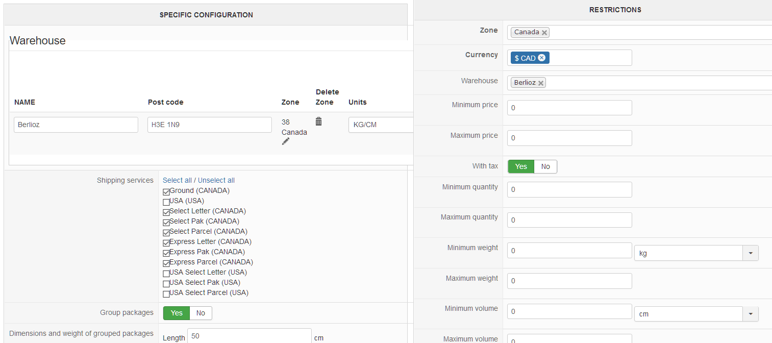

I have created 2 warehouses, Berlioz & Laval .
Added Berlioz in the specific configuration .
In the restrictions I have :
Zone: Canada
Currency: CAD
Warehouse: Berlioz
See screen shot with all this
I have also put Group Packages to YES
I noticed that in the specific configuration I cannot add another warehouse and what I enter there does not seem to related to the warehouse I created.
Also the Units KG/CM are in Capital letters ( I do not know if this is relevant)
Tried it and still does not work

7 years 6 months ago #302419
The issue in your configuration was coming from the fact that you have edited the "Canada" zone configuration and changed it to a "Shipping" zone instead of a "Country". So I just reverted your changes so that you customers will at least be able to select a Canadian shipping address to have their product shipped.
However Canpar shipping services were still not available. contacting the original developer of the CANPAR shipping plugin can be a good solution.
CF : github.com/HikaShop/hikashopshipping-canpar
