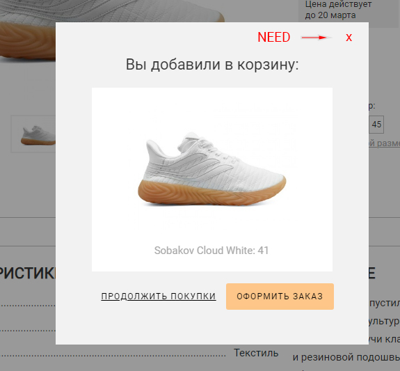

Hi! Please tell me how to add a pop-up button to Close the window VEX

There is already a close button by default on vew popups:
monosnap.com/file/ppjuFVVYP4dDnyPRq6PSRJda1HbNyT
If you don't see it, it probably means that you have custom CSS to hide it.
Otherwise, it could also be that you didn't set the showCloseButton parameter of vex to 1 when you initialized your vew popups.

Thank you! That's right, I'm using the vex dialog on frontend, and the default setting is showCloseButton of vex set to 0. Please tell me how to initiate it to 1?

Well, how do you add that vew popup ?

The pop-up window is called by the plugin "HikaShop Card notification Plugin" method popup, by clicking on the " Buy " button in the product card

Then try adding the code:
vex.defaultOptions.showCloseButton = 1;
after the code:
vex.defaultOptions.className = "vex-theme-default";
in the file plugins/hikashop/cartnotify/cartnotify.php

Thanks Nikolas! I understand the principle and read the documentation github.com/HubSpot/vex/blob/29b137d92b18...ex.dialog.coffee#L42 found that correctly you need to specify with DIALOG
vex.dialog.defaultOptions.showCloseButton = 1;
