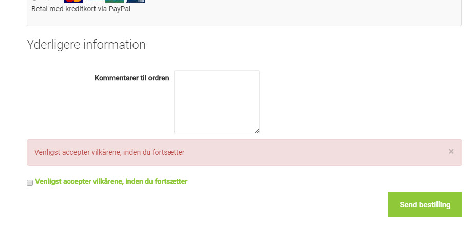

I have a one-page checkout process.
The last field before the Buy button is the Terms and conditions.
If a customer forgets to check the Terms and conditions box, then the page is reloaded and scrolled to the top of the page.
The error message indicating that something went wrong is next to the terms and conditions box at the bottom of the page.
How do I either get the error message to the top of the page or preferrably stop the page from scrolling up/reloading if the terms and conditions is not checked?
I have tried with the default joomla template, and the same error occurs.
Rgds
Jacob
7 years 3 months ago #306088
I think that you can adjust this with some Css, see my screenshot :
To detail the Css code, you have :
- position: absolute;
=> Here, you fix a definitive position for your error message.
- top, left & width are to be define to fit your needs and the right position in your case
=> Don't forget to add some command to work as well for responsiveness.
Example :
div#hikashop_checkout_terms_1_5 div#hikashop_messages_error {
position: absolute;
top: 47px;
left: 34.3%;
width: 380px;
@media (max-width:768px) {
position: absolute;
top: 47px;
left: different value to fit the new context (screen size);
width: different value to fit the new context (screen size);
You will learn more about @media, here. www.w3schools.com/cssref/css3_pr_mediaquery.asp

  • Posts: 86
7 years 3 months ago #306095
The errormessage should be posted next/above to the field causing the error.
And the page should scroll down to the first error. This would be the way to do it (in my humble opinion)
Rgds
Jacob
7 years 3 months ago #306101
My answer was a custom to match your needs, and not a general solution for everyone.
So far, their is no easy and quick solution to implement solutions.
The anchor system can be indeed a solution but this can be complicated and take time to implement.
You ask us to have the error message directly when the page is refresh that the most direct solution.
But we know that you have to set yourself position for several screen size via @media, also think that for values you can use values in %.
Plus, note that many form proceed like this, to have error message on header, that invite customer to check the whole form.
But we get your point and add an anchor system, this won't maybe be the next release but quite soon in our HikaShop future release.
Last edit: 7 years 3 months ago by Philip.
