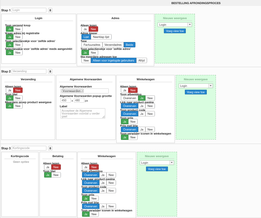

Hi, I have the same issue. In checkout there is no redirect to Paypal nor Ideal. But after selecting the shipping, and the payment options, the enduser is shown the " end & confirmation"
The default order status is set on "created"
Also, no order is created and no confirmation is sent by email.
attached you see my checkout schedule
I use Joomla versie, 3.9.10.
Hikashop essentials 4.1.0
any help is welcome!
