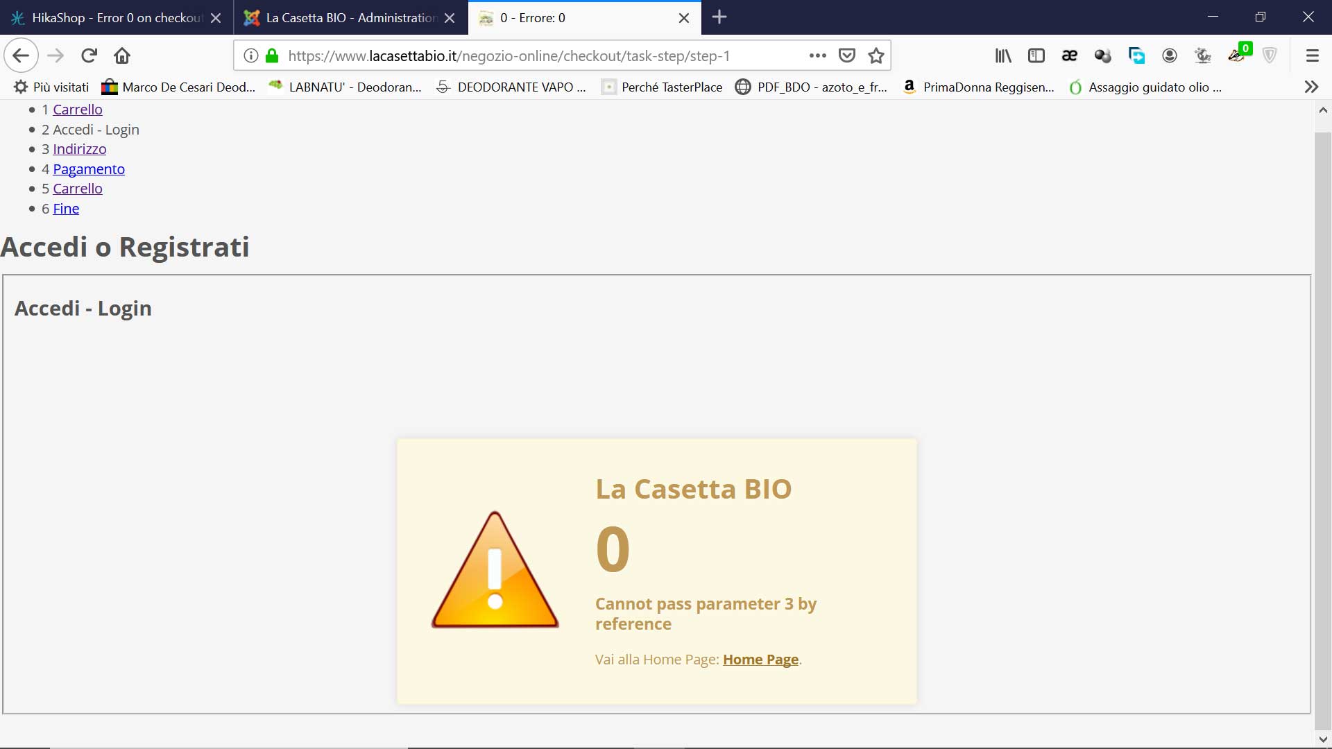

Hi, in my Hikashop configuration, on Checkout and "Login & Registration" I have "Login" set to yes.
From a few days, when you go to the checkout and go to the "Login & Registration" step you have an issue: a page with error number zero and Cannot pass parameter 3 by reference.
If I set the configuration Checkout, Login & Registration, Login to NO.
There is no issue.

  • Posts: 719
6 years 10 months ago #310950
thanks for your help.
After enabled the debug mode and error rport I have not other error message.
You can see my issue from my screenshot1

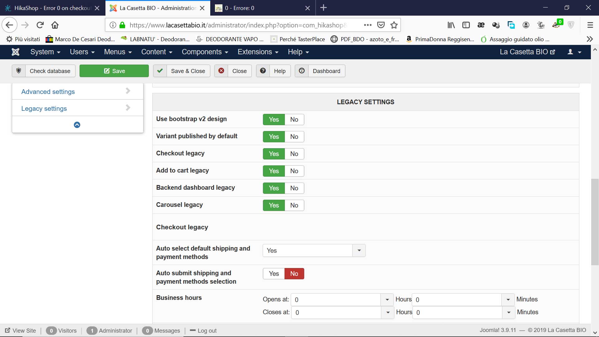

Also, about the legacy mode on checkout, I have not the select on my form.
You can see that from my screenshot 2
my site with Hikashop
www.lacasettabio.it
  • Posts: 86027
  • Thank you received: 14172
6 years 10 months ago #310963
The checkout legacy is activated as far as I can see. Otherwise, you wouldn't see the other checkout options below the "checkout legacy" setting and you wouldn't get that error.
However, it seems that the option to deactivate the checkout legacy has been removed from your HikaShop configuration on your website for some reason (there is no way to remove that yes/no option unless the view file displaying that area has been modified).
So you could always look in the hikashop_config table via your phpmyadmin from the entry with the namekey checkout_legacy and set it to 0. But the person who did that change might have had a reason for removing the option. So you might want to check with that person.

  • Posts: 719
6 years 10 months ago #310988
I suppose that there was an oversight.
The option to disable the checkout legacy is on the third row of my screenshot.
So, now I've disabled all the legacy options and the site seems to work fine.
