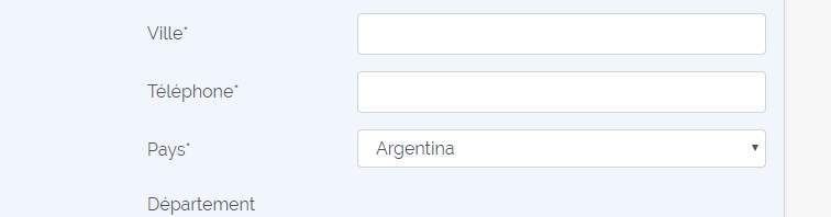

I have a multilingual website with multiple countries in de checkout. I have the Netherlands selected as default in the country custom field. But when I go to the checkout always the first country (Argentina) from the list is selected.
could you tell me how to force the default country?

Thanks for the answer!
Prior to my question I already did test the setting, as I stated in my primary question! But the selection is not respected in the frontend.
That's the problem. Seems like a small bug...

6 years 11 months ago #311920
Still no luck. I saved the custom field value again and the default tax category is set to Netherlands. Argentina is still selected.
For the time being I have set the "Add a 'Please select' value" to Yes so no country is selected.
Do you have some other ideas how to make this work?
