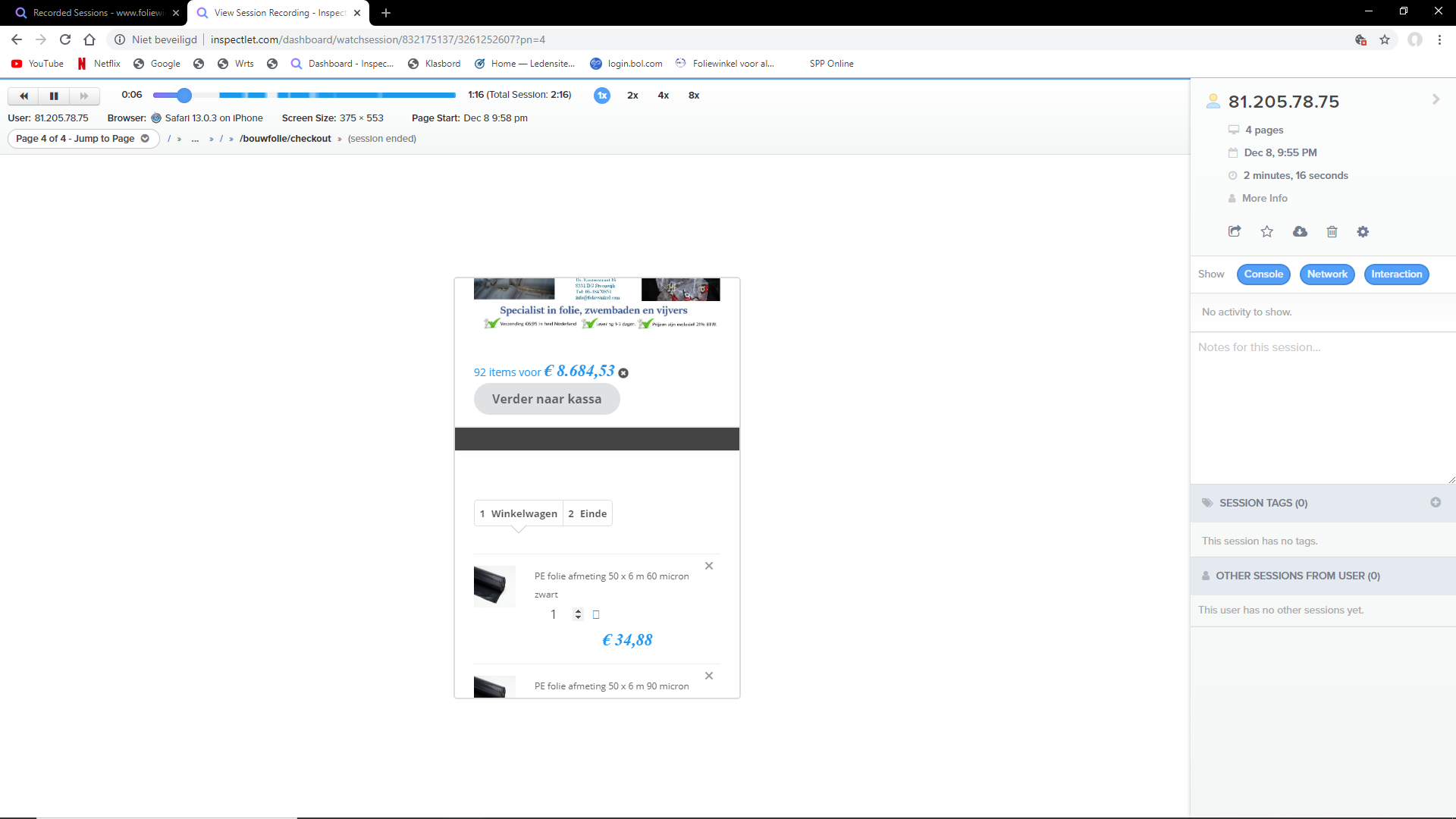

since a few days I notice that when a customer goes to the checkout there are already a lot of items in the shopping cart and therefore a lot of around € 8000, - why this happens is a mystery to me.
Someone an idea, it is not because the customer has put so many items in his shopping cart.

Okay unfortunately that did not work, it appears that especially with mobile devices the shopping cart is not emptied for a next customer

Are you talking about this plugin ?
extensions.joomla.org/extension/jamp/
Using that extension to fix the width of address input fields on mobile is definitely not a solution.
Normally, you should be able to fix this with a bit of CSS.
JAmp generate static pages. So this won't work properly with ecommerce solutions which need to display dynamic elements on the pages (like the cart, the checkout, etc). So it's indeed probably that extension causing the problem.
If you have an issue with the width of address input fields on mobile, then please provide a link to the shop so that we can check on the situation and tell you what to do.
