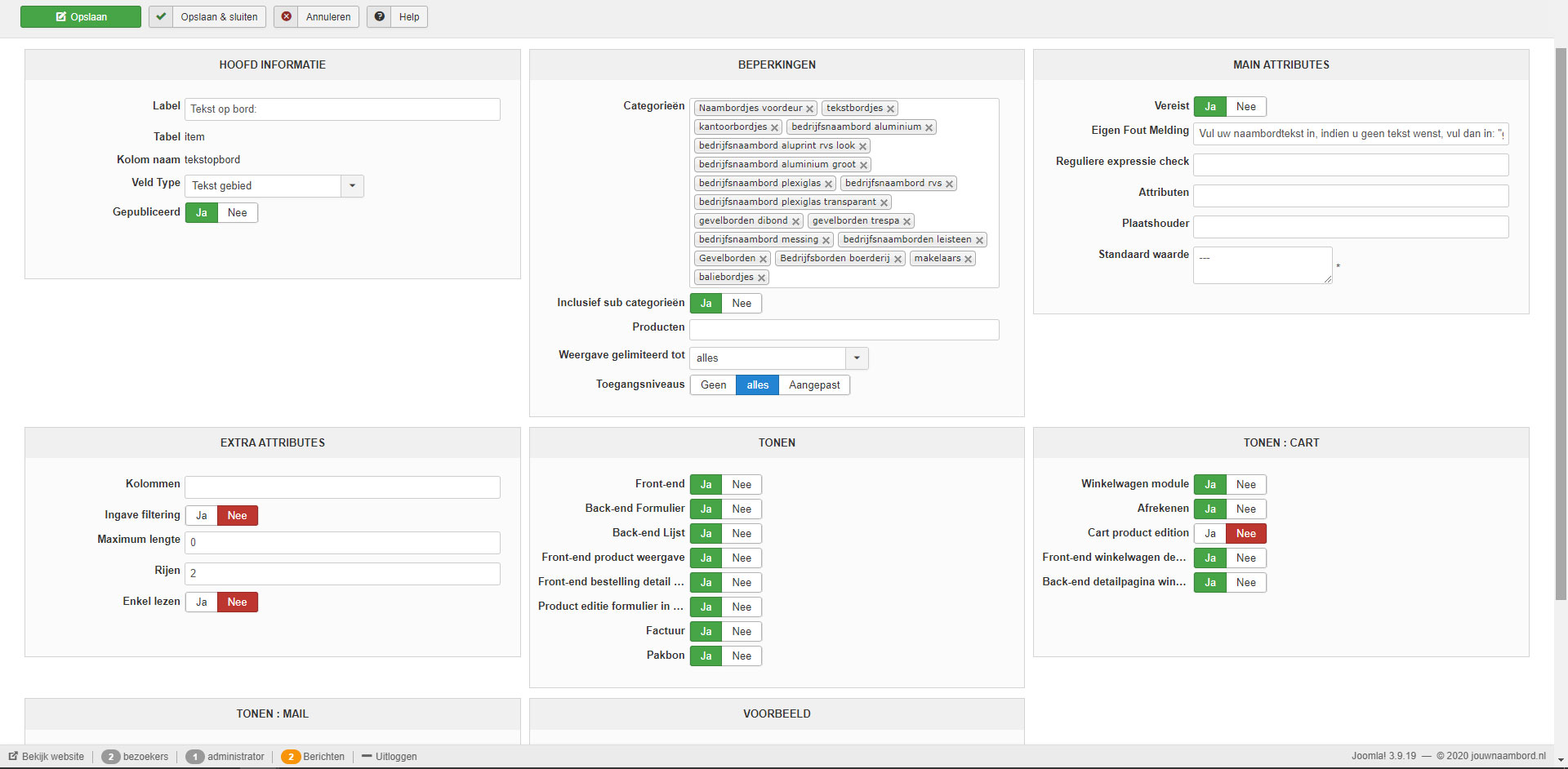

5 years 11 months ago #320858
Hi Philip,
Already checked the database and resaved the custom field, emptied all cache and browsercache. The issue is still there. Here's the screenshot.
  • Posts: 85712
  • Thank you received: 14048
5 years 11 months ago #320872
I think I've found the issue and added a patch for that. Please download again the HikaShop 4.3.0 install package and install it on yours and it will add the patch for that issue.
