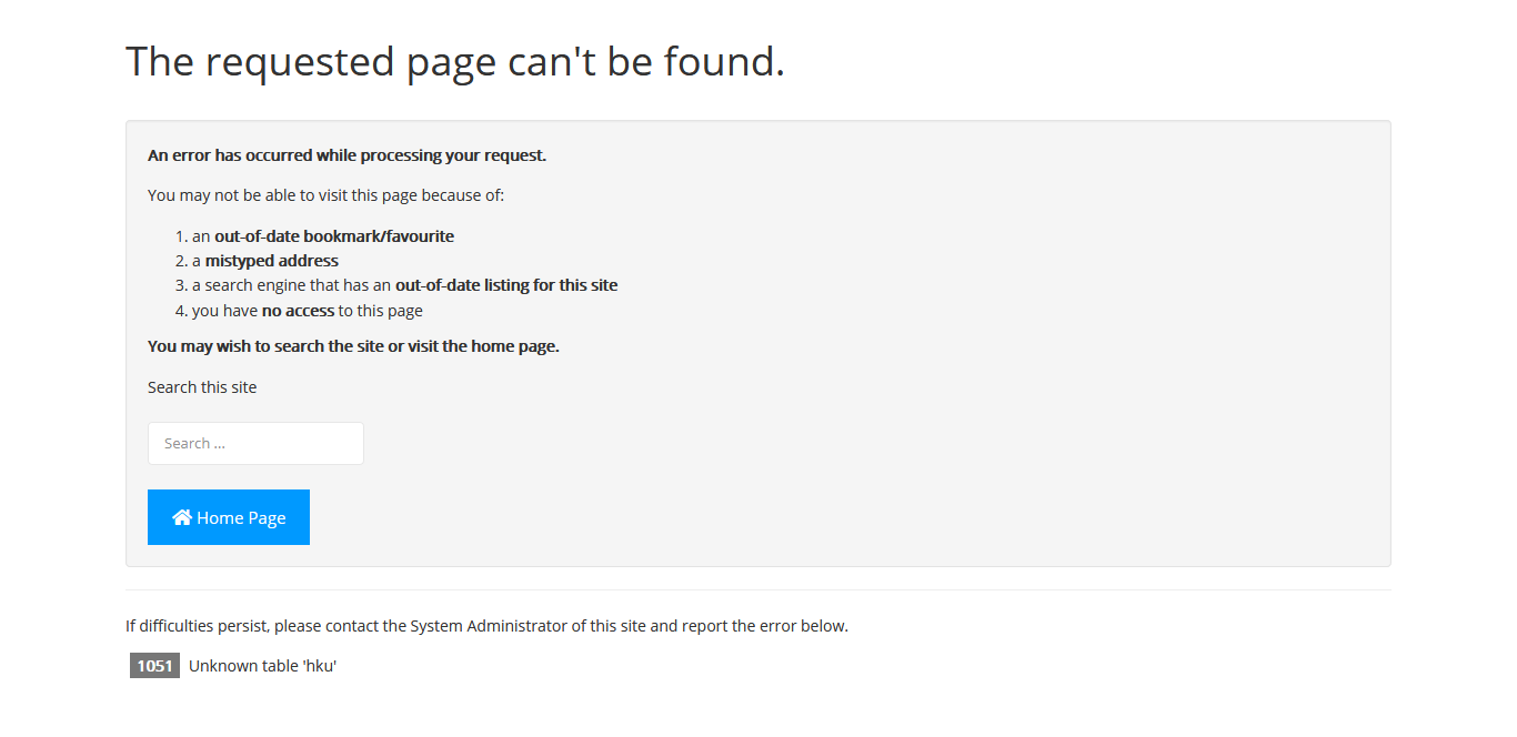

-- Error-message(debug-mod must be tuned on) -- : Error 1051
Testing my store now. I have Stripe Connect V3 installed. Not sure if it's configured correctly, but when I tried to do a test checkout, I got an Error 1051.
I took a screenshot of the page.
Please advise.

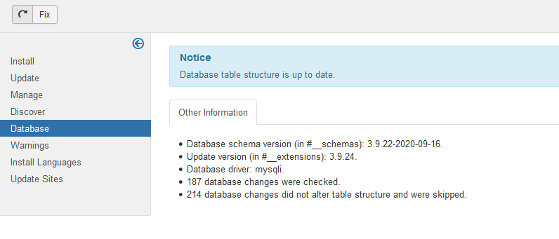

UPDATE: Just checked the database via the Joomla backend. According to that, there are no issues.
I REALLY need to know why your component is doing this, and how to fix it.
ADDITIONAL UPDATE: I have tried to repair the database. There are no errors.

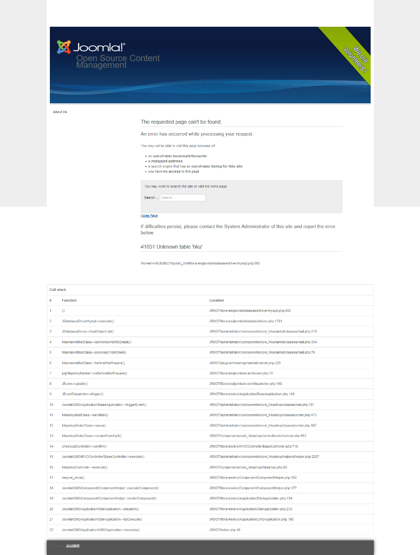

5 years 5 months ago #329652
Sure. What part do you need to see?
  • Posts: 86027
  • Thank you received: 14171
5 years 5 months ago #329658
Just activate the "debug mode" setting in the Joomla configuration. Then, go to the checkout again where you had the error 1051 and do a screenshot of that page. You'll that the error message contains more information as well as a "call stack" which we need to understand what is the problem. From there, we can tell you what to do.
  • Posts: 324
  • Thank you received: 4
5 years 5 months ago #329661
Hi again,
Thanks. I had already posted to another thread.
As mentioned there, this is happening on more than one site, with different templates and different components and plugins.
The common thread is Hikamarket, so I am pretty sure this is related to that component.
I was going to rebuild the whole site, but since it does seem that this is a bug, I don't want to take the time to do that if it's just going to give me the same error.
Screenshot is attached. I have also created an Admin account and can send details (again) if you need to access that.
  • Posts: 26380
5 years 5 months ago #329664
Please re-download HikaMarket 3.1.1, the package will update your website and force the application of the fix for the HikaMarket mail class.
