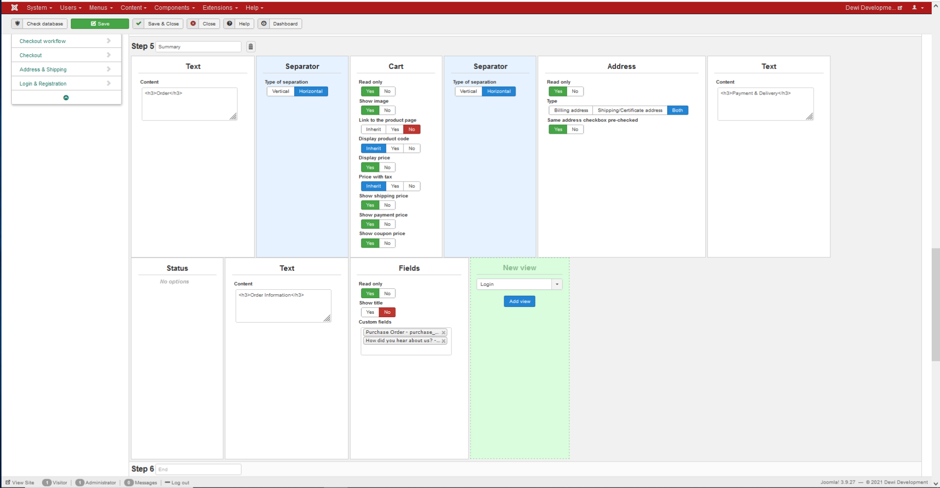

As part of the checkout, I have set up a summary as the last page. Everything is read-only.
The last piece of information is displaying custom fields utilising Fields. When set to read-only, the labels show but not what they set. If you turn off read-only, the label and information show.
4 years 11 months ago #333604
Can you provide an Url link as a start of a step by step process in order to see the issue.
And your relative checkout workflow step (complete settings screenshot).
These elements will allow us to better analyze the situation and process some tests.
Awaiting your elements to progress on your subject.
