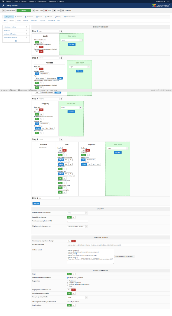

Could you please provide a user account so that we can try and a screenshot of the "checkout workflow" you have under the Checkout tab of the HikaShop configuration ?

  • Posts: 190
4 years 11 months ago #333849
I have added a screen shot. Hope it is not too much information. :-)

4 years 11 months ago #333851
Your settings look fine so I don't see why it would do that.
We'll need a backend access and a FTP access to be able to understand what's going on.
Could you please provide that via our contact form along with a link to this thread ?

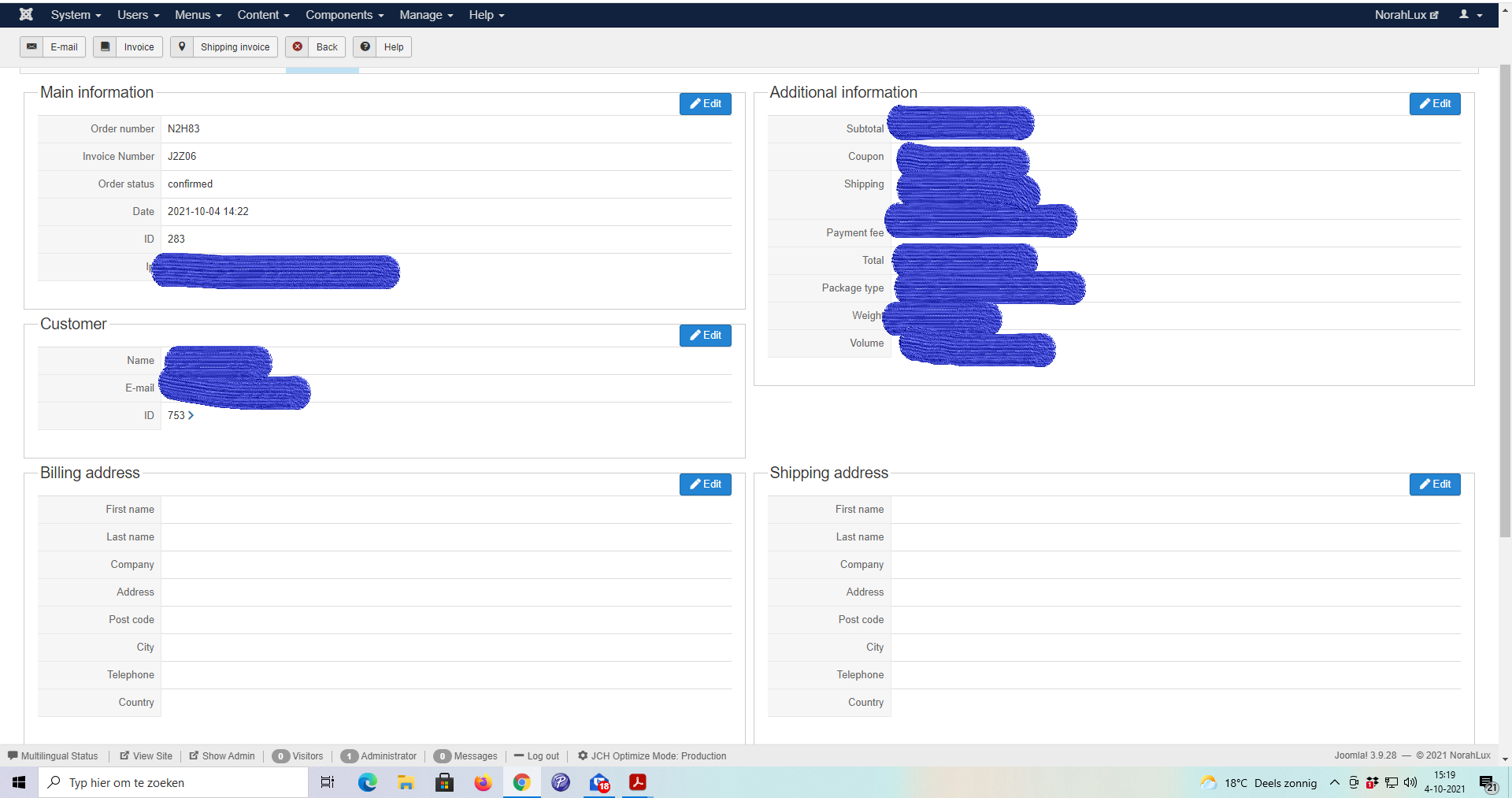

  • Posts: 147
  • Thank you received: 8
4 years 8 months ago #336074
I can not replicate it easily in a sense that i can tell you 'do exactly this'.
What i can tell you is:
This always only happens when someone uses 'register' instead of 'guest'.
They get a name and a nickname, and trying to finish the address details they get stuck in a loop.
They can not finalise the address details (next button loop) or pay.
I get these details from customers, so that's all i can give as detail.
When i register a testaccount it usually works, yet i know what i'm supposed to fill in so maybe they fill in some, or keep out, a details which is important for the system to loop instead if pointing to the mistake.
**update**
Coincidentally someone just placed an order without any address details, i did not even know this was possible, if i try this it will say i need to fill all this in.
Kind regards,
Nico
Last edit: 4 years 8 months ago by NicoW. Reason: New order placed
