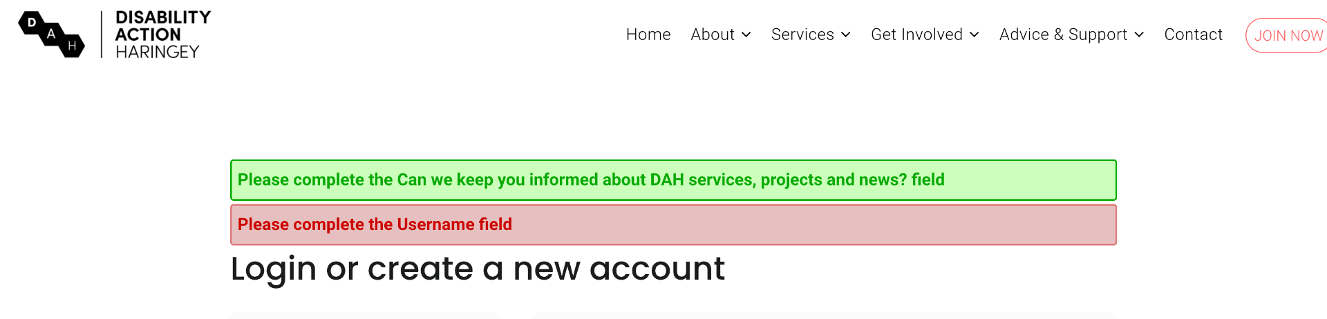

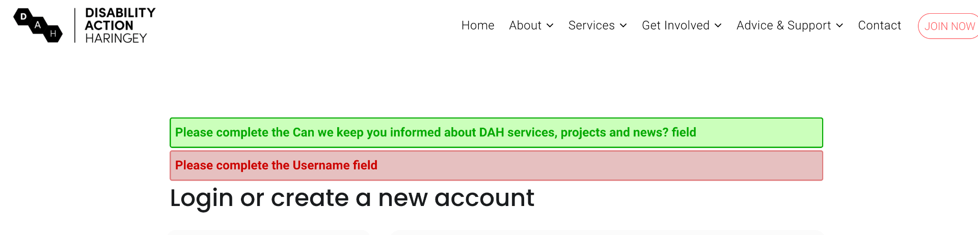

Is it possible to make the page go to the top when the registration form is filled out incorrectly. This is so the user can easily read what they did wrong - see attached.

If I don't fill anything on the registration form and click on the register button:
i.imgur.com/5azFlRD.png
I am automatically brought to the top of the login form with the error messages:
i.imgur.com/owsVend.png
That's a mechanism we've added in the HikaShop checkout specifically for that.
However, you have two problems on your website:
- Some of the error messages are green instead of red, and thus are not counted as errors by the system and thus it doesn't scroll up to them. That's something we've fixed on our end. It would require updating your HikaShop to get the patch for that.
- Your template has made its menu bar sticky to the top and thus the first 2 error messages are hidden below that menu bar. That's tricky to give a good solution to that. Scrolling to top might risk loosing the customer too as the top might be far from where the error message is. That's actually something we changed a few years ago to improve the checkout, especially on mobile devices.
