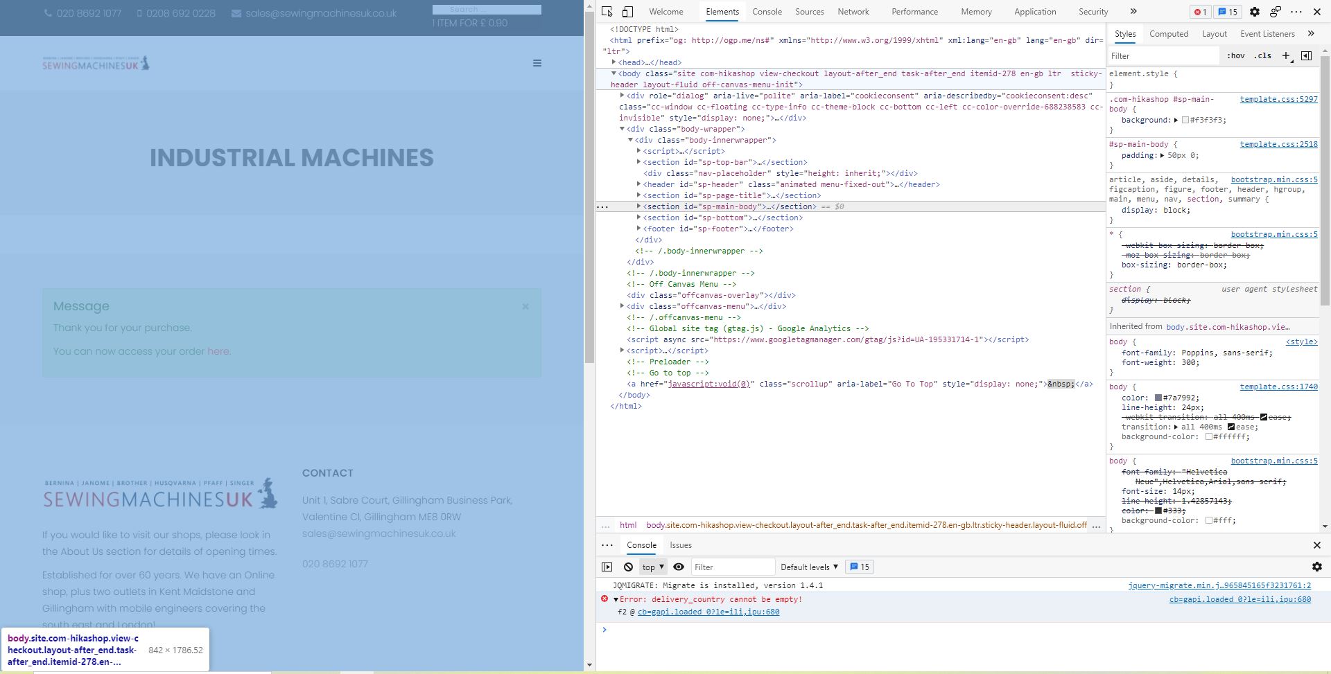

Hey! I Finally got around to implementing this code and am having just one error occur on the page, it just states:
"Error: delivery_country cannot be empty!"
As you an see in this screenshot.
This is the line I'm using to draw the country
"delivery_country": "<?php echo $this->order->shipping_address->address_country_code_2; ?>",
I'm just wondering if it's wrong in some way. This is just a line that I saw someone else using years ago, so it may not be relevant to my site.

4 years 10 months ago #334557
This would happen if you disabled the "address_country" custom field in the menu Display>Custom fields.
A sure way to get the country code would be:
<?php
$country_code = 'UK';
if(!empty($this->order->order_shipping_address_id)) {
$addressClass = hikashop_get('class.address');
$address = $addressClass->get($this->order->order_shipping_address_id);
if(!empty($address->address_country)) {
$zoneClass = hikashop_get('class.zone');
$zone = $zoneClass->get($address->address_country);
if(!empty($zone->zone_code_2)) $country_code = $zone->zone_code_2;
echo $country_code;
