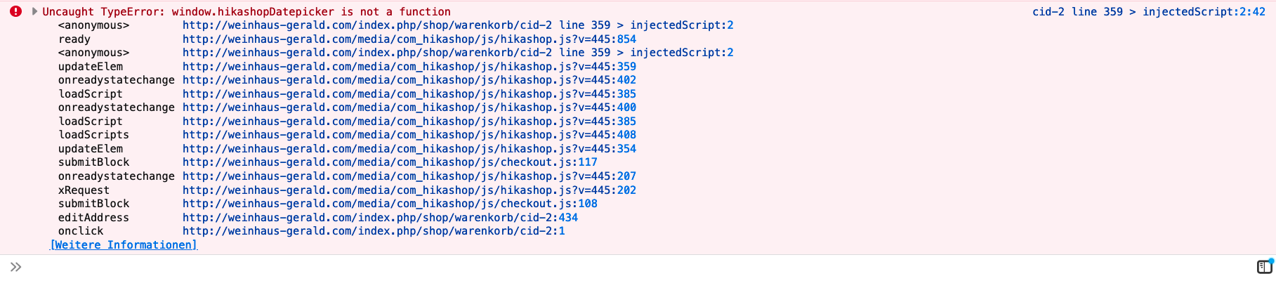

I try to use the advanced datepicker but the javascript console says "window.hikashopDatepicker is not a function"
how can I fix / debug that?

Please can you provide these elements in order to better understand the context and when the error emerge :
- Step by step process (in order to try to reproduce the issue)
- Screenshot of the error (with the Joomla Debug switch On AND in level development)
- Precise your Joomla/HikaShop/Php versions.
Awaiting your element to be able to progress on your subject.

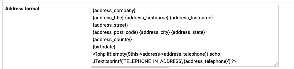

Hi Philip,
My step by step process is as described here: (I used the php solution)
www.hikashop.com/forum/install-update/89...checkout-solved.html

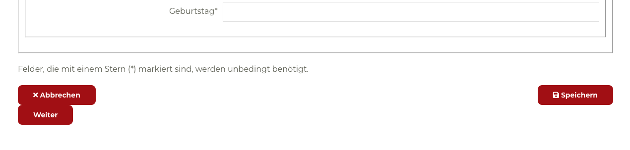

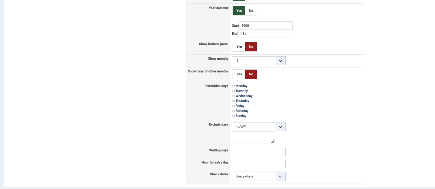

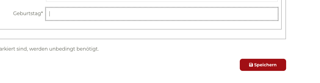

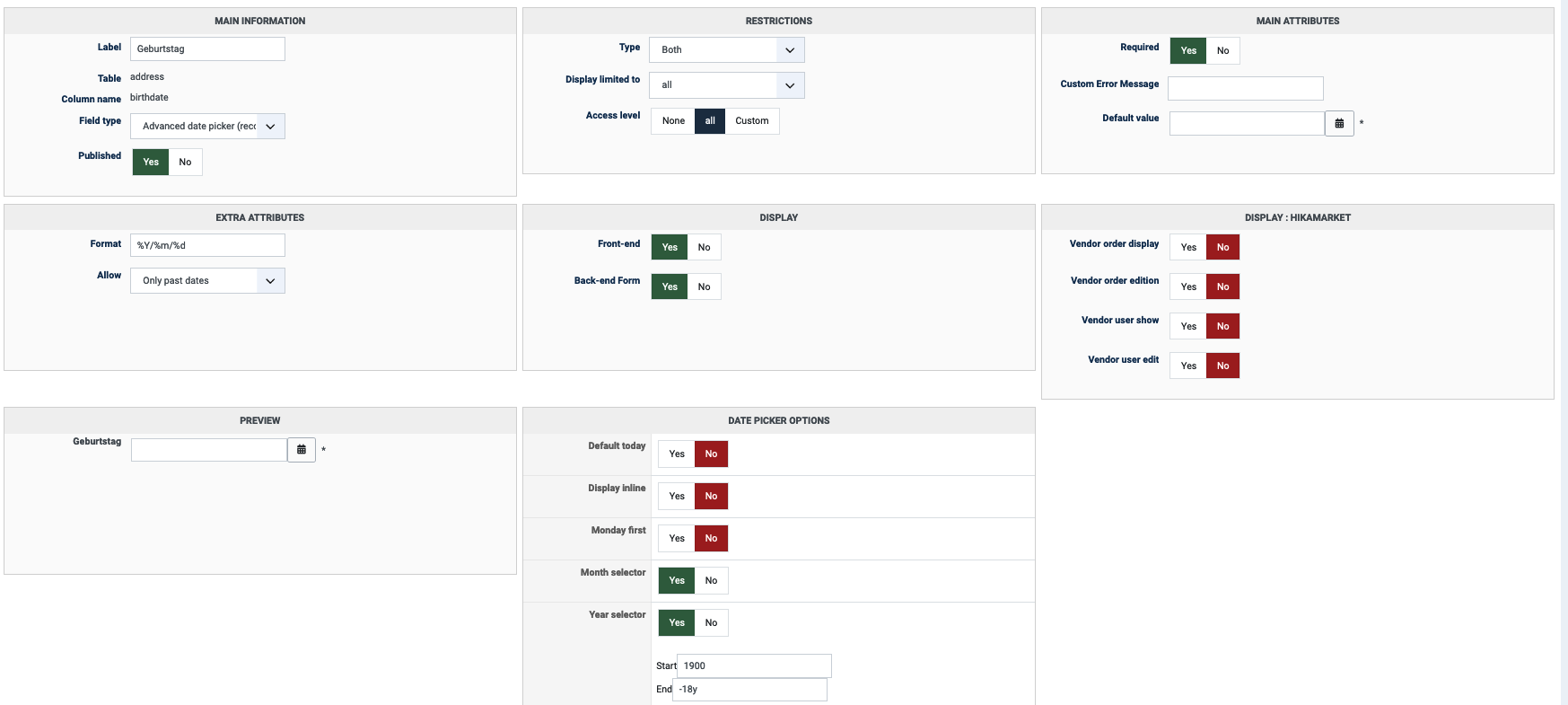

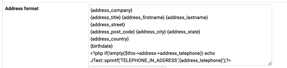

I attached the settings of my custom field and also in the checkout, and also how the field looks like in frontend and the error (See attachments)
It's Joomla 4.0.5 and Hika Shop Business 4.4.5 and PHP PHP Version 7.4.x

4 years 6 months ago #338751
We process some tests on your website and where able to use as expected your advance date picker (birthdate) in your checkout.
Now let's be clear... If you ask why that didn't working that will be hard to say...
Basically I process some settings/save tests, and that's all.
Sometimes for a reason or another when a custom filed is created something went wrong while saving process (and sometimes while updating HikaShop), and just save again entries can solve these kind of issue...
Hope this will allow you to achieved your needs anyway.
