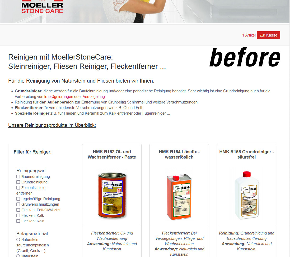

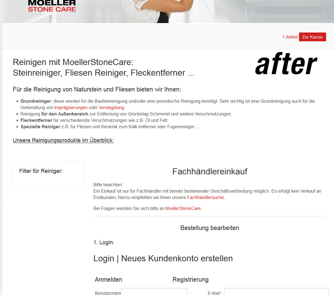

if I select the checkout on the product overview, then the checkout area is embedded in the product overview. i.e. all modules (filters, headings, etc.) are still displayed.
How can it be set that the "Checkout button" leads to an extra page where only the checkout area is displayed. This works beautifully when I go to checkout from a single product page, but not from the product overview.
Thank you in advance for your feedback
