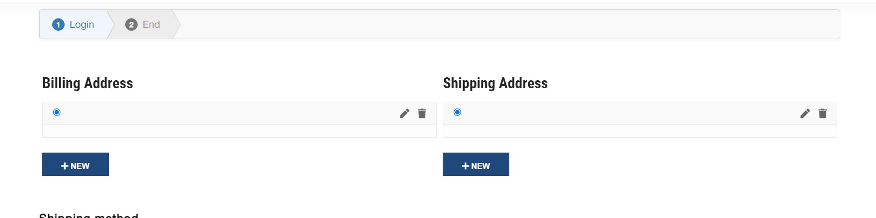

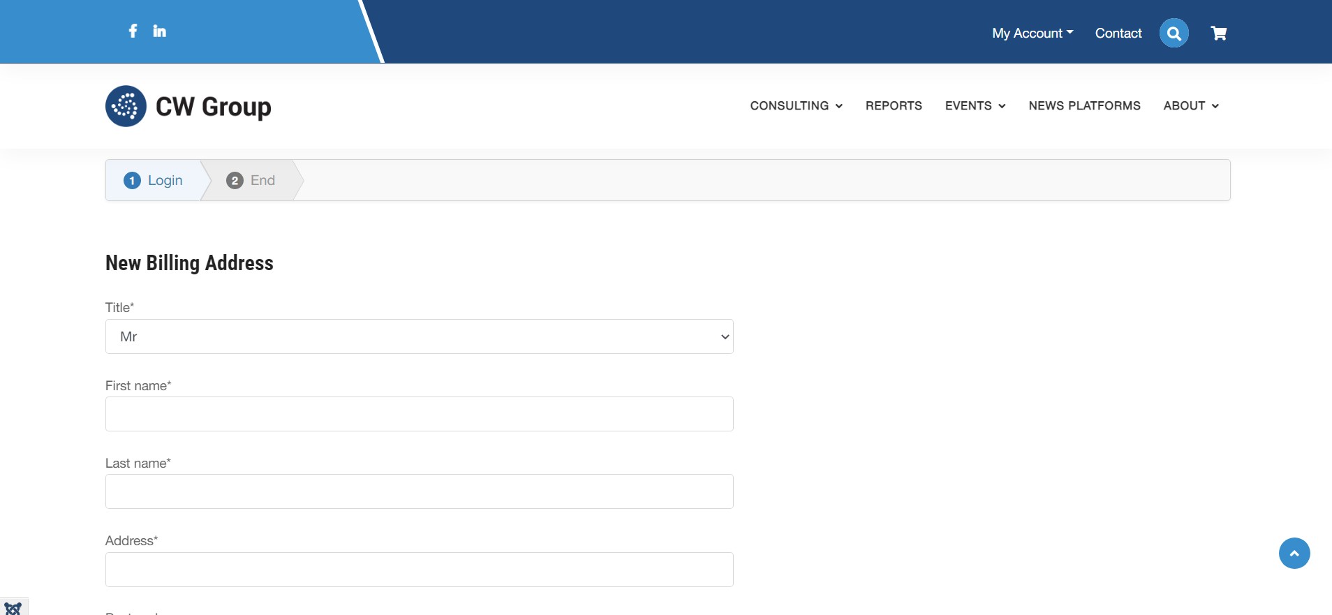

  • Posts: 8
3 years 10 months ago #343590
1. Clicked into any product on the CW's site catalogue (chose a random one from Reports), added to cart.
2. Clicked proceed to checkout and was directed to this page: cwdev.alteweek.com/cw-group-report/checkout
3. Wrote all the data for the user and clicked on the button on the end of it that says 'OK'.
4. It immediately updated the Billing address and Shipping address to a blank selected space, still the same URL as above.
Last edit: 3 years 10 months ago by robbed. Reason: add screenshot
