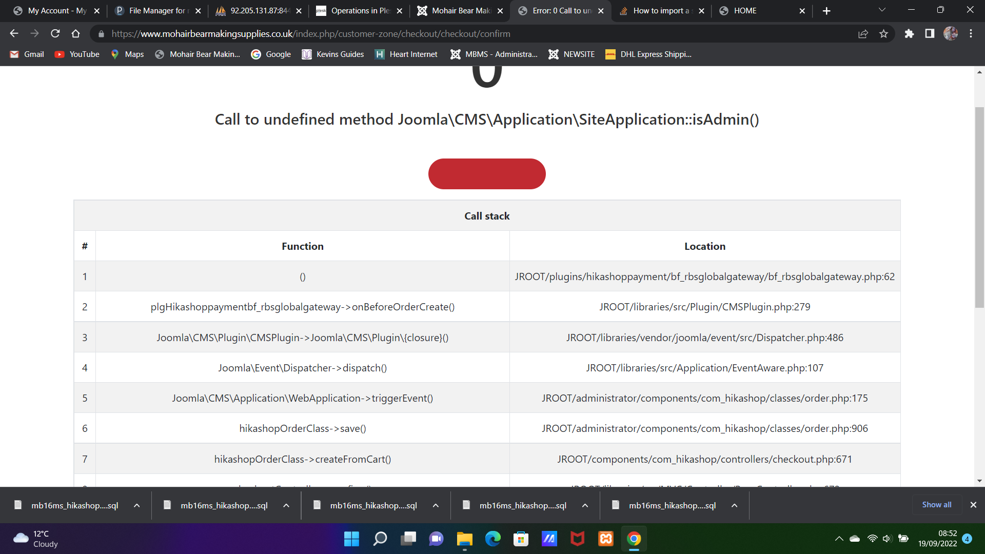

Hi, Getting the below error when trying to checkout with Joomla 4?
  • Posts: 86027
  • Thank you received: 14171
3 years 10 months ago #344838
This error points at the bf_rbsglobalgateway plugin. This plugin is no longer included in HikaShop.
You need to download the install package of the latest version on its page and install it on your website:
www.hikashop.com/marketplace/product/123...-global-gateway.html
The following user(s) said Thank You: mohairbears

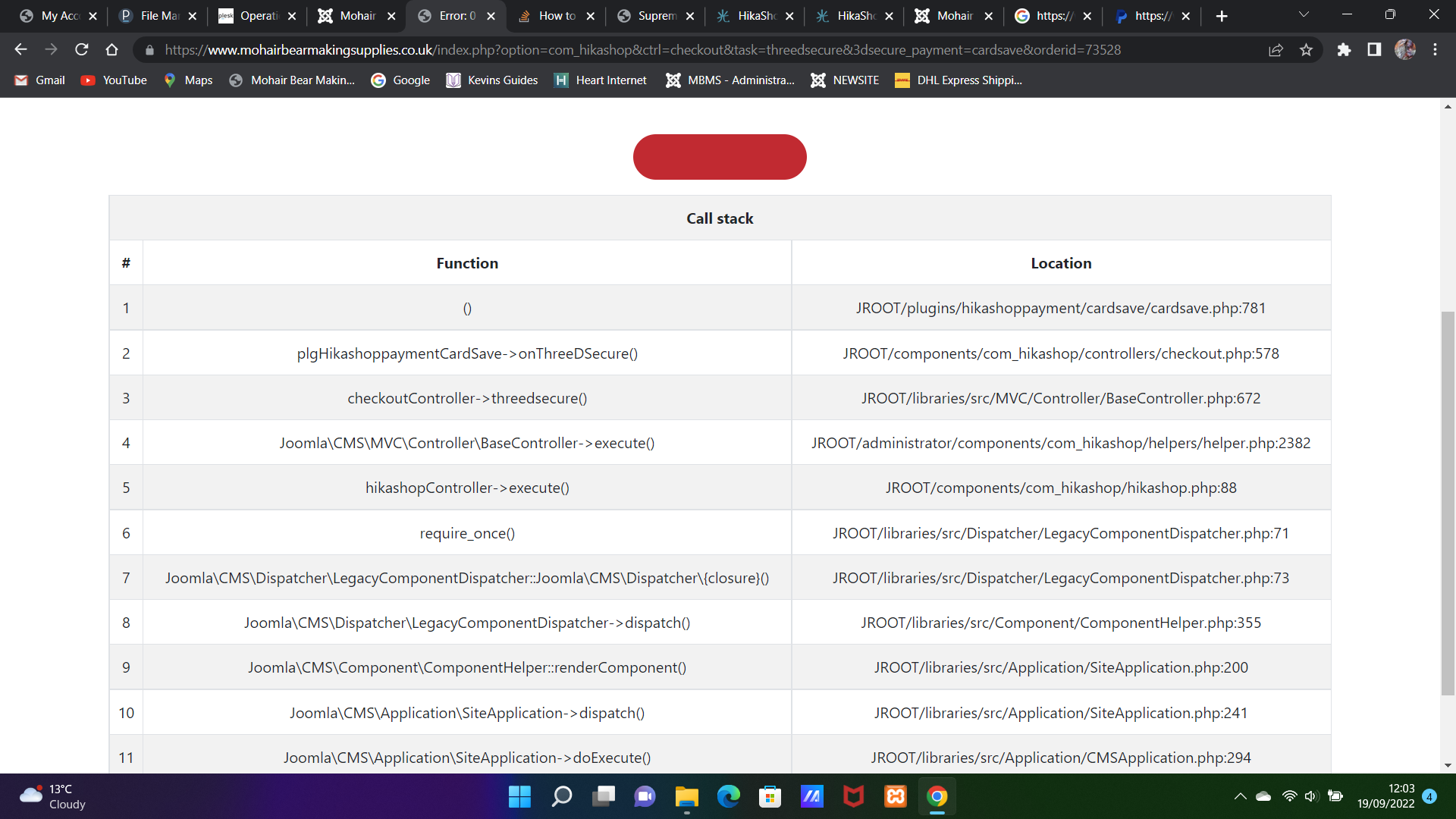

Hi, Your answer worked with the Paypal plugin and bank transfer but I still get the attached error with the Cardsave plugin and cannot find an update for that one?
  • Posts: 86027
3 years 10 months ago #344848
This plugin is included in HikaShop.
I believe this issue is linked to your PHP version, not Joomla and is caused by a typo in the code of the plugin.
Change the line:
$ohistory->data = ob_get_clean();
to:
$history->data = ob_get_clean();
in the file plugins/hikashoppayment/cardsave/cardsave.php and it should fix the problem.
We'll include the fix in the next version of HikaShop.

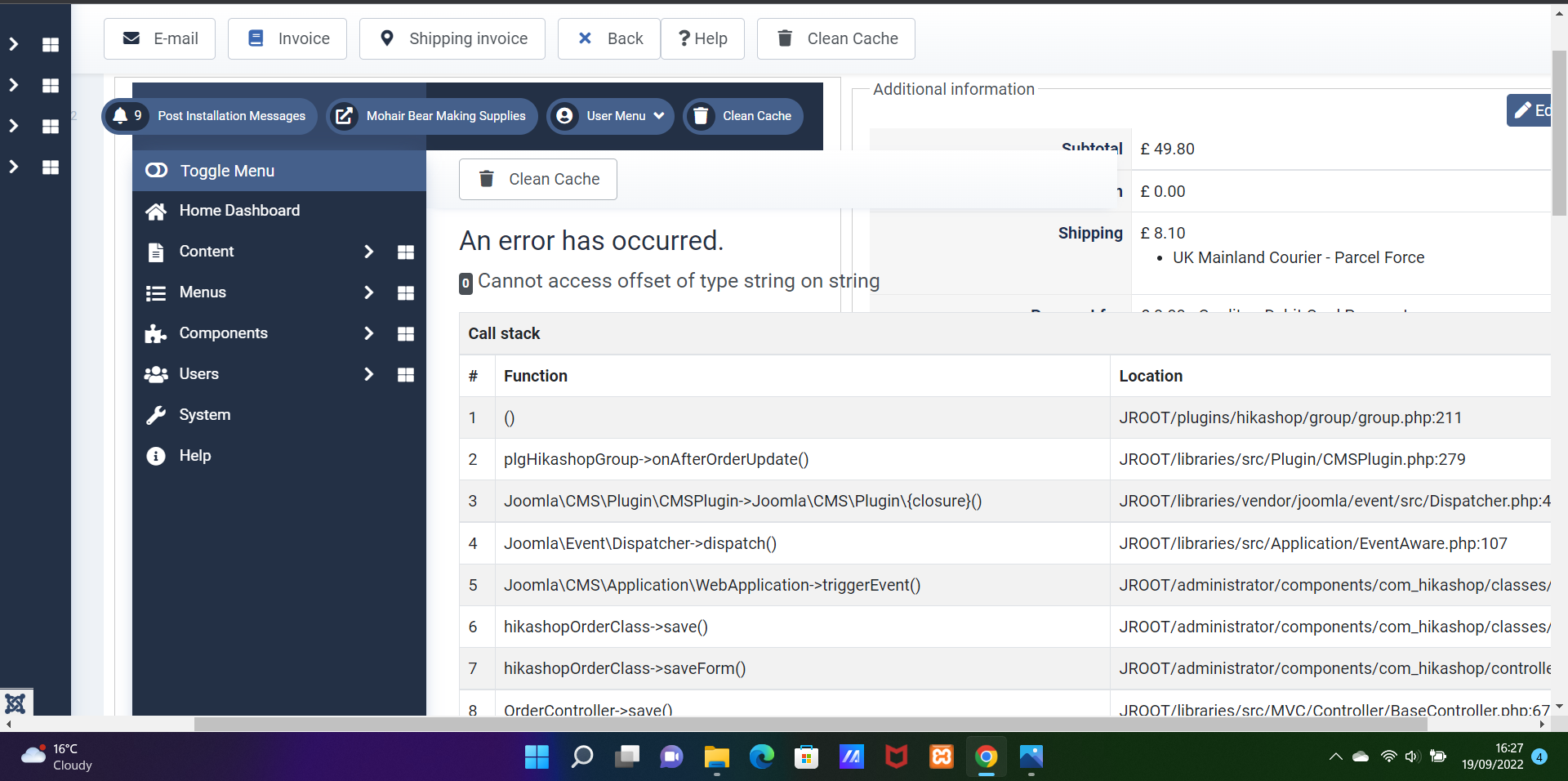

Hi Sorry another issue. Group error preventing order confirmed emails to customers on J4 (see attached) I have looked in the forum and found a group plugin, I have disabled this and emails are now being sent. My group after order has always been sent to None and no issues with J3.
Rgds
  • Posts: 86027
3 years 10 months ago #344858
Thank you for your feedback. This can happen if you have configured the "user group after purchase" setting in at least one product of the order being confirmed and the plugin is enabled without its settings having being saved once in the past on PHP8.
We'll add a check on this to avoid the error.
  • Posts: 589
  • Thank you received: 12
3 years 10 months ago #344873
Hi, I did check for that as there was only 3 items on the order, they were all set to 'none'
Rgds
  • Posts: 86027
3 years 10 months ago #344883
Yes, but still if the user group was deleted after it was selected in a product and you didn't save again the product after that, the user id would still be listed in the database, while the option wouldn't be able to display it being selected as the corresponding user group doesn't exist, but the plugin would still see it as present.
So my fix prevents this from being a problem.
