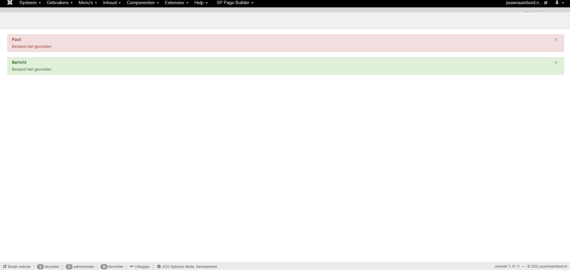

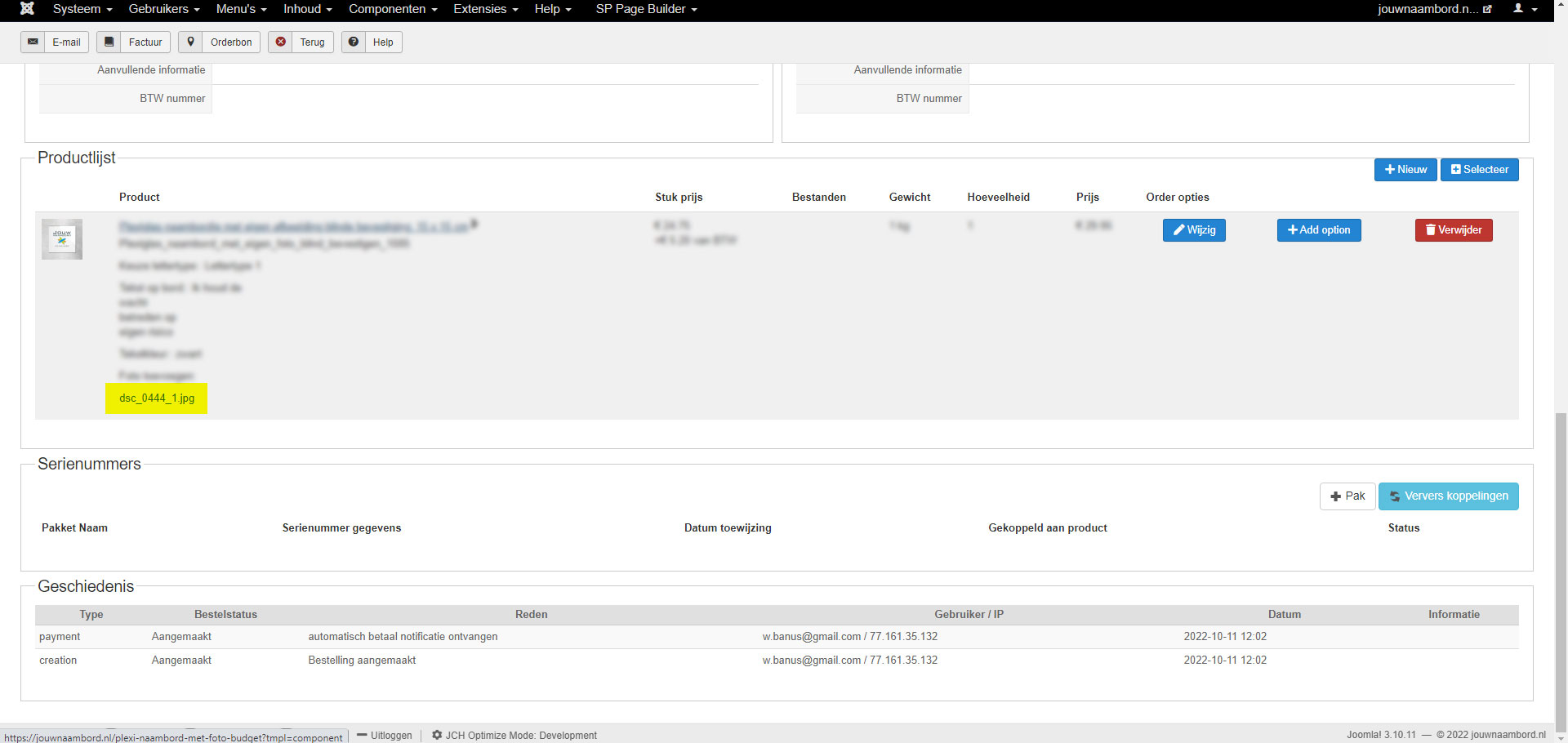

I upgraded to version 4.6.2, but the Ajax file field seems to upload jpg files, but in the backend I get a message "file not found". The file is shown in the backend order, but is not uploaded to the media/safe upload folder.

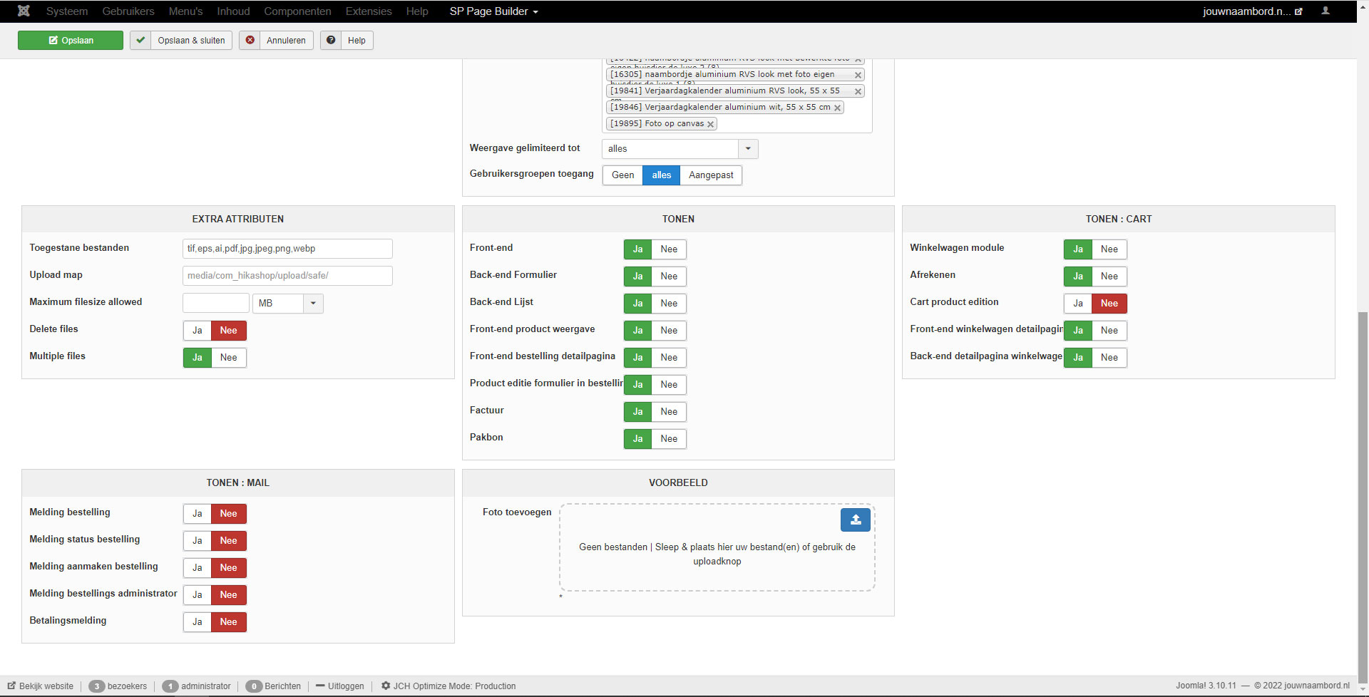

I went to the custom field. There's an option "Delete files". I have two ajax upload fields (1 for private customers and one for bussiness). At 1 of these custom fileds the option is activated on the second it is not.
I did a new test with Hika 4.6.2 and it seems that the image is deleted after upload on the product page. The same test with the "Delete files" field deactivated the image remains as it should.

The version is already 4.6.2 now, the field works fine with the "Delete files" deactivated. The screenshot is in the attachement.

Could you also provide a screenshot of the settings at the top of that page ?
Can you confirm that you still have the issue if you activate back that "delete files" setting ?

I didn't try to re-activate the delete files option. But I did, and it seems the issue is solved.
