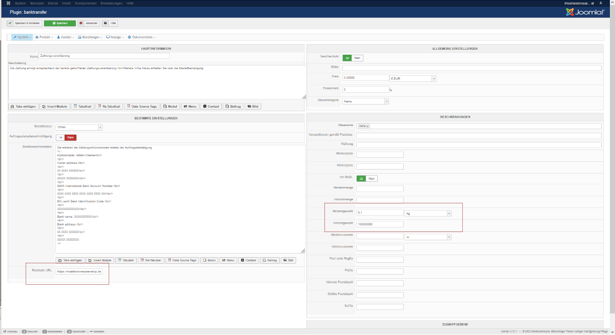

Thank you for the feedback.
The banktransfer_end.php file is present.
In my shop I created an extra payment method and deactivated all others. Since we operate a B2B shop, the various payment methods are stored in our main system, so the customer only receives information that the order will be carried out in accordance with the agreement made so far.
The return URL is stored in the only payment method I have created, which unfortunately is not used after pressing the purchase button.
Greetings from Christian

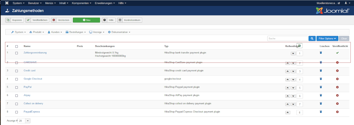

Sorry I described that wrong.
I selected the payment method "HikaShop bank transfer payment plugin" and indicated there that it will be used from 0.1 kg. All other payment methods have been disabled.
The forwarding is specified in this payment method.
  • Posts: 86027
  • Thank you received: 14171
3 years 7 months ago #347589
Please make sure you have the "payment" view in the "Checkout workflow" of the HikaShop configuration. And you can remove the restrictions on the weight in the payment method, they won't help, just create potential problems (for example if you forget to set a weight in a product, since it would mean no one would be able to purchase the product as the total weight of the cart would be 0 and thus the payment method wouldn't be available).
