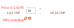

If I order an item with price of 1,62 per item and I order 10 items, total price of 16,16 is shown instead of 16,20.
Here is screenshot:
It would be great if you could check this.
Thanks a lot.

nicolas wrote: That's because you have the "round prices during calculations" setting turned off and thus the calculations are made without rounding and the rounding is only done during the display of the interface.
Now I see what causes the confusion. The price for single article is 1,6155 but even rounding is off, it still is shown rounded to 1,62:
Why is it rounded even if rounding is off?
This is very confusing. Users will calculate 1,62 x 10 = 16,20 but 16.16 is shown (which is correct total not rounded).

The rounding is not off.
Rounding 1.6155 to 2 decimals will commonly result in 1.62 : www.mathsisfun.com/rounding-numbers.html
And 1.6155 * 10 = 16.155 which is then rounded to 16.16
As I said, if you want the calculations to appear more correct to you, you can activate the "round prices during calculations" setting in the HikaShop configuration. When you do, you'll see the total will be 16.20 like you expect. It's indeed less confusing for the user, but it's less accurate (since you entered a price of 1.6155 in your product and you purchase 10 of them, the exact amount is 16.155, so 16.16 is a more accurate result than 16.20 for an initial price of 1.6155).
