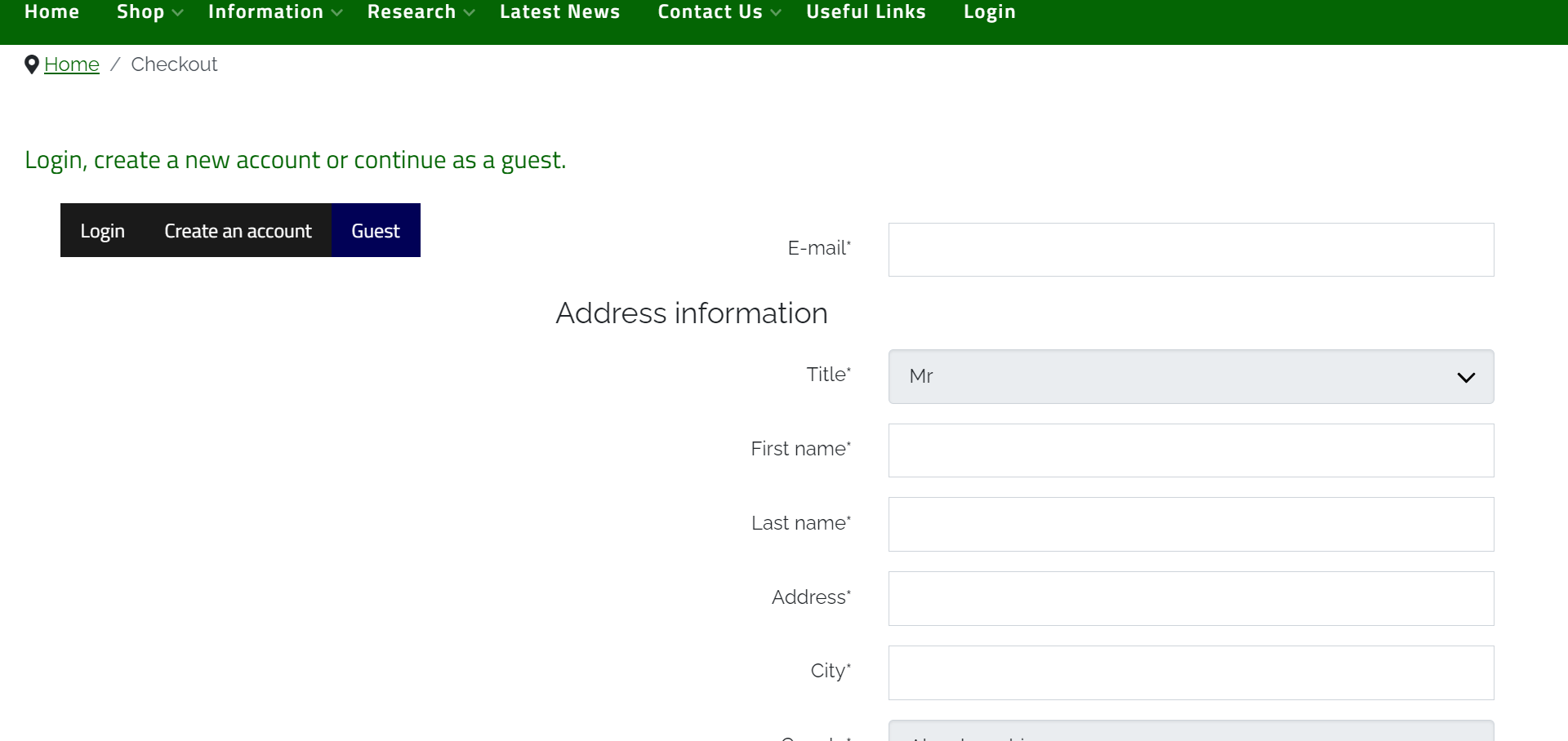

Hi Nicolas
thanks for the reply. Possibly me adding the code has detracted from the issue I have.

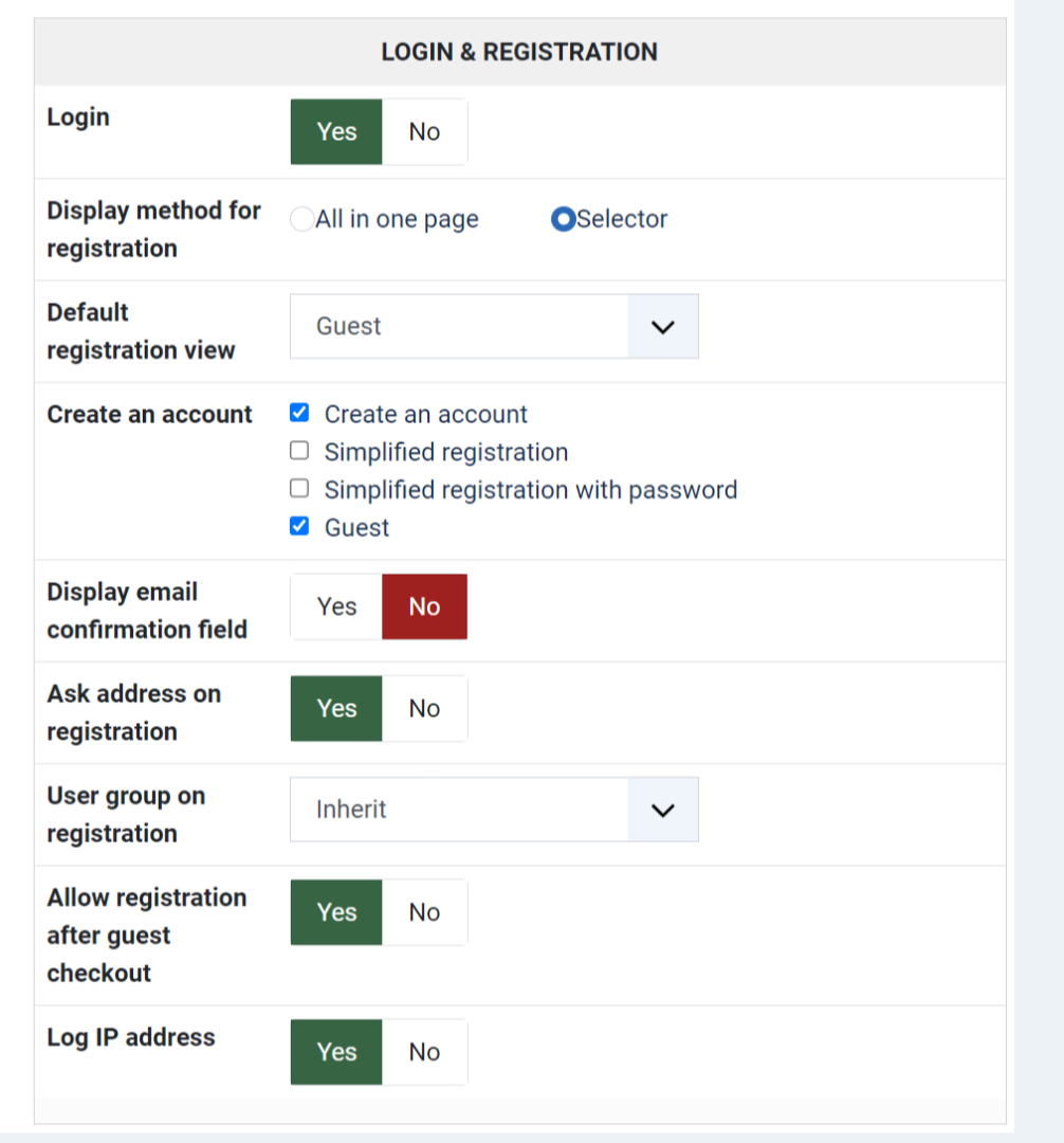

When going to the checkout you are presented with the form. If I try to click login or create an account the options are not provided.
I have attached a screenshot of this and also the settings in the admin.

2 years 11 months ago #352711
My bad, I had indeed missed that.
The issue comes from a javascript error in the jquery of the template :
i.imgur.com/hvX9pBB.png
This prevents HikaShop from being able to initialize the selector there.
I think it might be a jquery conflict (several jquery files are loaded at the same time on the page). Try using the extension jquery easy to prevent the conflict:
extensions.joomla.org/extension/jquery-easy/
You can add the errors here after the issue with the selector is solved in order to not be confused again when we come back here.
