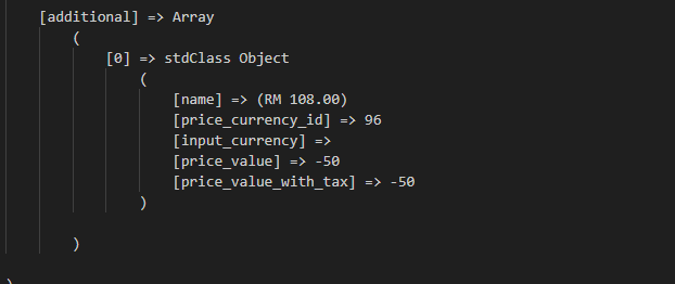

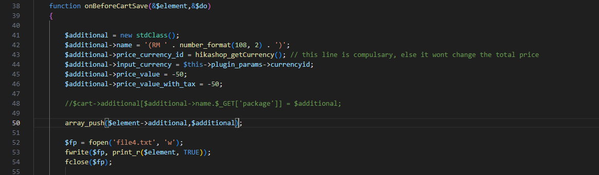

May I know Is there any way to save the additional parameter in cart but not override?
I would like to append additional parameter on every add to cart.

If you check the save function of class.cart, you can see that the data in $element->additional is moved to $element->cart_params->additional before the event onBeforeCartSave is called. And after the event, the content of $element->cart_params is json_encode
So you can do it in onBeforeCartSave, but you need to add it to $element->cart_params->additional yourself so that it is taken into account.

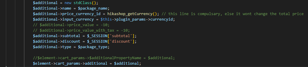

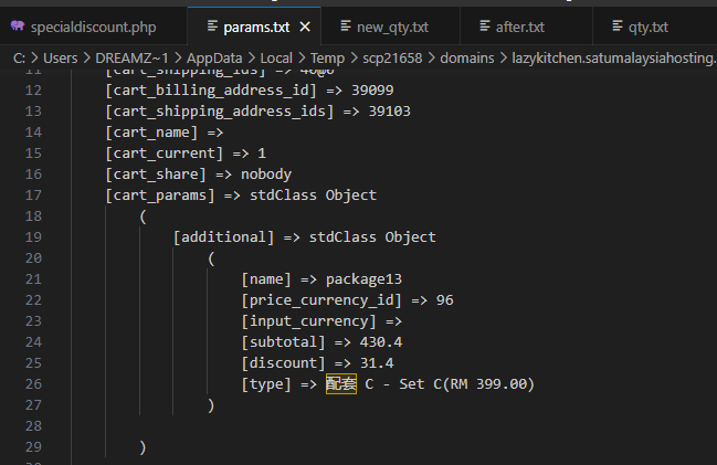

I tried use $element->cart_params->additional = $additional; but the discount not loaded also.

Ah yes. You need to move the additional from $element->cart_params->additional to $element->additional yourself when the cart is being loaded. For example with the event onAfterCartLoad(&$element, &$options)
