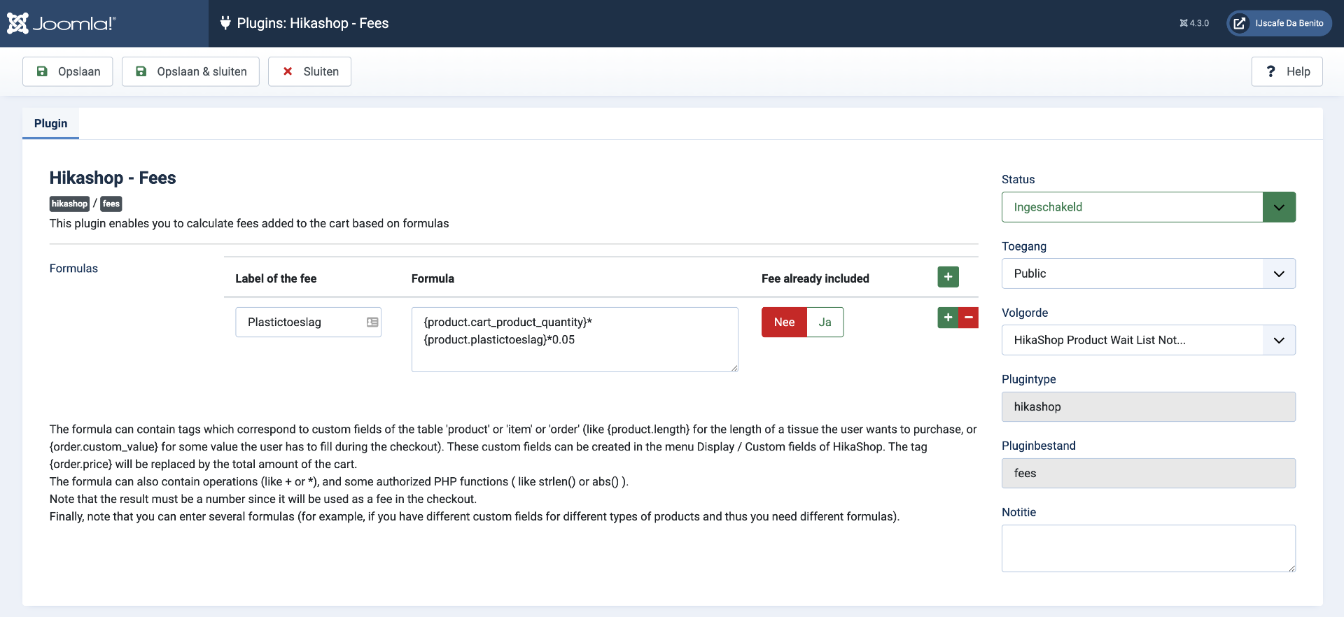

I think that what you want to use is this:
www.hikashop.com/marketplace/product/279-cart-fee.html

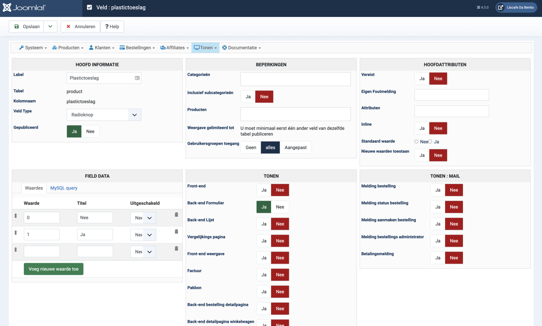

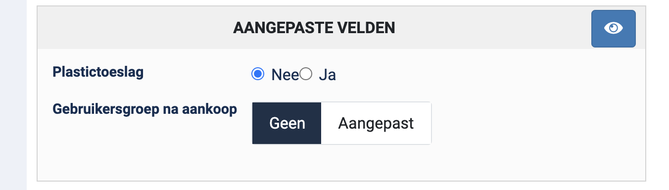

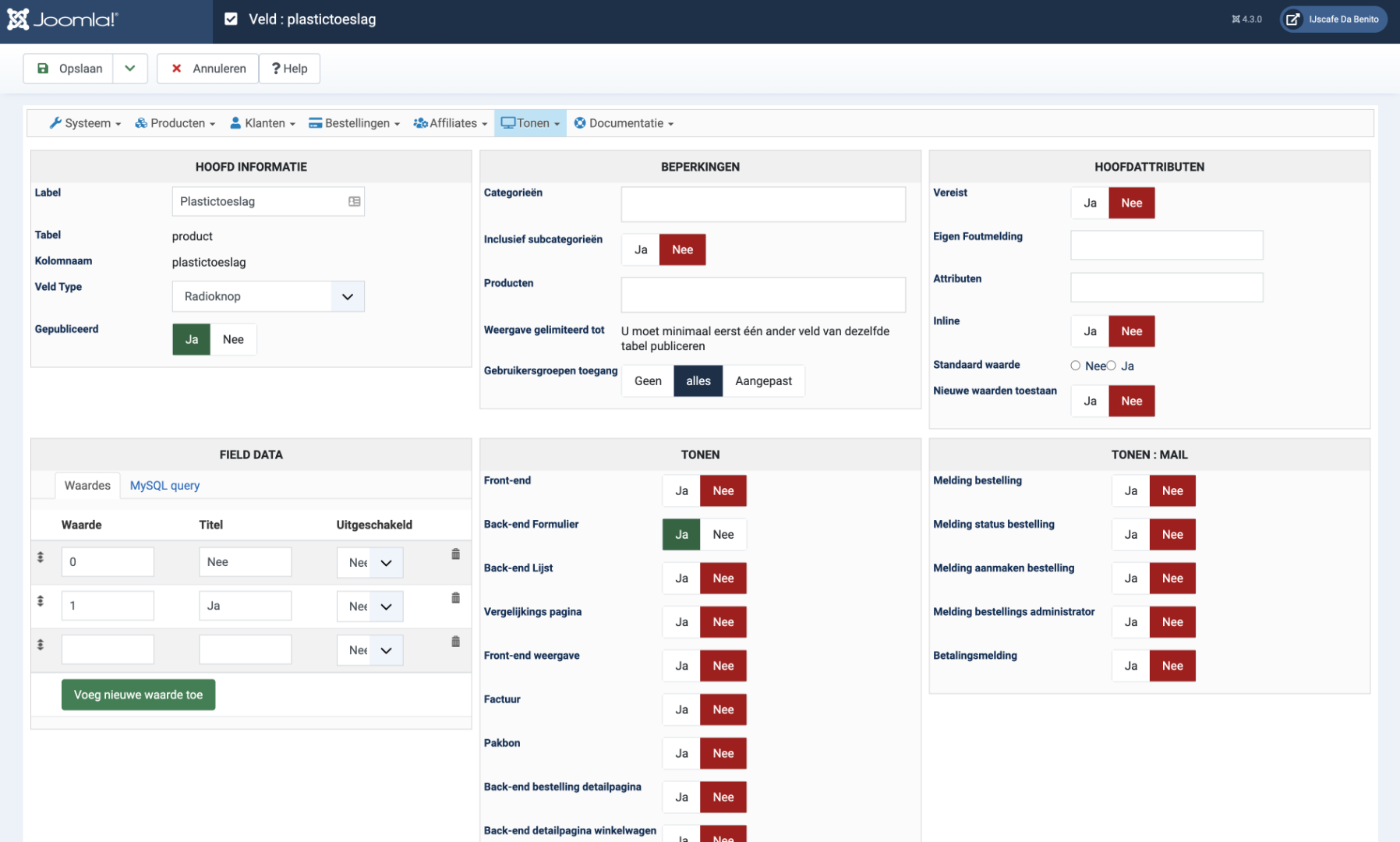

First, you create a custom field of the table "product" via the menu Display>Views. I would recommend a radio field with two values:
0 with the title No, and 1 with the title Yes.

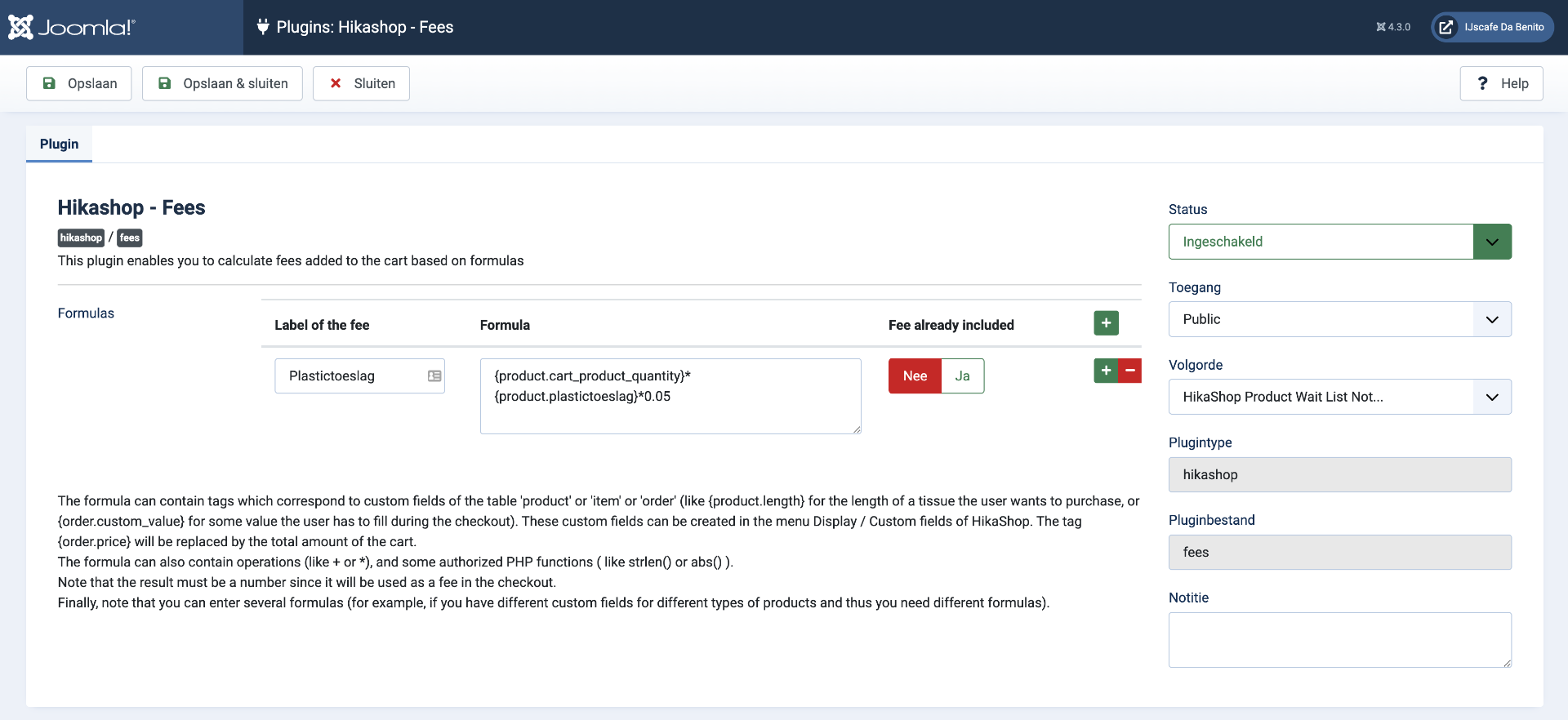

Then, in the formula of the plugin, you can write {product.cart_product_quantity}*{product.xxx}*0.05
where xxx is the column name of your custom product field, and with the "fee already included" setting turned off.
That way, in each product, you'll have a yes/no field to select if it has plastics or not. And on the checkout, the plugin will automatically add an extra fee of 0.05 per product with plastic in it to the total.

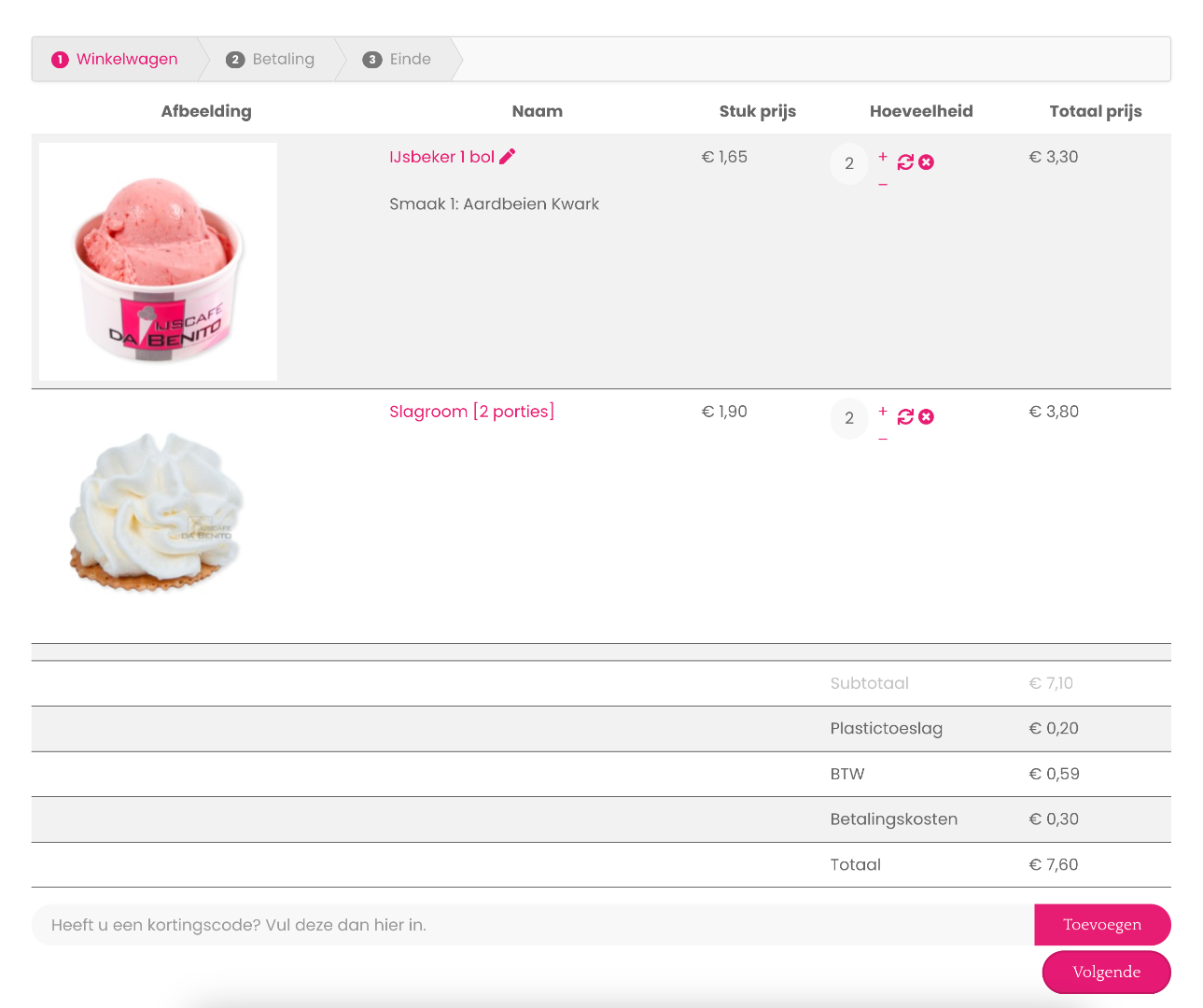

I'm really sorry to have to bother with this once again but it seems there is small issue in the solution.
Everything goes very smooth, until you add a product which hasn't got the extra fee. The cart however is updated with also the €0,05 for the products which haven't got the fee.
Please also take a look at the attachments.

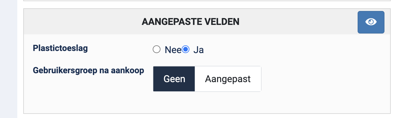

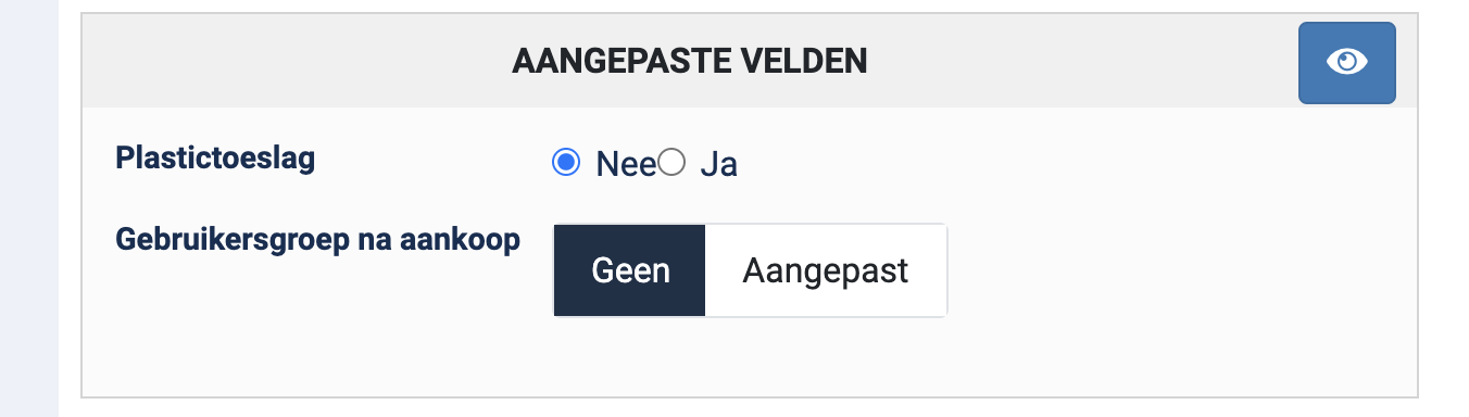

File 1: Screenshot Custom field
File 2: Screenshot Plugin Fees
File 3: Product with added fee [ db22.mitzz.nl/webshop/bekers/product/da-...sbeker-1-bol-1-smaak ]
File 4: Product without added fee [ db22.mitzz.nl/webshop/slagroom-koek-dive...t/slagroom-2-porties ]

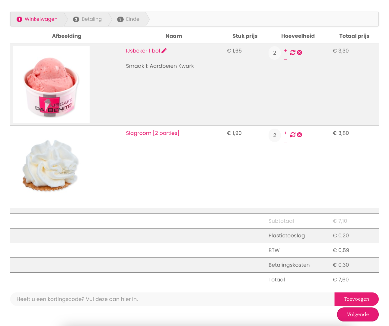

File 5: Screenshot cart with both products

2 years 10 months ago #353606
I would need screenshots of all what you did. You must have missed something somewhere.
For example, this:
i.imgur.com/6pud4e1.png
I assume the first product doesn't need the fee, only the second one.
When I have only the first one in the cart, there is no fee, regardless of the quantity.
When I have only the second one in the cart, there is a fee and it's 10 cents per quantity of that product.
And if I have both products in the cart, only the quantity of the second one is taken into account for the fee.
So, to me, it looks like it's working fine, but it's just that you set a fee of 0.1 instead of 0.05 in the formula in the plugin, or you changed the "yes" value from 1 to 2 in the custom field settings. But I'm just guessing based on the behavior.

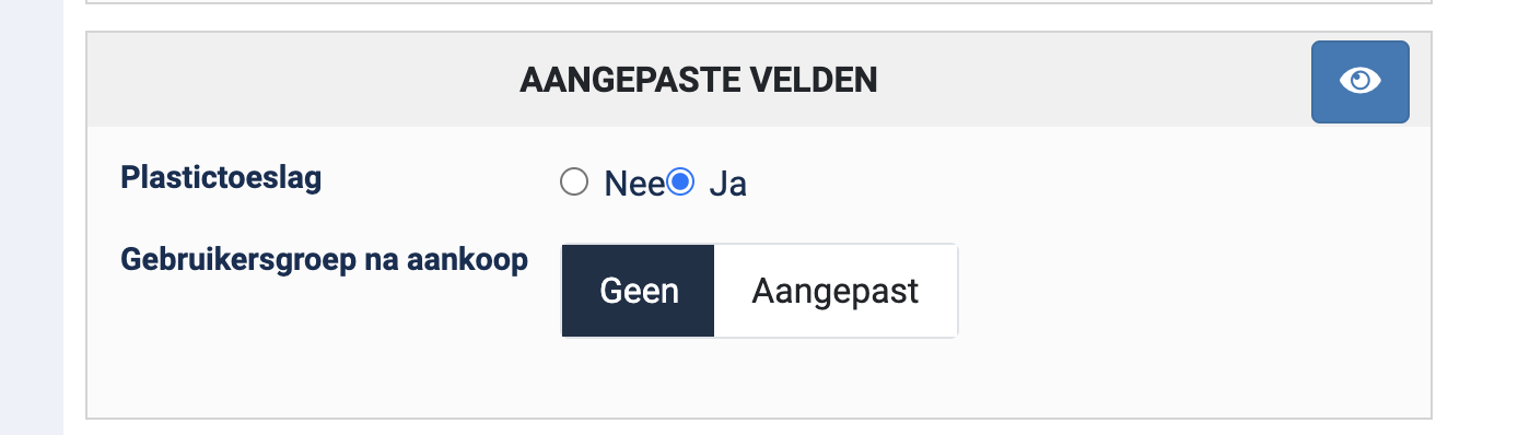

2 years 10 months ago #353754
I left this 'on the shelf' for a few days, just to set my mind to zero and have a fresh point of view. That helped, big time. I'm ashamed to let you know that I found what I've been doing wrong... in the product I 'forgot' to select the Yes option. :S Now that I've done that, everything is working just fine.
As I mentioned before: I'm really very sorry to have bothered you with this again. Next time I hope all brain signals will work together again, like they should have done this time. Sorry...
