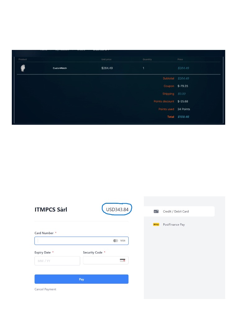

we noticed that the amount of the order transmitted to credit cards is not accurate when coupon or points plugin are used. I prepared several examples below. Please note that the calculation made by Hikashop is always accurate in the total amount. It is just a different amount that is transmitted for payment to credit cards.
Here below a real order cancelled by the customer:
In this example the total transmitted to CC is in fact the cost of the product + amount of coupon (30%)
Used points not considered (and despite the fact that the coupon amount is added...)

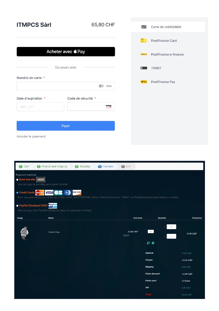

In the example below we have the amount of the product + VAT.
Used points in reduction are not considered

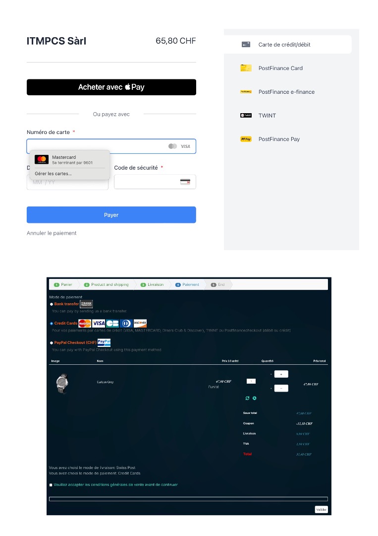

In the next example, the amount transmitted is almost product + coupon + VAT (almost, 10 cents difference)

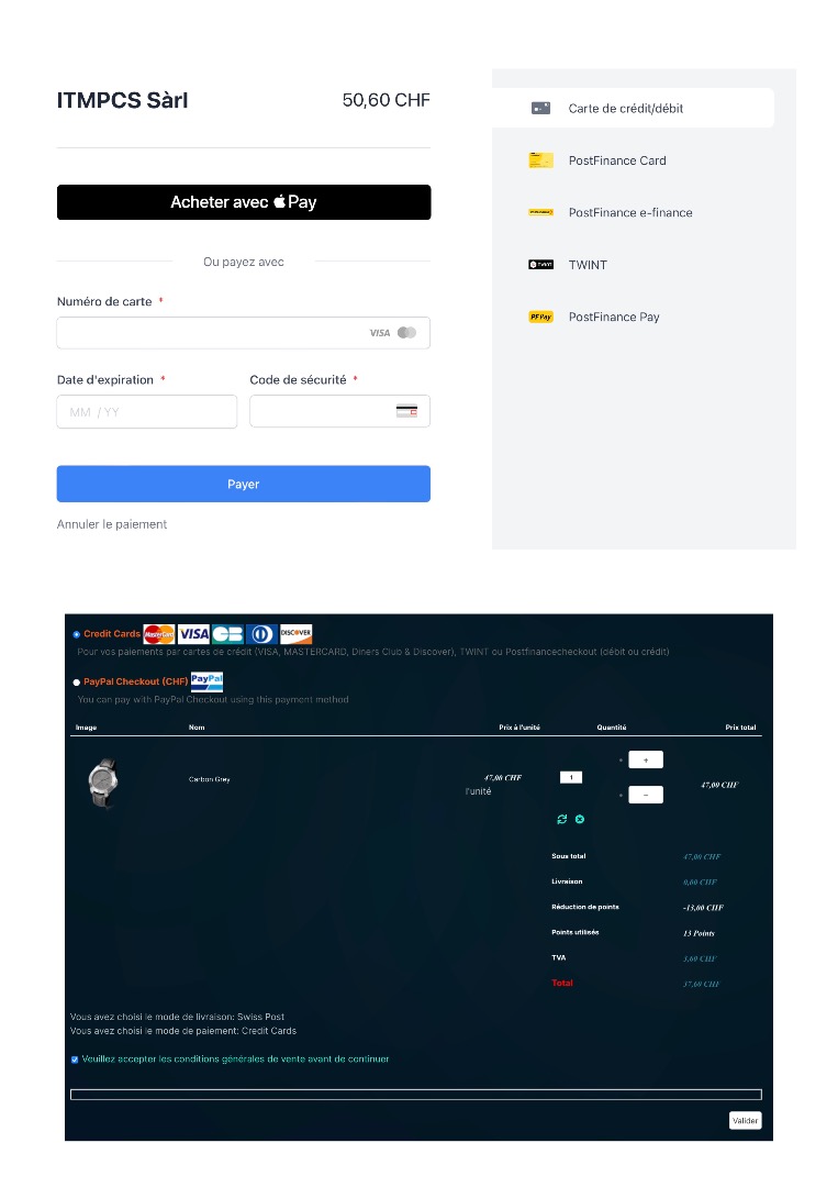

And in the last, I used only coupon without points. Same behaviour are previous example, same amount
