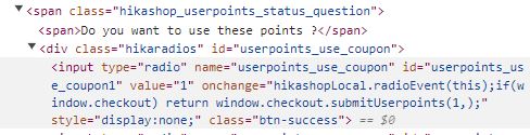

-- Error-message(debug-mod must be tuned on) -- : Not working switch apply points
Not working switch apply points (Ajax request)
if in file: /plugins/hikashop/userpoints/userpoints.php
in line where: public function onCheckoutStepDisplay($layoutName, &$html, &$view, $pos=null, $options=null)
remove null in option $pos that is:
public function onCheckoutStepDisplay($layoutName, &$html, &$view, $pos, $options=null)
then all working

I parsed the html and found that there is no second parameter in submitUserpoints
Afterwards I found a solution.
Ok now:
I think this is a problem with PHP, assigns a default value to a non-null argument: youtu.be/rJt7JeUim3w
