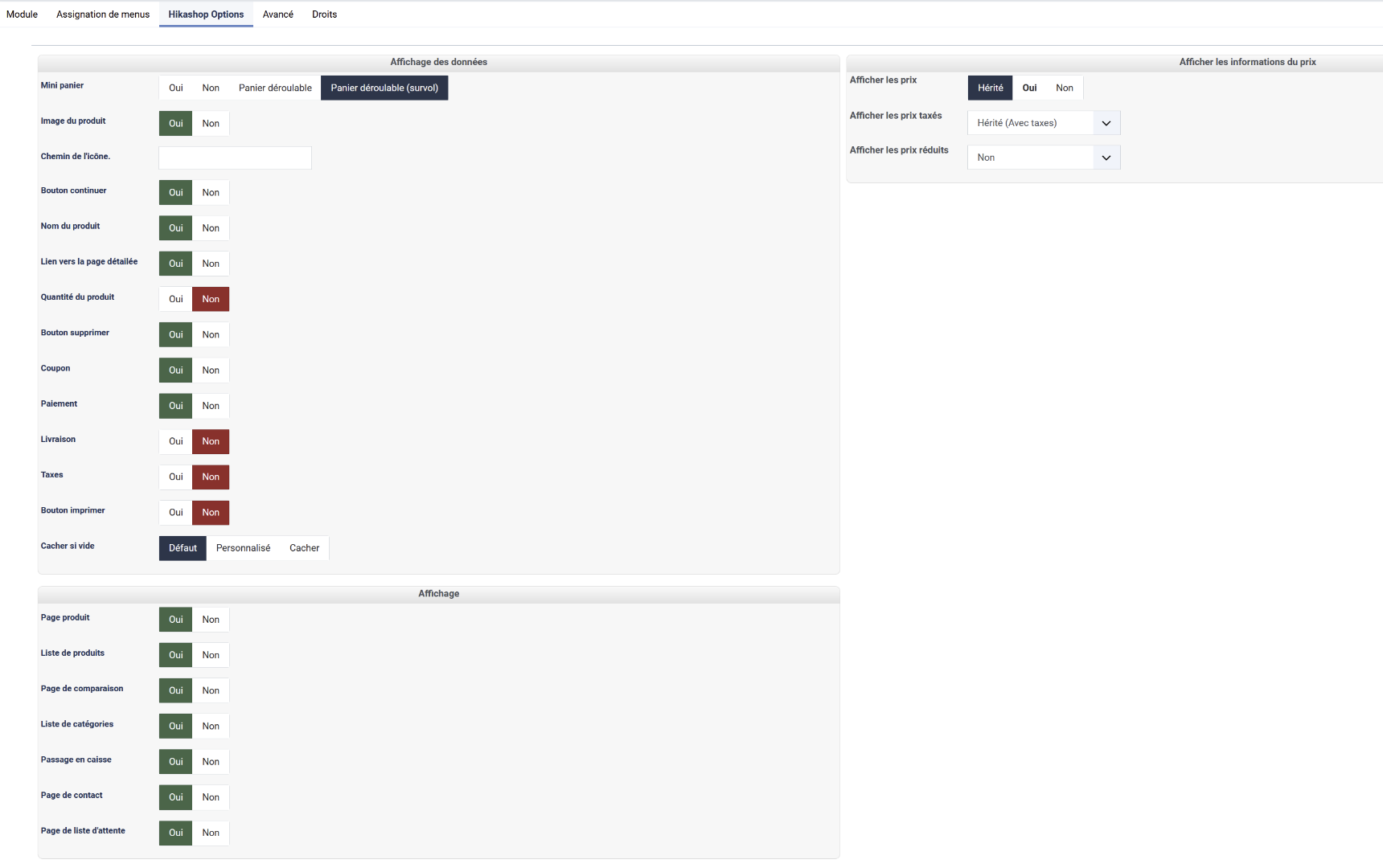

Could you provide a screenshot of the settings of your cart module ? I'm thinking that the coupon value missing from the cart module display is a specific combination of settings leading to this.

I have attached a screenshot of my hikashop cart module options as requested.
