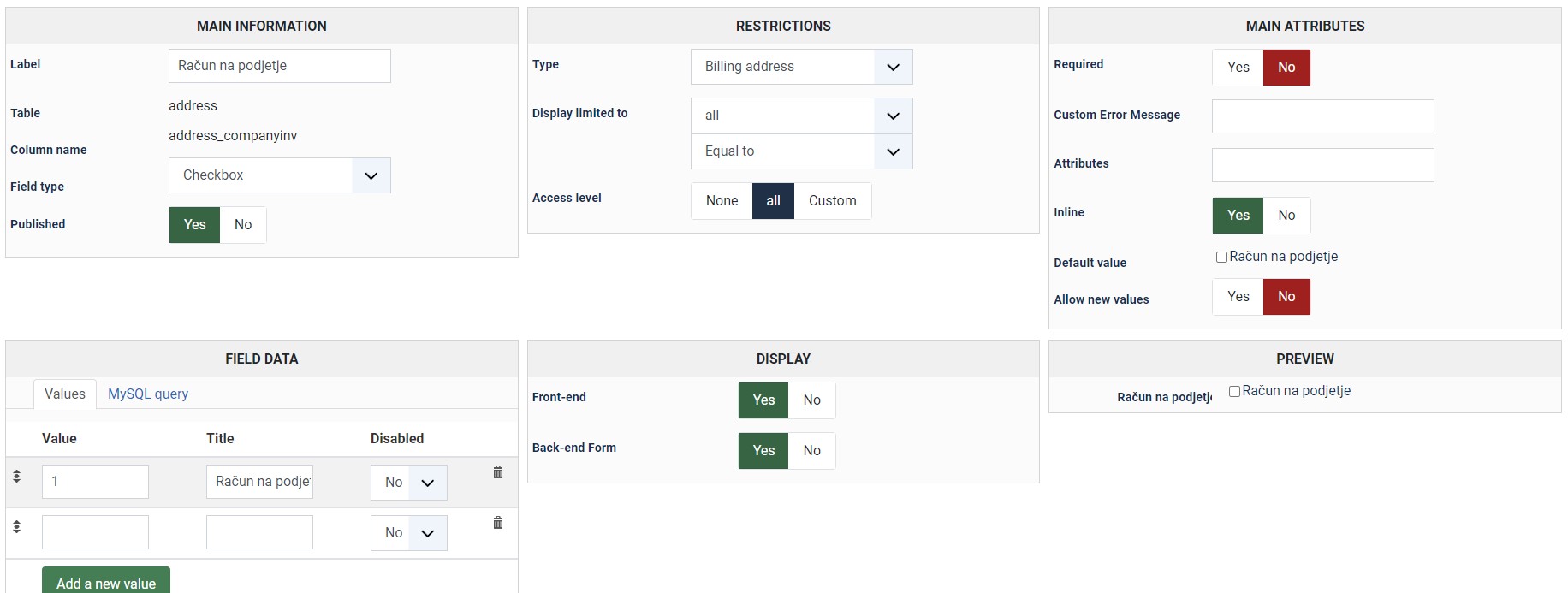

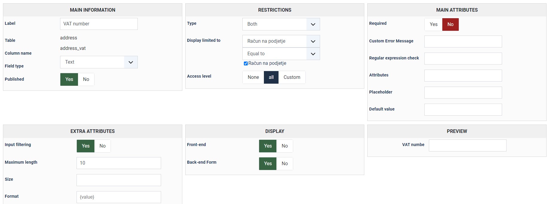

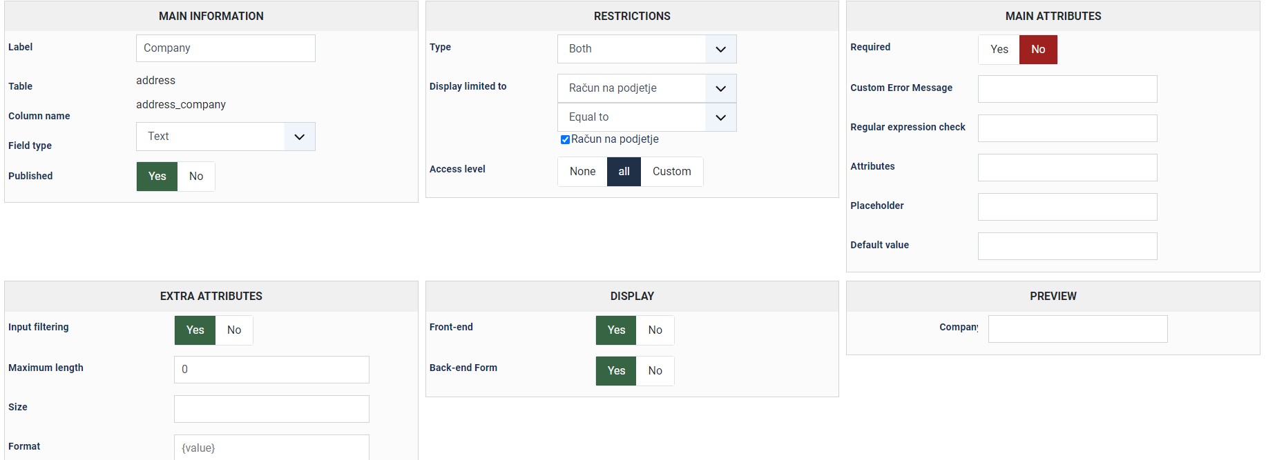

On checkout I have 2 fields in address (company and vat) limited with custom field type select. When customer selects "Order as company", fields company and vat shows.
Before update all ok.
After update, company shows but vat is allways visible.

I understand why it wouldn't work for both after the update. But it's strange that it wouldn't work for only one field.
Could you provide a screenshot of the settings of both fields ?

1 year 10 months ago #362010
Screens
