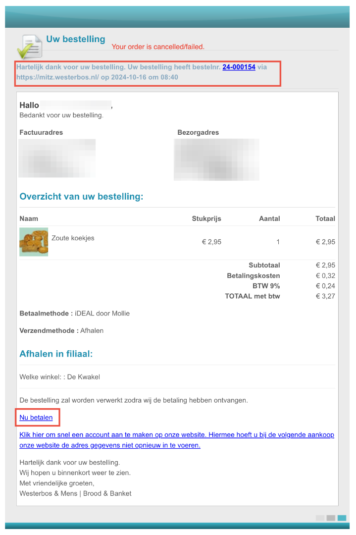

I've got some issues, I hope you can help me with this. The shop is still in testing mode but needs to go live this week.
  1. When an order has status cancelled or failed, I would like to have that where "Thank you for your order..." is, in the mail to the customer. Right now only the link below "Nu betalen/Pay now" states this is not a completed order. Where and/or how can I adjust this please?

1. You can edit the emails via the menu System>Emails. The pay now link is added to the {VAR:ORDER_SUMMARY} tag. So you can move it near the top in the email's HTML area.

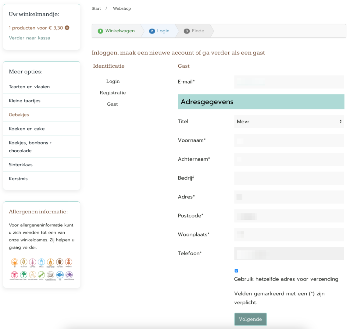

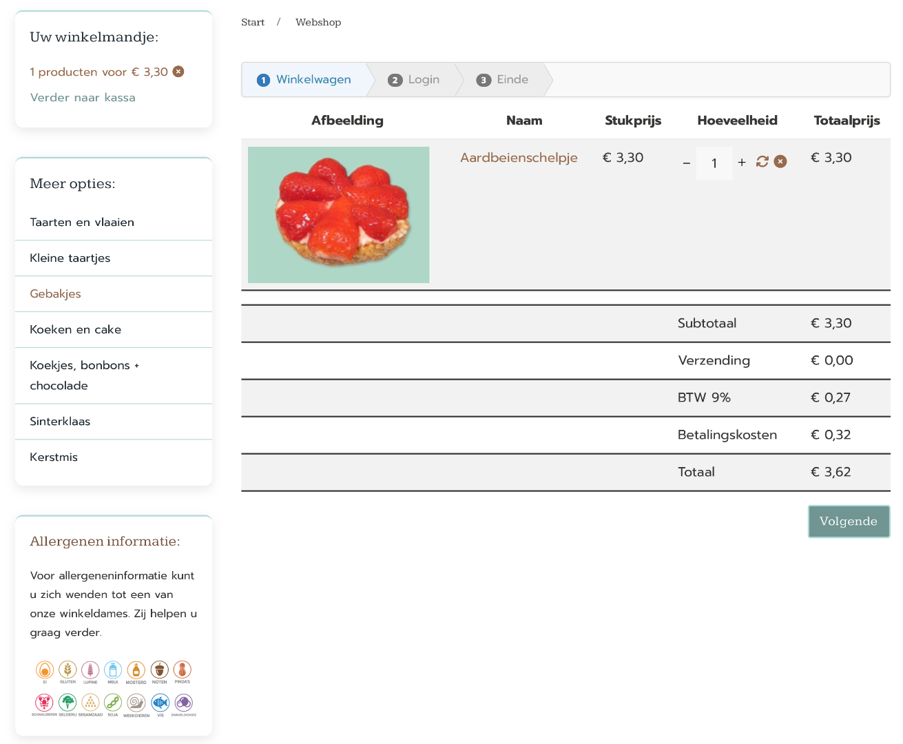

When in the shopping cart, the check-out is being divided into 3 steps:
  • Shopping cart, pushing the 'Next' button for the second step
  • Login, mail/address and so on, and the 'Next' button
  • Paying

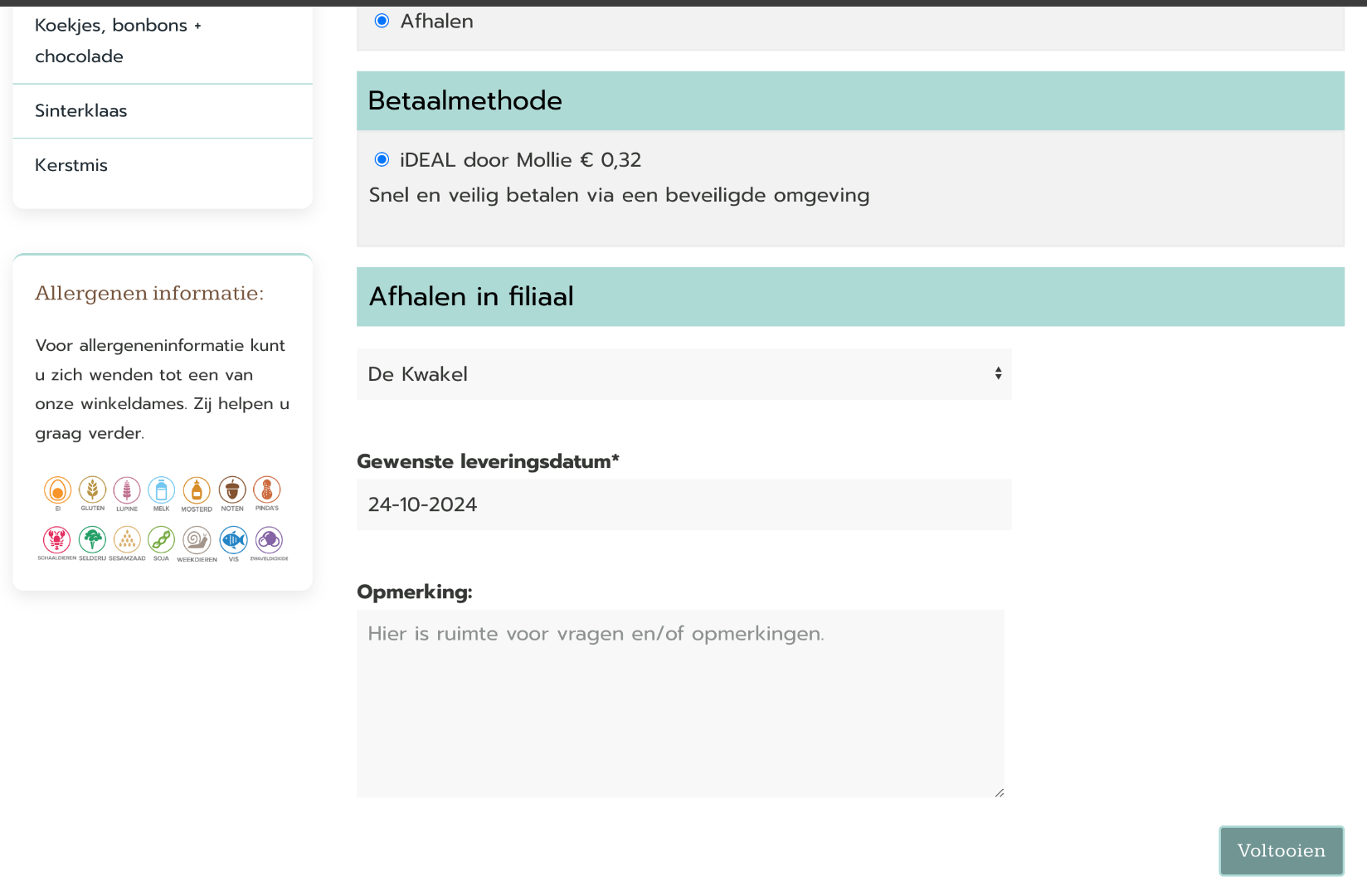

When hitting the Next button in step 2 [after filling in the name/address], the screen scrolls downwards, which is very confusing for the customer. All information regarding paying/delivery is now pushed above the view. Please see attached examples.
Is there a way to prevent the login screen to scroll upwards?
Thank you very much again for your help and time...!

1 year 8 months ago #364409
What you can do is to turn off the "Show submit button" setting of the "Login" view in your Checkout workflow.
This way, the first "next" button will be removed, and the user will have to click on the one at the end.
Another solution would be to move the payment/shipping/fields on a step between the login/address and the last step.
